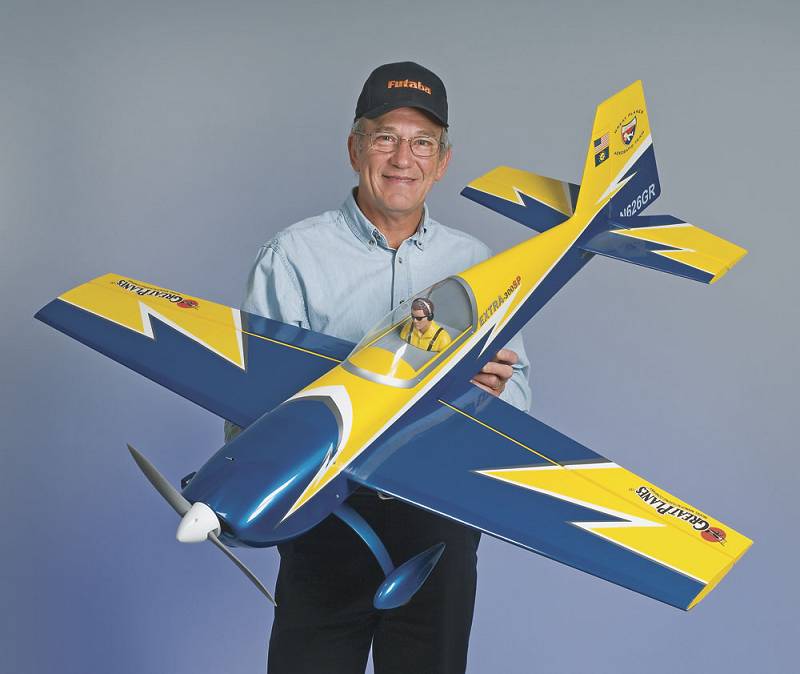

Default new great plane extra 300sp
http://www.greatplanes.com/performan.../gpma1022.html
http://www3.towerhobbies.com/cgi-bin...&I=LXVVG4&P=SM
Wingspan: 55 in (1395 mm)
Wing Area: 590 in² (38.1 dm²)
Weight: 5.5-6.5 lb (2495-2950 g)
Wing Loading: 21-25 oz/in² (65-77g/dm²)
Length: 53 in (1345 mm)
Engine Requirements: 4-5 channel radio w/4-5 servos; 2-stroke .46-.55 or 4-stroke .52-.81 engine; OR
RimFireâ„¢ .80 out-runner brushless motor, 60A brushless ESC & (2) 11.1V 3200mAh LiPo battery
i was thinking about using a 46FX i have (no 3D, loops rolls, inverted) how would it do?

Default RE: new great plane extra 300sp
Well it may be on the low side for power but it will fly it. I always end up with the higher end of the motor spectrum they recommend and find I could have went bigger.
The .46 will likely be just fine if you aren't planning on any hardcore 3D stuff. I ordered a YS-63 for mine.
