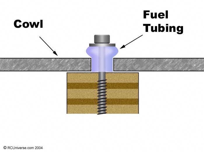

I have goldberg edge 540 and I'm trying to find a scheme to mount the cowl so vibration is reduced. I have always had problems trying to keep the holes in the cowl from enlarging from vibration in my other glow airplanes. I want to do this one right ANY IDEAS?

After you have mounted the cowl, enlarge the holes to 1/4"
Insert a short piece of fuel tubing in each hole and secure with a screw and washer.

The best way is like MinnFlyer pictured! I have mounted nacels and cowels that way for years and not had one shatter out from vibration. Just make the hole large enough to "Squeeze" the fuel tubing in and that way it holds your screws in when you remove the cowl. Also check for prop balance. That can cause MAJOR shakes that you dont want!!

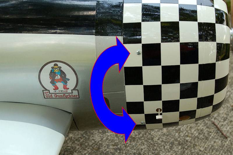

I use round servo grommets. Drill out the hole with a 5/32 bit, squeeze the grommet in. It stays in place in the center of the cowl, and also stands off the cowl from the covering or paint to reduce abrasion. A small washer can be used under the screw to compress the grommet. Here is an example. Most of us will have these grommets laying around.
PS. I wish I could do diagrams like Minnflyer.

Servo grommets work in every material, and on any cowl. Cheap, available, easy to install without the need for glues, will not slip or allow the cowl to slide underneath as fuel tubing can (I used to use this method), reduces the contact of the rough back of a fiberglass cowl to the covering or paint around the fuselage, stays on the cowl when removed and reinstalled, can be painted to match the airframe, indeed, what is not to love.
