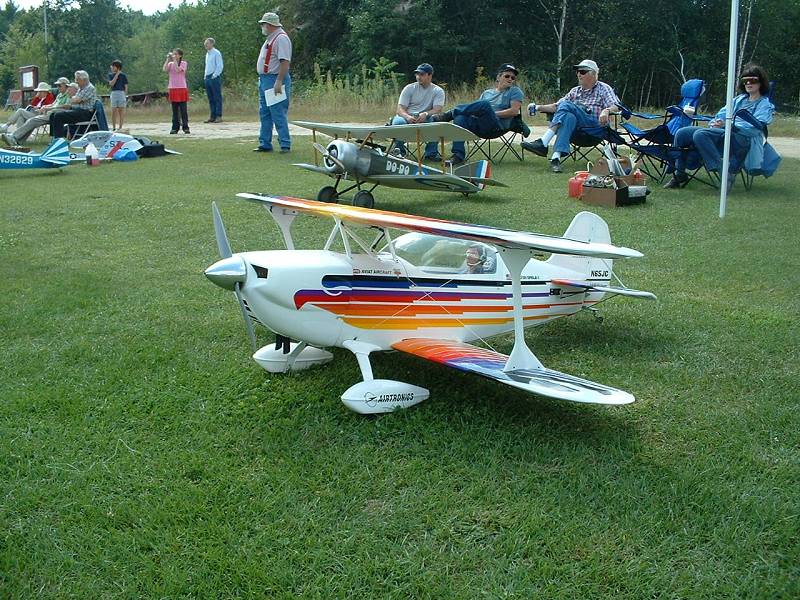

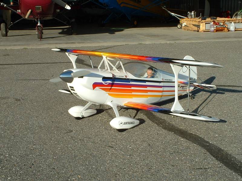

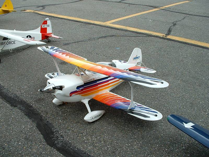

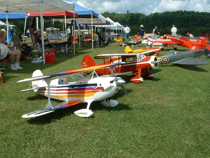

Old 05-01-2009 | 04:09 PM
airportbum's Avatar
Joined: Mar 2008
Posts: 66
From: Millinocket, ME
Default RE: SkyShark Christen Eagle Glow Engine?
I have a 1.80 Saito in mine, but wish that I had a gas engine instead. Saito is way too thirsty. I love the way it flies, but not very economical with this engine. Its going to end up with a gas engine. JC
