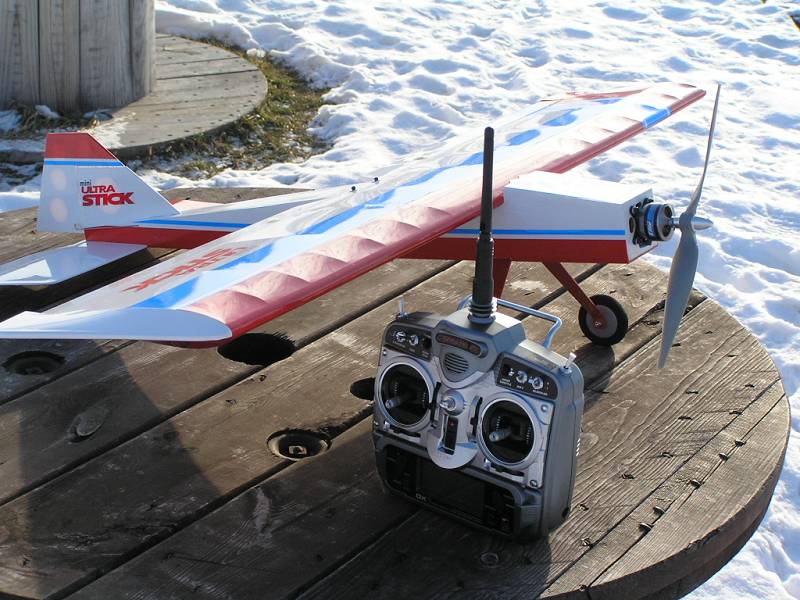

After a season of very sporadic flying, I finally got some serious time in with my "move-up" airplane - the Hangar 9 UltraStick 40. Mine is powered by a Saito .62 (my first experience with 4-strokes).
After trimming it out I started "cutting loose" a bit but noticed a pronounced "howl", especially with the stick cruising at high speed on the downline.
Another club member showed up today with his US120 with another 4-stroke and it too, had it's own distinctive sound.
Love flying the US, it penetrates the wind better than my venerable trainer (Sig LT-40) but slows down for landing just like a trainer.
And, what would be the best prop for this combo? Currently running an APC 12-6. Would a 13-6 be better? 12-7? I'm taching 9800 on the ground with the 12-6 and 15% fuel.

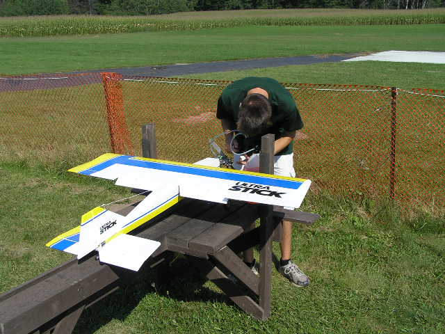

My boy shown here prepping MY Stick. He flies his own Mini UltraStick w/Park 480 and 11-7 prop.

There were so many Ultra Sticks at my first field that I guess it was just a given fact, but yeah....Ultra Sticks sound distinctive for sure. I have no idea why, but yup....they howl.
You might need to prop up to rev-down that motor. Prop selection is really dependent on what you want to do. Do you want more speed (always a common theme with me)? Then go with a 12x7 or an 11x8. Do you want more vertical? Go with a 13x4 or a 12x5 and run it a tiny bit rich.
A lot of people that haven't seen a fast ultra stick don't believe me when I tell them how fast/fun/stable an ultra stick can be when you prop it right and dive at the ground. I had passes over 100mph in my Ultra Stick, inverted, inches off the ground. Once, I landed with a grass stain on the top of my rudder (no joke).

If you really want to hear your Ultra Stik .40 howl, mount a Webra or OS .55 on the nose, while using a Jett Engineering high performance muffler and an 11x6 or smaller propeller. Yowza! You won't need to dive to gain momentum. Just fly by at full throttle completely level. <G>

Mine howled any time I was in a slight dive, and I loved that sound. At first I thought it was a prelude to flutter but all was well. A nice distinctive trait that gets folks looking skyward.

Yep, all Ultra Sticks howl. I always thought the howl was the wind noise generated by the flat front end. It isn’t very aerodynamic in that area. Other stick type models make a similar noise but to a lesser degree.
Yes they do. Two guys at my airfield take theirs out togethe and they sound really cool out there. The faster or bigger the plane the louder they howl. I am guessing the howling is from the wind traveling over the wings. The first time I heard it, I was pretty new to flying and it scared me because I thought something was wrong with my plane.

I was told it was because of the non-sheeted LE. Four Stars make the same howl. Sounds great.

I had the Hangar9 40 size stick back a few years ago and it made a distinct moan/howl in flight as well-this was caused by airflow over the circular cutouts in the wings sheeting for the mounting bolts. I am not that familiar with the newer versions posted here but they may be similar.
