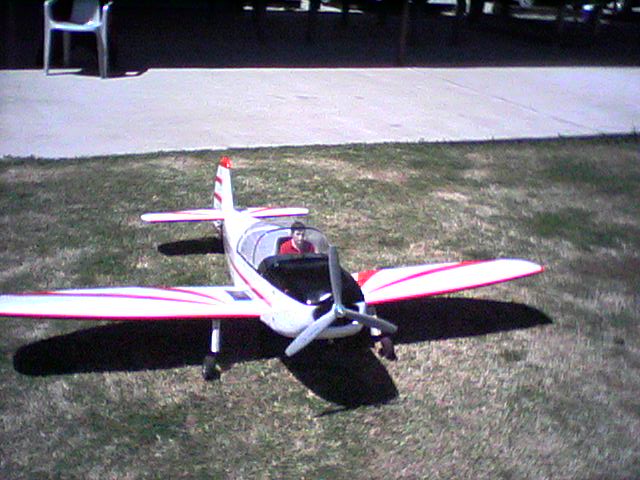

Walter,
There is no problem with the covering it's regular Oracoat or Ultra coat. It shrinks well with minimal heat and stays put. I dont have the plane anymore but not due to anything but my own fault. The canopy is quit large and VQ has precut black trim that you run along the front and the sides. I did not glue my canopy down but used Du-Bro #2 pan head soc screws to secure it. This works for all my planes but I failed to use enough screws and the front of the canopy black trim developed a hair line crack. During a hi-speed low pass air got under the canopy and ripped the turtle deck up and threw me into the ground. Atleast thats my story and I'm sticking to it.

Walter,
Don't worryabout the fuse being light, its made that way because by the time you get all your servos , batteries, switches install you will appreciate the lightness. In my humble opinion the plane begs for a small 26cc gas engine and the cowling is large enough to hide a side carb mount Zenoah G-26EI. I would never install a glow engine in this plane. The one thing you dont want to experience with this plane is DEADSTICK. If you go Saito, install the the Gas version of the2.20 and swing a three blade propeller.
Beefing up the fire wall only adds weight to the overall plane and degrades performance. You want the weight to come out around 12-13 lbs and the wing loading tostayunder
that of a warbird of the same size.I guarantee you won't like this plane heavy.The wings on this plane are beefy and very well put together, no foam, no fiberglass,all build up.
This isgood because they bear the load andthe firsttime you lower the nose at full power and the plane comesdown the runway at about 90 mph you will beglad they are strong.
What ever you do dont let air get under the canopy, you see the results above.All I saw was a tiny cut in theblack canopy trim and air gotunder and ripped the whole turttledeck out.
When the plane smacked the grass runway at full power thewingsdidnot break, the tube bent but the wings stayed together. This kit isvery well designed.
Go for it !

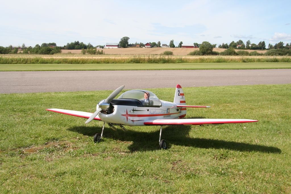

I can only recommend this Cap 10B, it is light, very well built and flies extremely well. I power mine with a 160FT, plenty for scalelike aerobatics. It's not a 3D machine, but if you really want to wring it out I guess a 160 2-stroke or upto 220 4-stroke would be ok.
I beefed up the undercarriage which flexed too much, and did the usual strengthening of firewall and most wood joints with thin CA. The covering is excellent, and I regard this model as a bargain.

Thanks so much for the information! I'm happy to hear that it is a good flying airplane. It's definetly very cool looking. Yours looks great! I was thinking about going with a Magnum 180 4 stroke or a 30cc gas engine but I like the your choice of OS 160FT. The gas engine option will probably be to heavy and increase wing loading too much. A good friend of mine has a Saito 220 but hates it. He can't keep the muffler on it because of excessive vibration. It's a very strong engine but the muffler won't stay on for more than one flight. He has tried different engine mounts, flexable pipe, and rubber couplings but nothing has worked.
Will yous hover or hold a knife edge with the 160FT?
