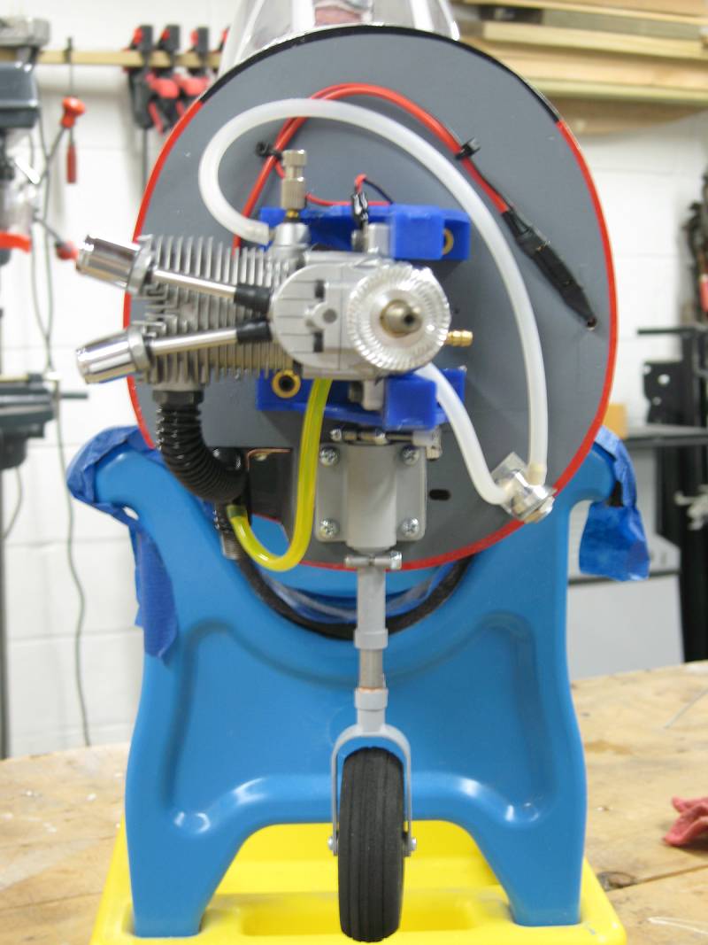

There's a huge thread running on this plane and we love it.
A lot of us use the saito 82a but there are other choices.
I mounted the saito side ways but you have to open the cowl a bit to clear the rocker covers. A pitts muffler would be fine but I chose a flex pipe.
