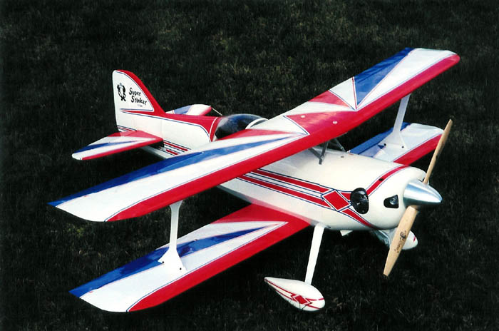

A picture of mine. I happend to have a Patty when the canopy went on a she looks great with her hair and earings)
This airplane can easily come in at just under 12 pounds, perhaps even 11.5. The OS160 will swing big wood, allow nice battery placement, will break-in quickly, and yank the airplane around.
I agree with replacing the ABS...lighter and stronger. If you get it into 11.5-12 pounds, you will have a very 3D'able Pitts on your hands.
Mark

Beautiful model, Mark.
