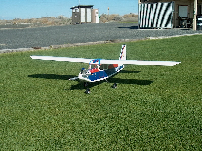

Pit-Viper the distance from the firewall to the front of the engine spinner backplate is 4 1/8 in .
I use a OS 70 4-stroke on mine . flys great I can fly around all-day at half throttle . I have to bring it down after about 20 minutes , otherwise it would stay up for another 25 minutes . I have got a 16 0z fuel tank .
