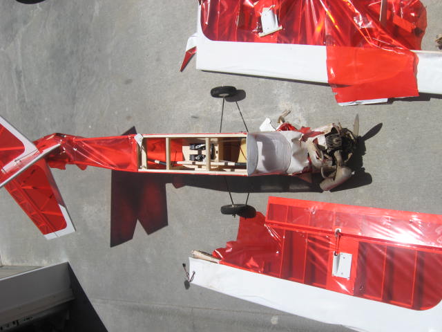

Hey everyone with a Kadet Sr ARF. Check your glue joints on the wings!! This last Saturday my son and I were on the second flight, after the maiden and trimming out the buddy box, when on the third lap around the oval course at half throttle, the right wing shattered and folded!! The left wing then ripped of, and the fuselage and our new Super Tigre .45 came screaming in from 300' up. There had been no aerbatics, or high speed pull up etc. Just simple teaching pattern basics to my son like the simulator.

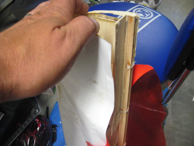

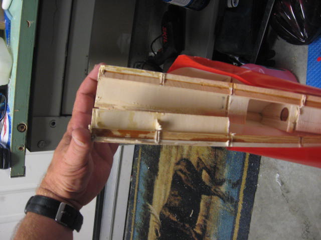

Upon examination, the spar area that builds the wing joiner box was almost devoid of glue. I have called Sig, and sent in photo's, so hopefully it will be replaced. Talking to bob Nelson at Sig, he stated that they have had a few cases of this. My advice is to strip the covering and re-glue your joints, or rough up the joiner, and make it a one piece wing with epoxy. Poor ol Super Tigre didn't fair well, and a couple stripped servos later, take it from me, and fix your plane.

The same thing happened to a friend of mine recently. He was on his second flight no areobatics, etc. Then as he turned 90 degrees on a downwind leg the wing folded hit the tail and ripped off the rudder and elevator. The rest you can imagine. Yep, just tooth picks !
Go to this thread, http://www.rcuniverse.com/forum/m_89...tm.htm#8903153 and look at the pictures I posted recently of my SIG Four Star 120. If you read what I wrote there you will see that I had to strip and recover the wing because it was so flexible. Turns out 20% of the joints had no glue and the remaining joints had a glue that would not hold. The only thing keeping the wing together was the covering. Fortunately, I reglued and recovered before it failed. I think SIG should not be selling ARFs that it most likely knows are defectively glued.
