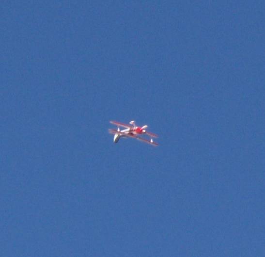

If you have a dead stick with the skybolt, or almost any Biplane you need only remember the plane has a lot of drag so you need to turn for the runway right away and keep the nose down to keep your speed up. It's not a problem but if your low things will happen pretty fast.
Here's mine with an O.S. 91 four stroke.

You guys are great ! Thanks for all of the info. Oldvet what size prop do you run and what servos are you using... that is a beautiful plane...

I am flying it with an APC 14X6 prop, the engine is an older 91 Surpass not the current Surpass II, and I used Futaba S3152 servos since it requires 54 oz-in servos for the control surfaces. I had them on hand and they are a really good fit with this plane.

that might also help you. The one in the picture is an ARF but I've flown them since way before the ARF. I prefer the ARF as it is much lighter. Although there was an alignment problem with the lower wing and fuselage on the one in the photo's.
