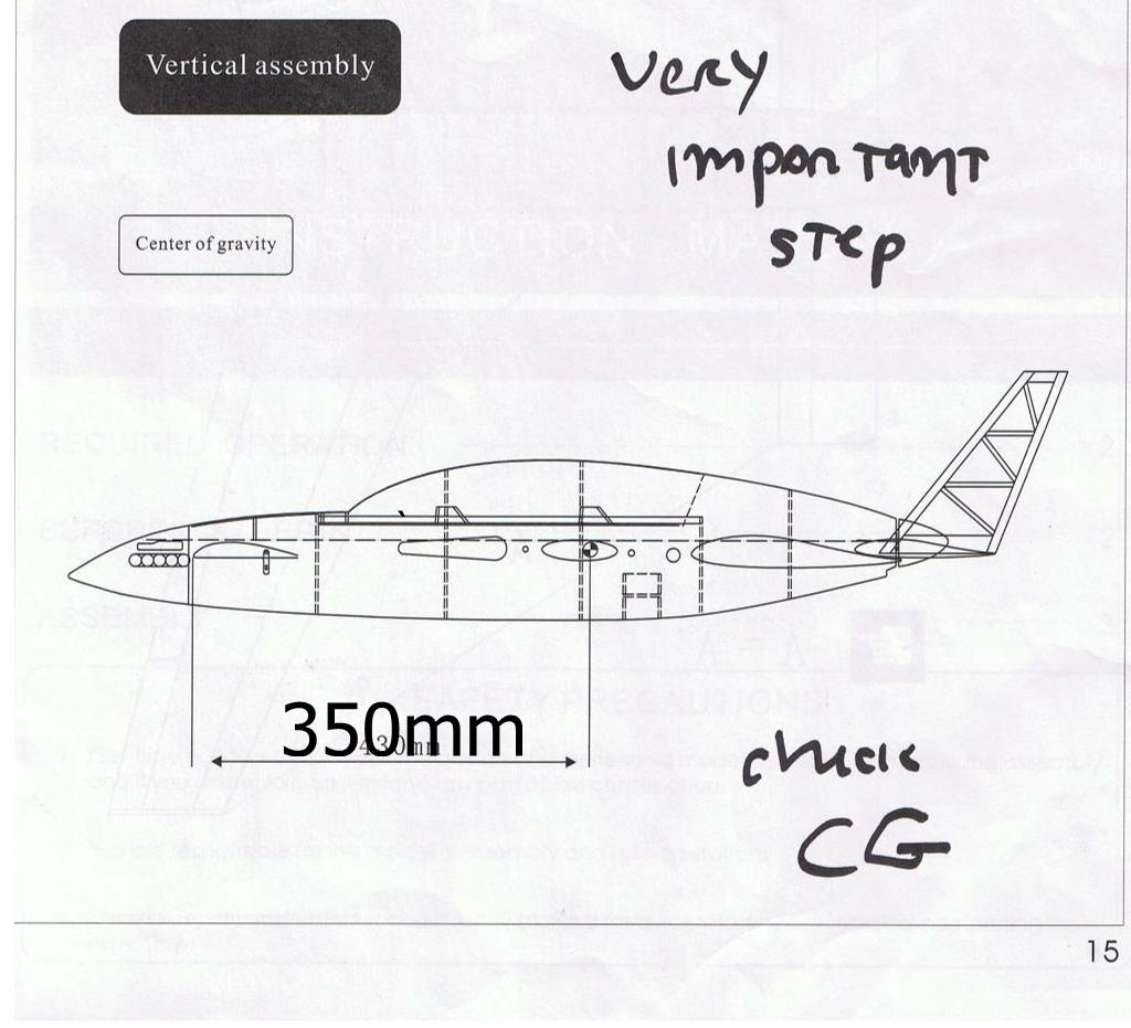

Can you tell me where your CG is?

My book says 430 mm from the leading edge of the canard wing. I would tend to be forward of that point rather than rearward. I found it fairly easy to fly as long as the speed was kept up. When landing give it full DOWN elevator as soon as the mains are planted to keep the nose on the runway or it will try to fly again and stall just above the ground. GOOD LUCK

My book says 350mm back from leading edge, but doesn't say which one..
This is my model
56 inch Wing Span
32 inch Fuse

Old 10-28-2014 | 06:43 PM

It is 350mm from the FRONT (leading ) edge of the front stabiliser surface.

It is nitro Power (OS 46 FXi)

So it would be like this....
