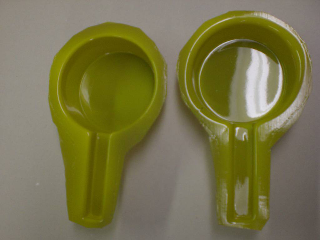

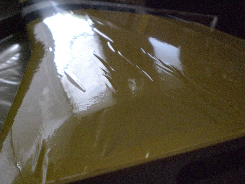

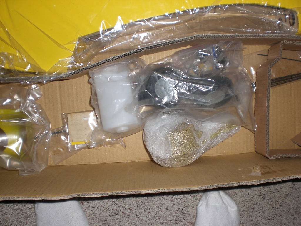

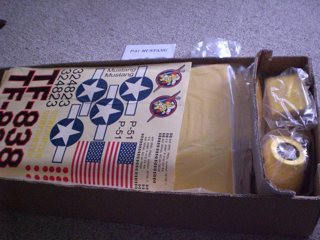

Recieved the kit and 2 servos in the specified time frame of about a week. Kit arrived packed well and with no outside damage. Upon opening the box I found 3 things I did not care for (1) decal sheet was bent up which is minor and (2) the retract wheel well liners which are vacuum formed plastic were not formed very well (3) poor instruction manual.[] I have contacted customer service about this issue and in 4 days have not heard back from them.[] I have also posted a question in their support forum on RC Goups. The add says pre-installed retracts, not so. Rest of the kit was typical ARF in that it had a lot of covering wrinkles, this is normal and not a big deal. One thing to keep in mind here this is a $100 ARF, not one of the more expensive ones. For what I paid I am happy with the kit at this point. A good value for the money. Build thread to follow, warning I am slow![X(]

E-mailing and posting in the forums has produced no responses. I had to call customer service during the day and was on hold for some time. They were very polite and offered to inspect the vac formed wheel well liners if I would send them back. Seems like a lot of effort for a vac formed part, but I understand. Looks like I will just build them out of balsa and paint them. Will add strength to the retract cut outs anyway. I have reglued everything I can get to on the fuse. Instruction manual lists a spinner included in the parts list, but I think this is just a generec manual and I found no spinner in my kit. Takes about a 2.75" spinner and a trip to the hobby shop produced one for about $7. This build is being interupted by a building/designing contest airplane. So my progress will be slow.

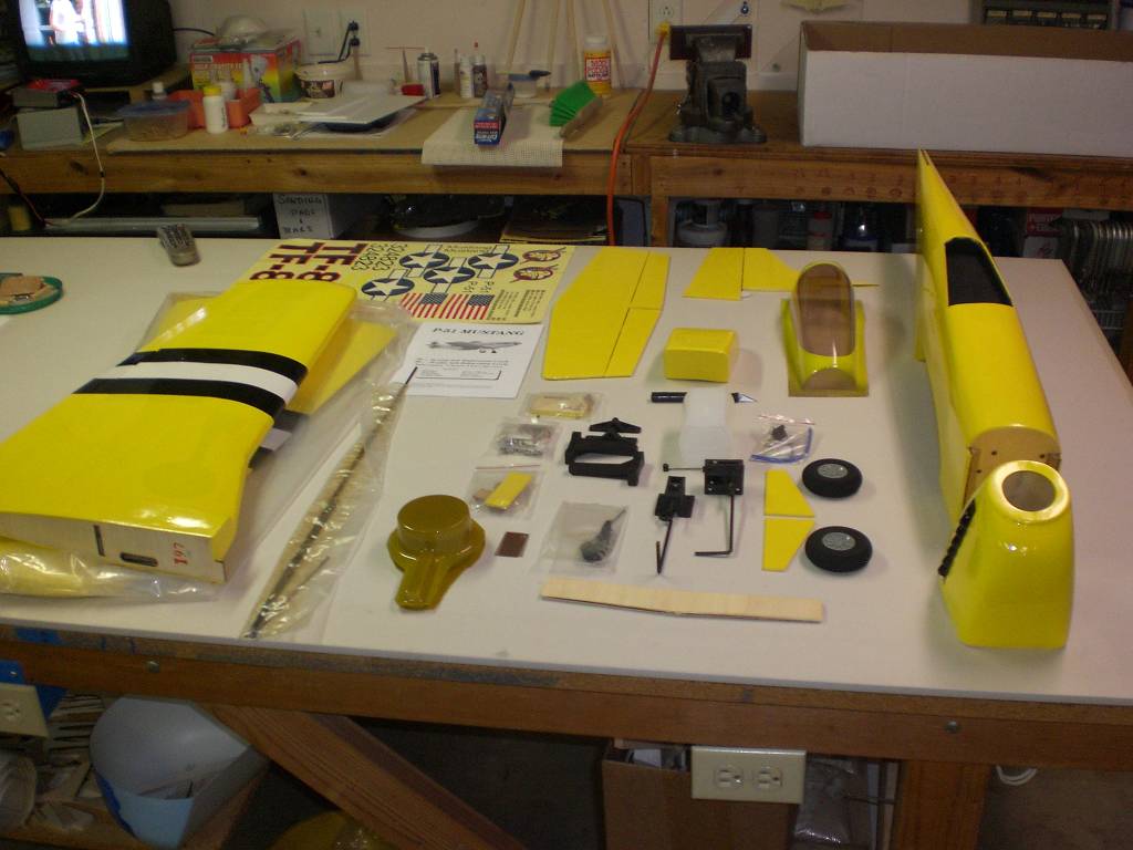

I was admiring your build table, What is the top surface? It looks like drywall in the Pix

Yes your correct it is drywall over a 2x4 structure covered with 3/4" particleboard. I have two of them, they used to bolt together to build full scale airplanes on. I am past that and only build models now though. Overall I have been pleased with the NP .40 kit. It is safe to say that the more expensive ARFs are most diffinately of much higher quality though. I am sure the customer service is much better as well. No luck on getting the wheel well liners replaced, had a few folks contact me but looks like I will just build them out of balsa. Their customer service needs work to say the least. I am glad my kit did not have a major defect. Retracts are pretty much not worth installing. I purchased .40 sized Hobbico mechanical retracts and they are of much higher quality. I also purchased the metal gear HD servo, save your money on that one.

The plastic wheel wells included in these "Evergreen" kits normally have to be trimmed by hand.
More often than not people use large wheels so they tend to get thrown out.
I would recommend doing so anyway as the plastic wells tend to break easily. Better to cut out a larger wheel well opening and form a balsa inner wheel fender. This is fairly easy to do and looks much better while adding a bit of additional strength to the area.
