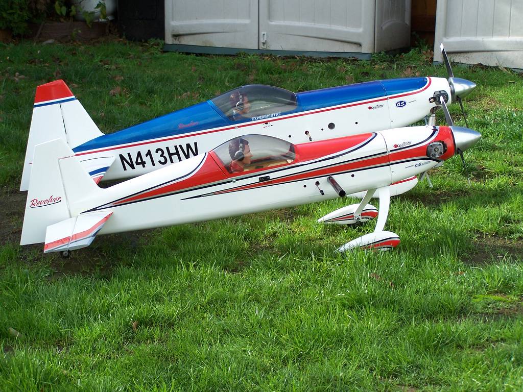

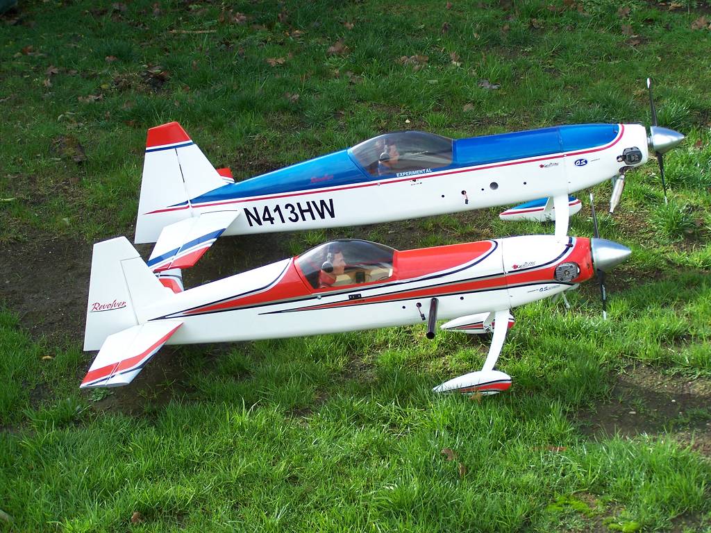

Hi All,
Here are some pictures with the wings off so you can see the size of the big and little revolver!!

Its a bit thicker and stands a bit higher, but the overall length of the larger one isn't as big as I thought it was going to be. For some reason I was figuring it was going to be considerably larger. Still a nice looking plane though.

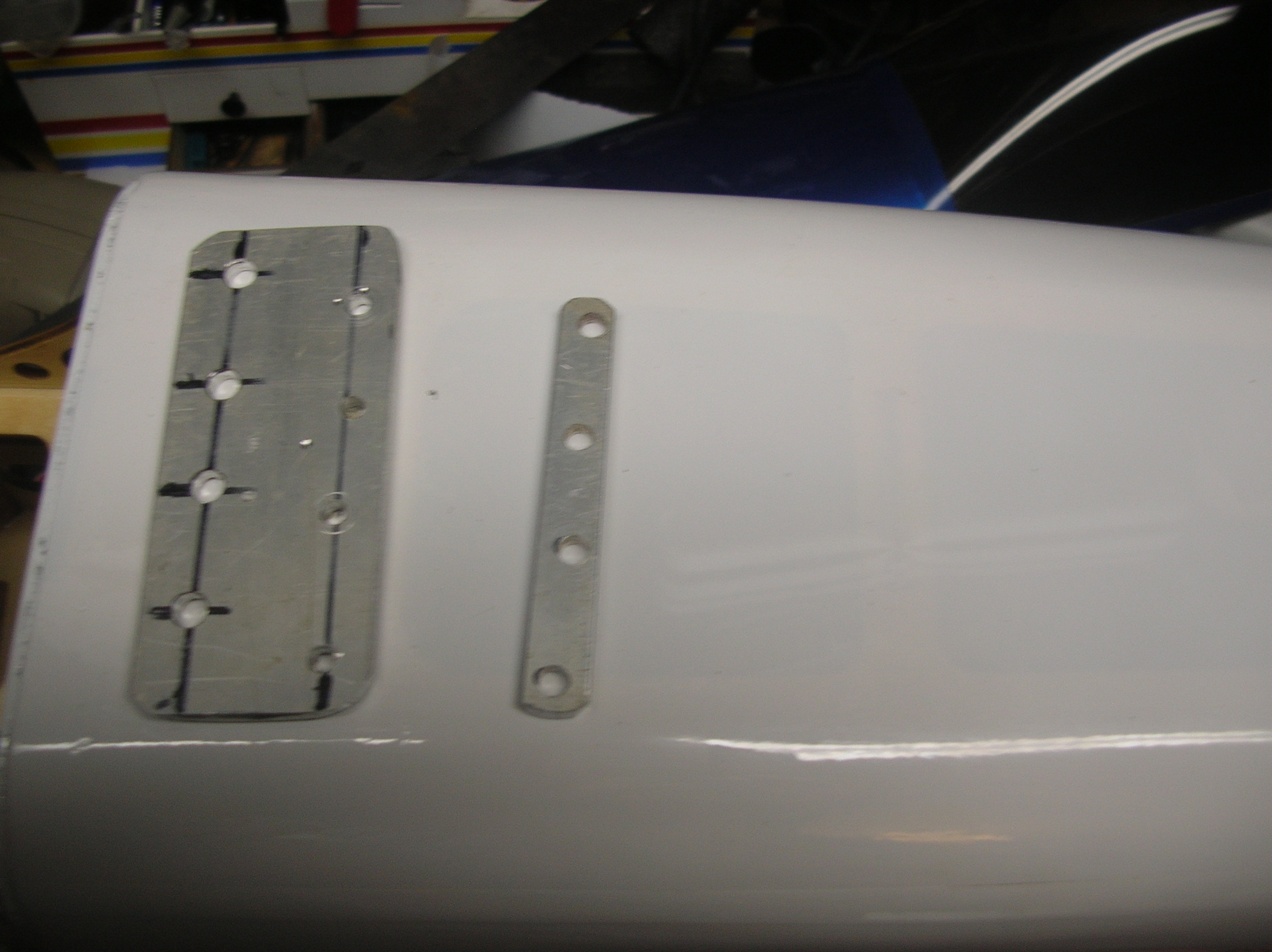

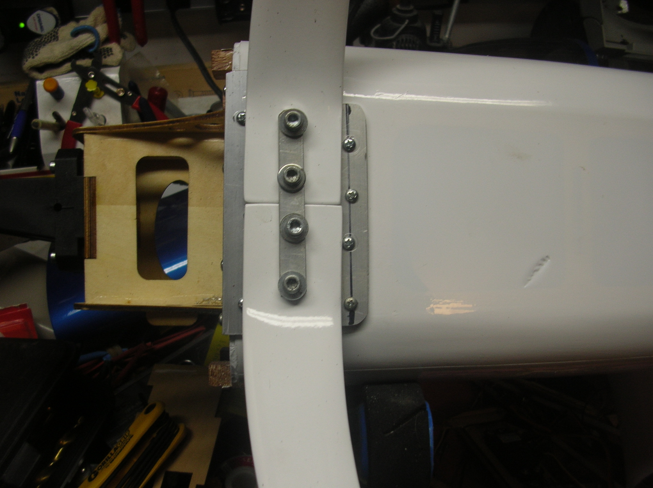

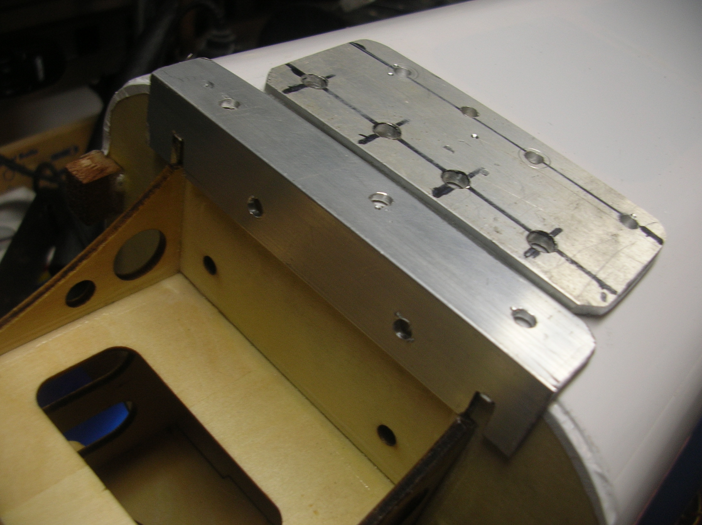

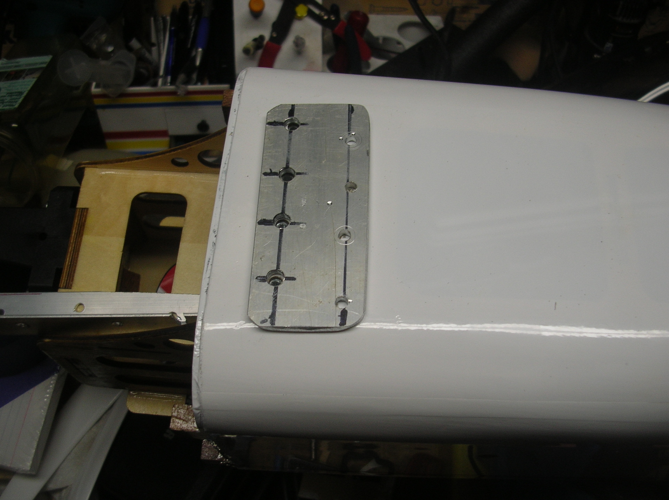

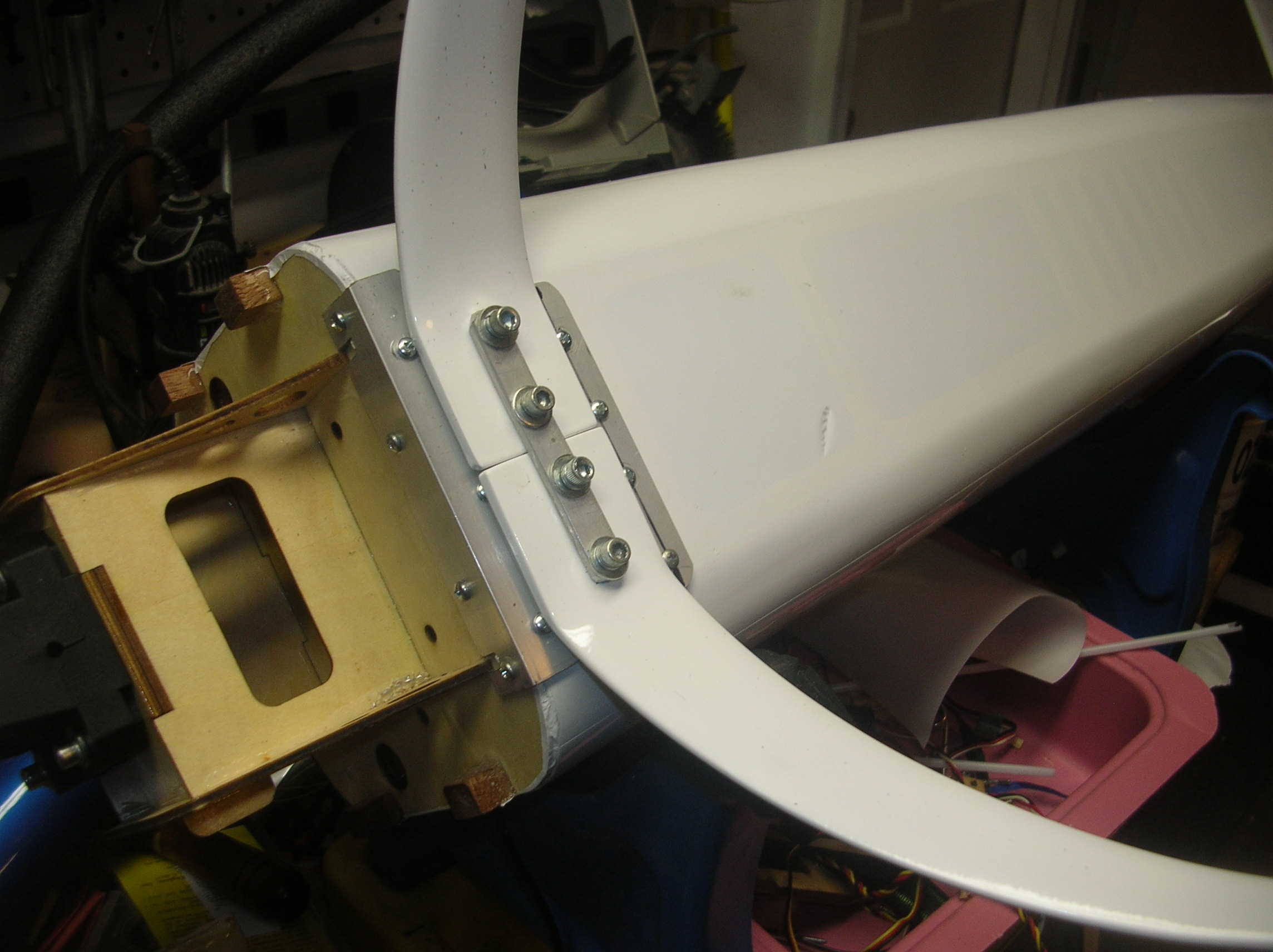

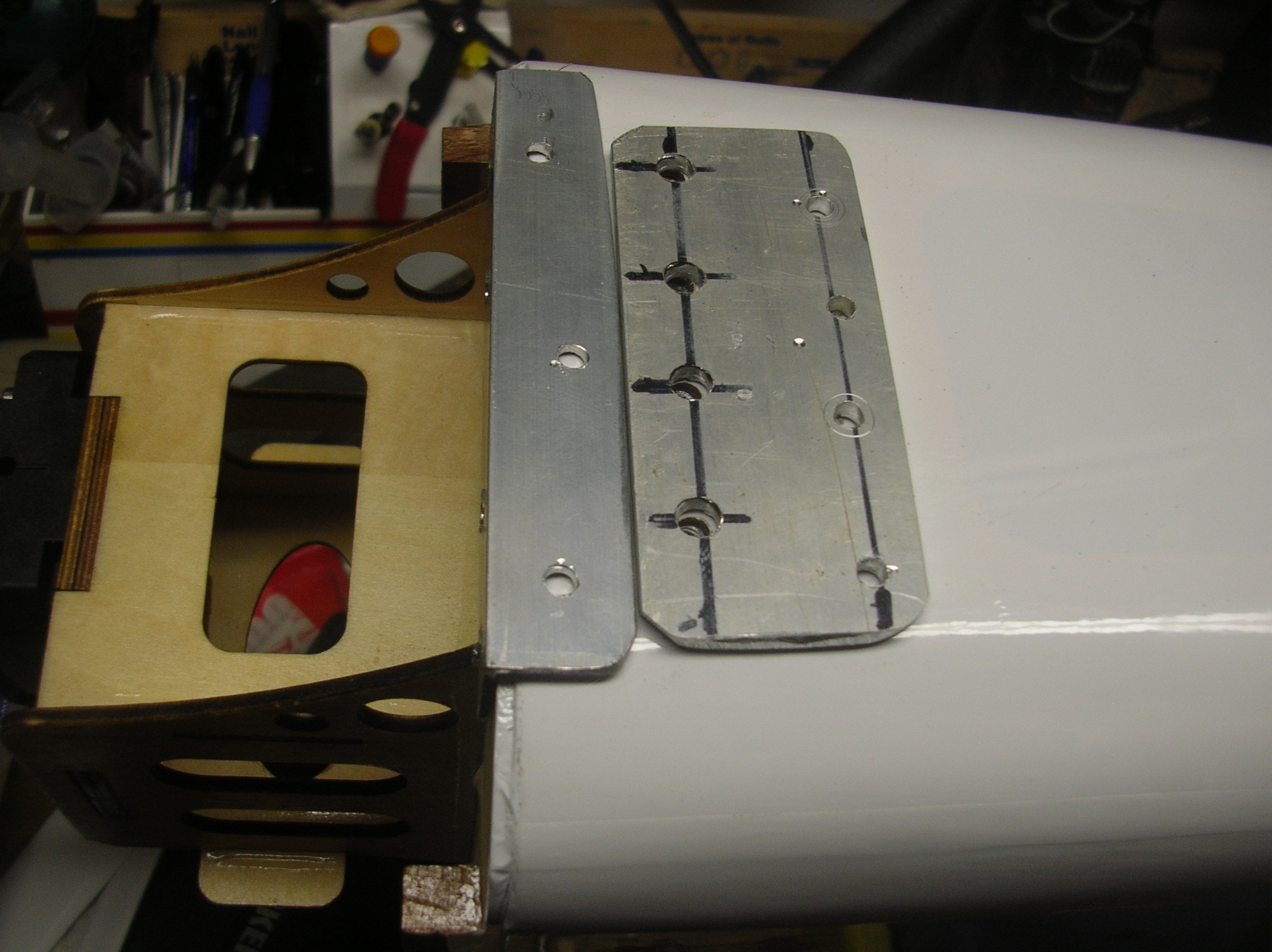

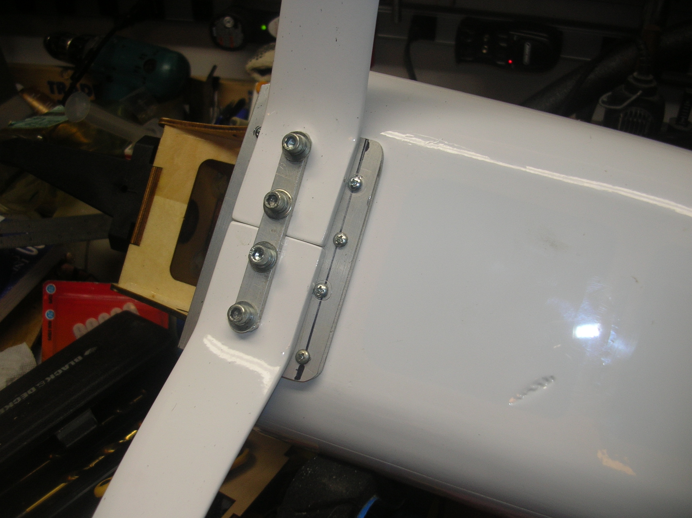

Here's how I beefed up my gear. I figured I do this now rather than later after the 1st flight.

frankeldan;
That's a very sweet beef job!!! I know that took some time but I think that will work!! Please let us know how the first landing goes.
I hope we get a break in the weather soon so I can fly my baby!!!

Thanks Sonny..
It didn't take all that long .. about an hour.. with a couple ciggy breaks in between.
The problem with this split gear is that it puts too much force on the skimpy plywood rail the the blind nuts go into. The same thing happened on my 27% GP Cap232 and on my GP Giant Ucando.. One would think that Great Planes would give in and just admit it's the worst design and go back to the drawing board. Nobody has perfect touchdowns every time.
