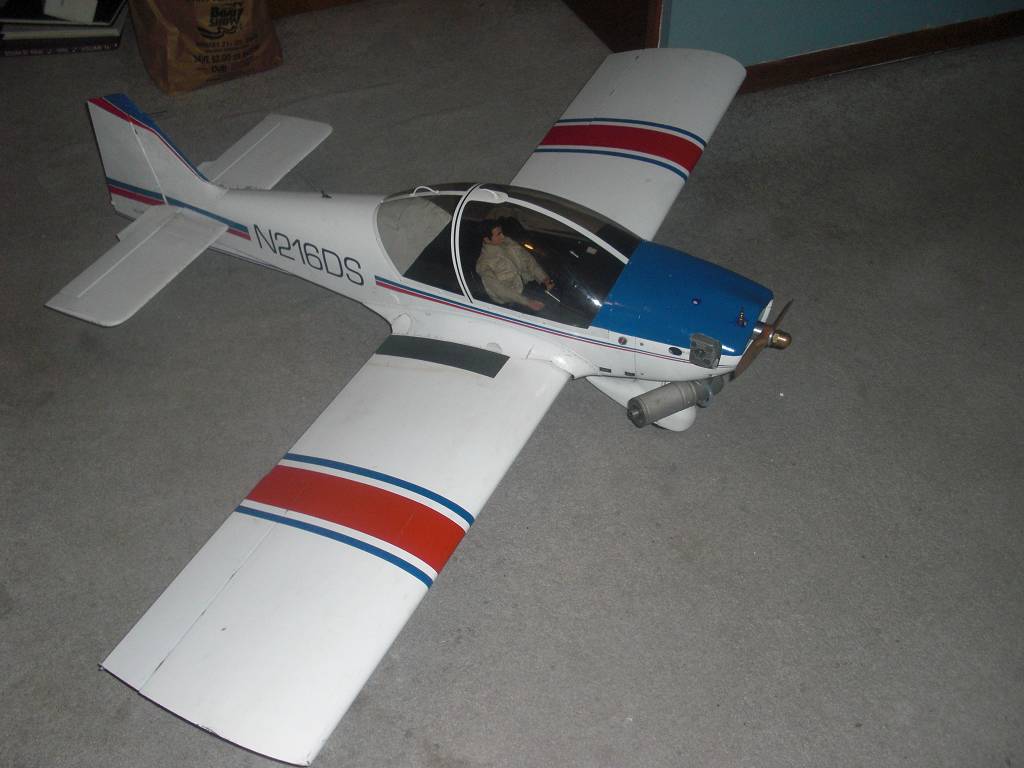

HI I'am in need of some help to find a manual for the robin r2160 67" wing span not sure of the weigth of the plane a friend gave it to me so I'am trying to find the cg and the right motor size for this plane I have looked I found one but it was a 87" wing span but it did not have a manual to view any help would be great
thanks much blade pro

Anywhere from 1/4 to 1/3 the way back from the leading edge of the wing, forward for the first flights, shift it back if you wish later.

With any normal layout, wing in front, tail at back, the balance is always the same. What propels it don't matter.

HI pimmnz ok that's good it has thunder tiger G-90 on it thanks for the info
