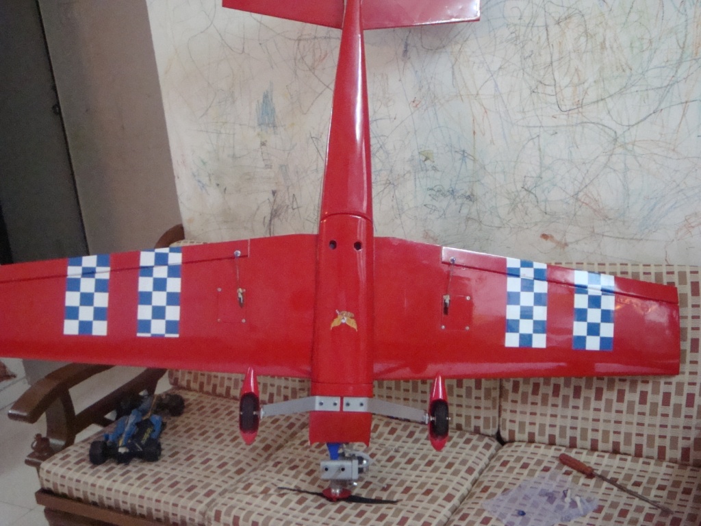

After spending some significant time on my 46 size trainer (and numerous crashes and repairs) I got this – phoenix extra 300s 46 size from LHS. I’m not an expert flyer, but can do loops and rolls. No problem doing take offs but bad landings ( I think I do only 1 good landing out of 4 ).
Took long time to set up the model, since I had to do lots of repairs in the wings. Almost all the ribs in both the wings were broken, during shipping I guess. It flies better than my phoenix paragon trainer though it’s very agile for me. Take off and landings are easier as compared to my trainer. When I cut the throttle while landing, I see more predictable sinking of the model , this makes me feel more comfortable bringing it down. Done many flights but only one landing so far. Flying with my instructor still.
I’ve put TT46 pro with Pitts style muffler. Futaba S3001 servos everywhere. 11x6 APC. Here are few pictures…

I really like mine and it arrived with no damage. I use a 55ax with a pitts muffler and a 11-7 wood prop. The factory glued landing gear area that I didn't beef up seems to be holding up fine. After you cut the throttle to bring it in, just give it a tad of throttle about the time its ready to sit down and you can grease it right in with no bounce. It's fast and fun to fly.
Overall it's like flying a "little brick" but a good bang for your buck!
Good luck on your landings and thanks for the pics.

Thanks for tip on landing! Will try that!. I used lots of CA and epoxy strengthning the structure. covered firewall as well as the wing servo tray area with thinned epoxy.
Had tough time setting up the aileron servo rods. Decided to keep the rods square to aileron (manual didn't mention this), but the tray doesn't seem to have much area to do that easily. In retrospect I think it wouldn't matter if you don't keep the rods square to aileron.
