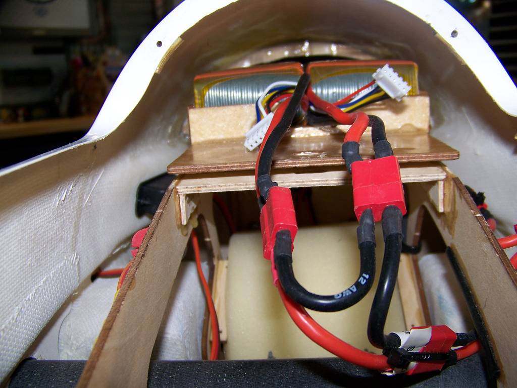

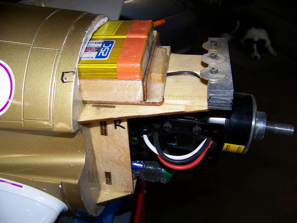

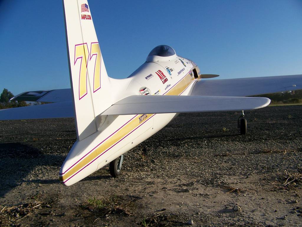

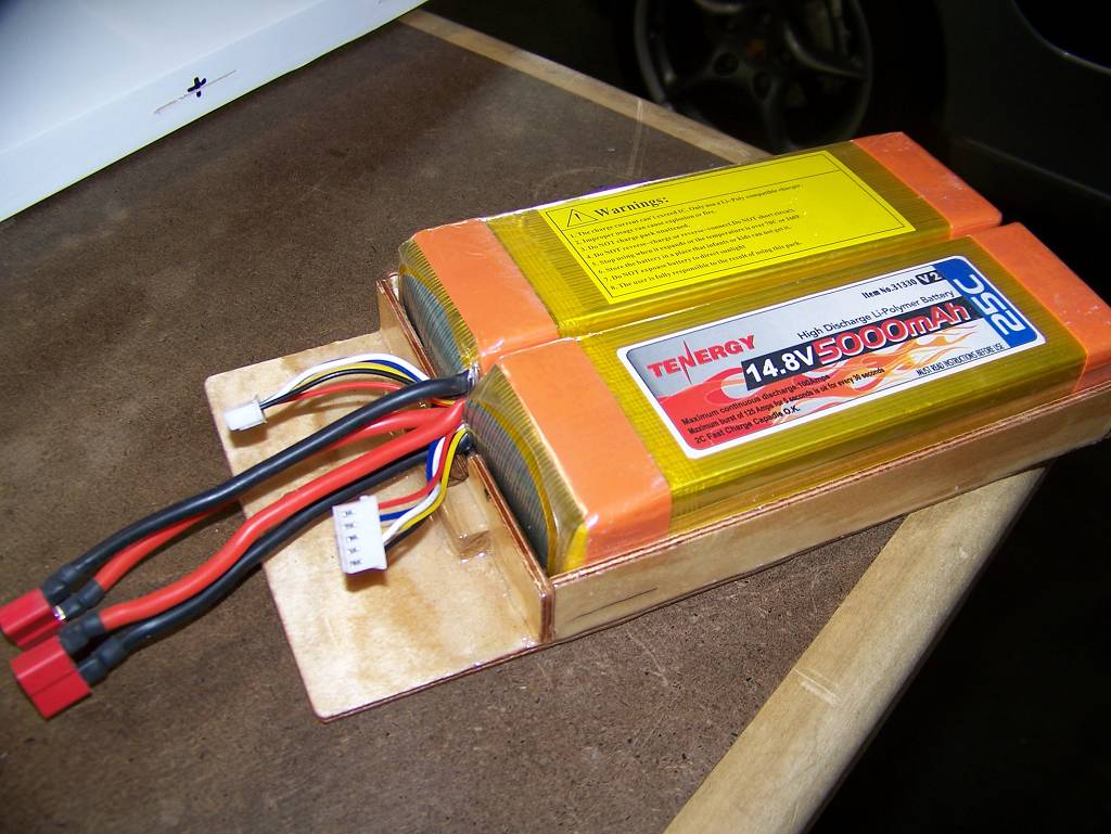

I've included the photos I promised.
Glynn
