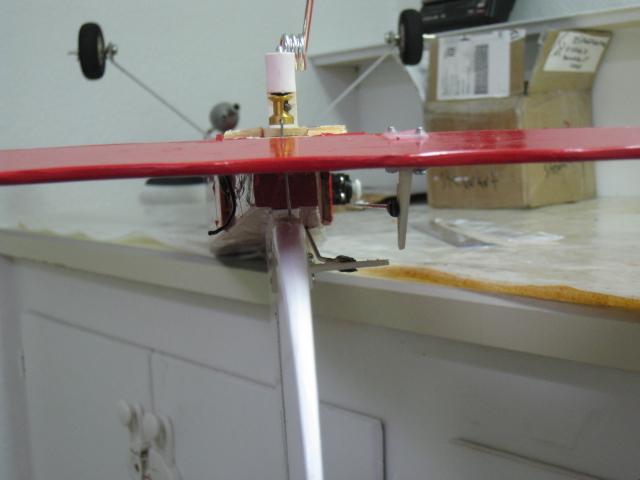

Those of you who have made this conversion, would you care to post a few pictures of the tail wheel arrangement and the set up?

Default RE: Great Planes Big Stik 60 tail dragger conversion

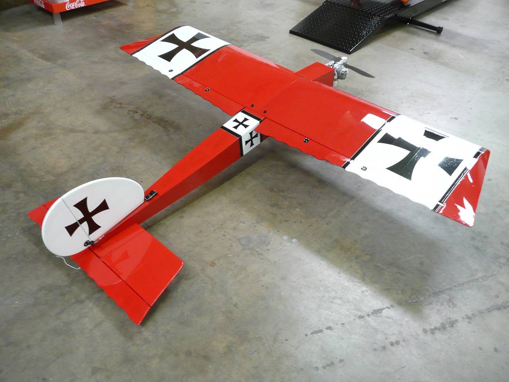

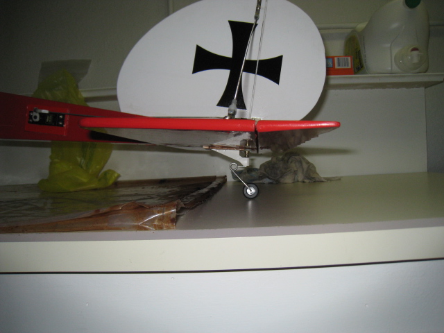

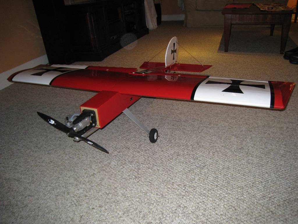

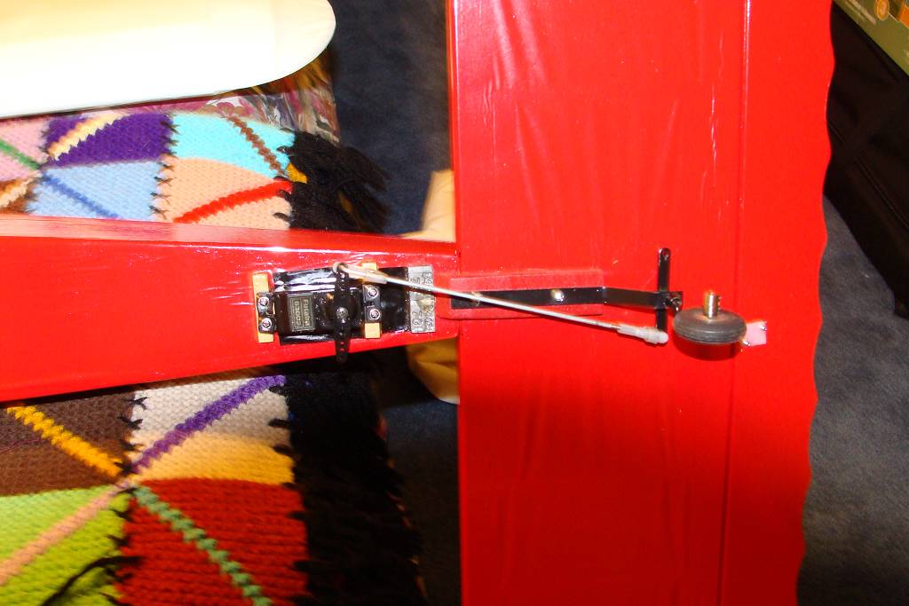

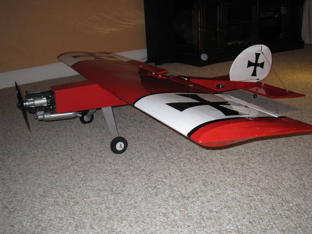

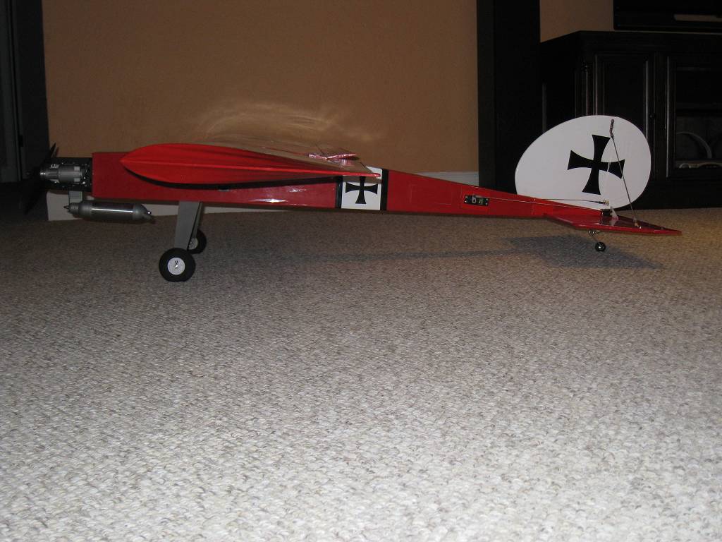

I just completed this conversion. I used a sullivan tailwheel and threaded the rod through the horz stab and up into the vertical stab. Let me tell you, this was a pain the arss mainly because i had to create a "z" bend to connect the wire into the rudder and you have to do this while the wire is already threaded through the horizontal stab. Then the hole I drilled in the horz stab wasn't large enough to allow adqueate travel of the tailwire, so I had to enlarge the hold and then reinforce with with CA and Epoxy. The CG was also pushed back a 1/4 inch so that now it balances at 4 1/4" instead of 4" from the leading edge of the wing. It might be slightly tail heavy when fuel gets low, but it's still within the acceptable parameters of CG based on the instruction manual. I'm confident a little down trim should be take care of it.
I only did this conversion because my engine was returned for service for the past three weeks so I had some time to mess around with it. If I were to do it again, I'd go the additional servo for the tailwheel route and Y connect it to your rudder servo. I haven't flown it yet. I think it looks a lot better as a taildragger, but i'm not convinced it was worth the effort. In my opinion, better to go with an Ultra Stick if you want a taildragger.

Hello!
See if you can tell what I did? I made a tiller arm that ran into a Central Hobbies tailwheel.
Perry
This is on my 40 size,
Bob

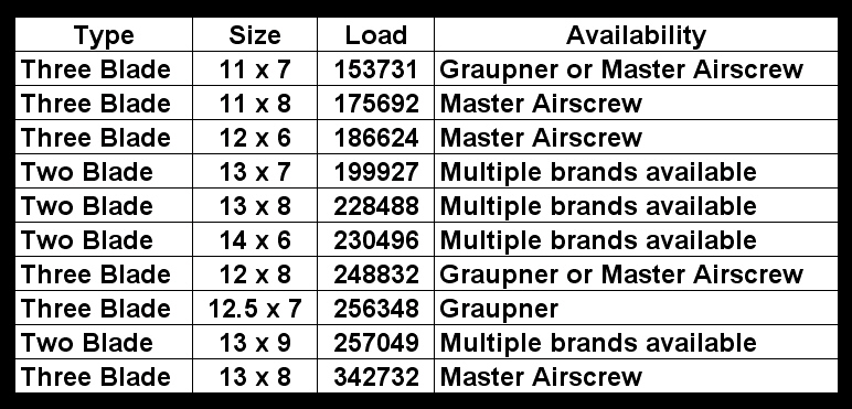

carrellh's Avatar
Joined: Mar 2003
Posts: 6,544
From: Garland, TX
When you go with a three blade you're stuck with a limited selection. Here's a comparison of the "load factor" for some available props. The load number comes from ThrustHP. Despite its shortcomings, the load numbers do seem to give a decent indication of whether two props will turn similar rpm on the same engine. As with most things in this hobby you do have to do some experimenting to see what works for you because we all like different things.

Old 11-25-2009 | 07:04 PM
ppkk's Avatar
Joined: May 2006
Posts: 454
From: Dallas
Yes, limited choice and pricey too...
