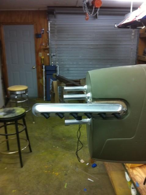

Any pics of the keleo exhaust install? Is it a direct install, or do you have to fabricate the tubes from the motor exhaust manifold to the scale outlets?
Interested in this setup, but would like to hear if the system is too restrictive and the how it sounds compared to a good pit style muffler.

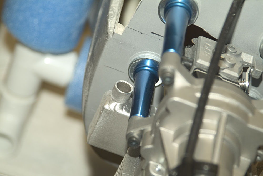

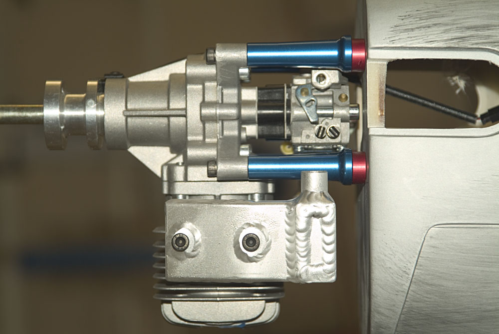

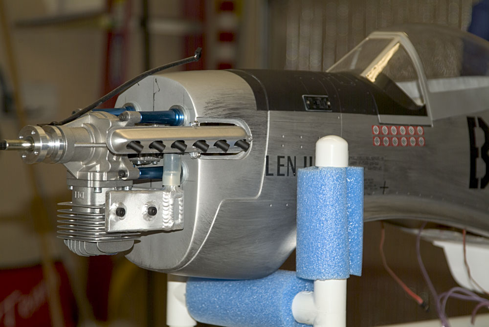

I have the exhaust and the DLE 30.I will startbuilding very soon, with a friends help. He has built this plane with the same setup and I have some pics he sent me. I will try to post latertonight.

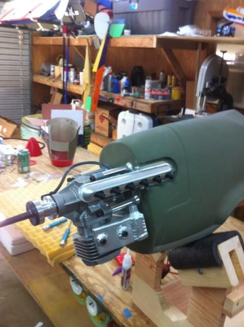

No fabrication required, but you have to do a bit of trimming and tweaking, of course. Here are a few shots of the install....

That scale exhaust looks really cool. Can't wait to see some video of it in operation.
Thanks for uploading the pics!

Just a few pics sent to me in the fall. The exhaust for the DLE 30 was fabricated on this very engine. My friend supplied his engine to keleo late summer for fabrication. I have seen the fininshed product and it is amazing. I have the bald eagle III, DLE 30 and Keleo exhaust. BTW the offsets came from Keleo.
Nick,
What prop are you using?
