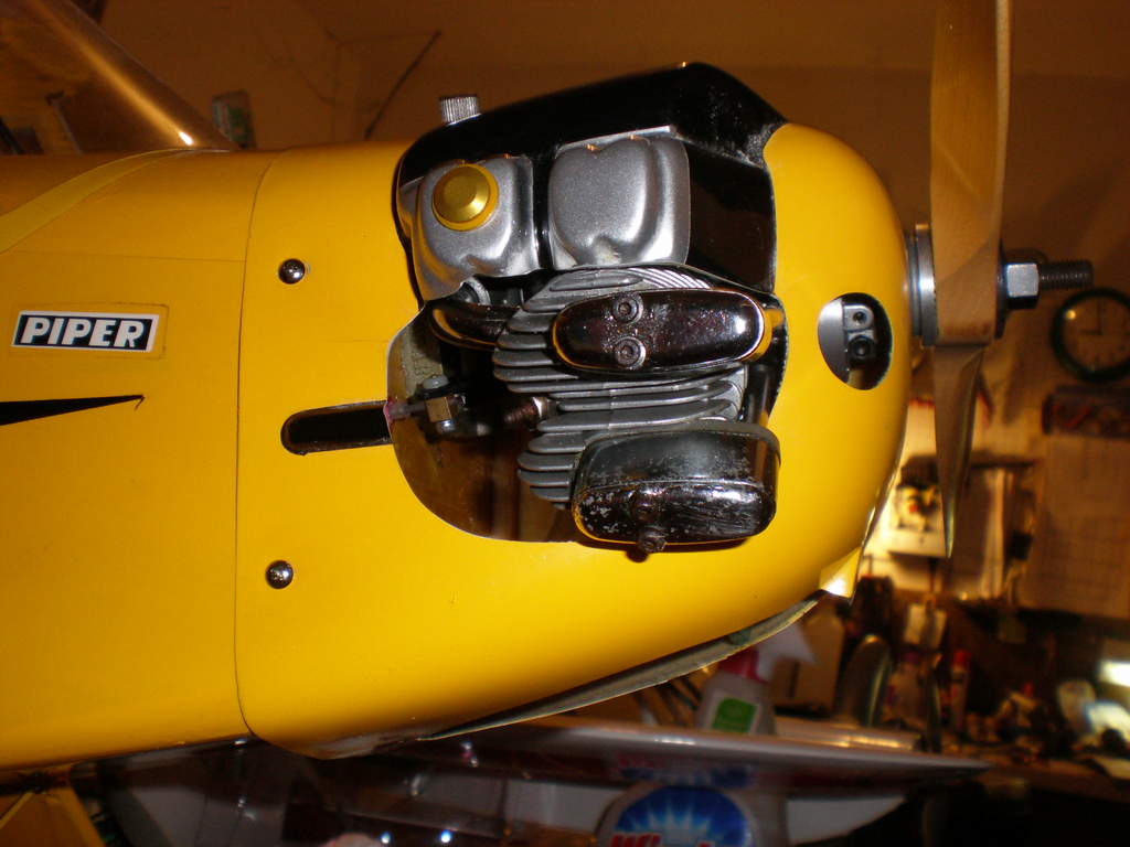

Old 06-19-2011 | 05:40 AM
My Feedback: (66)
Joined: Jan 2008
Posts: 1,171
From: Bennettsville, SC
Default RE: Hangar 9 cub
Here is the 90T in mine. It doesn't look too awfully bad. It makes up for it in sound!

Old 06-19-2011 | 11:35 AM
Posts: 4,314
Received 10 Likes on 10 Posts
From: Brockton, MA
Hi Scott,
I think that you can be forgiven for those nasty cutouts in the cowl, because you have a twin...
Since I've posted that, I ran across another post that hinted at something that I should have guessed at - mounting the engine inverted so that I don't have to deal with that nasty off-center cowl cutout. Yours at least looks like it belongs there.
Thanks again for the idea...
Bob

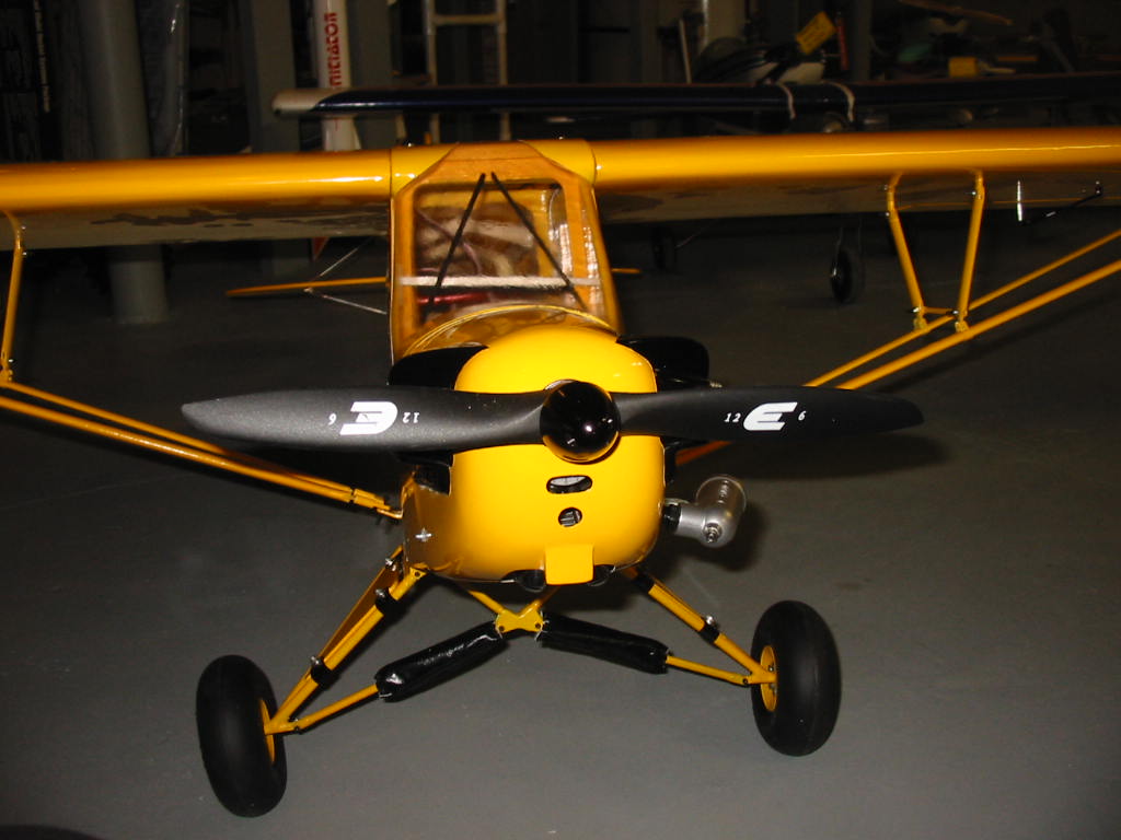

Old 06-20-2011 | 02:11 AM
Joined: Feb 2007
Posts: 126
From: deltona, FL
Hey Bob, here are a couple of pics of my H-9 PnP Cub with a Saito 72 in it. Since mine was the Plug and Play version and came with an engine installed I just used the mount the way it was. The Evolution 46 that came in it was junk and I got a new one under warranty but decided the Cub needed a four stroke. I had to drill another hole for the throttle pushrod and rotate the carb but installation was pretty straight forward. I kind of wish it was side mounted at a 90 degree angle but that would involve more work than I want to do.
ID:	1625535   Click image for larger version
Old 06-20-2011 | 04:59 PM
Posts: 4,314
From: Brockton, MA
Thanks for the photos, Gluemaster... A picture is worth a thousand words...

Old 06-21-2011 | 01:50 AM
Joined: Feb 2007
Posts: 126
From: deltona, FL
No problem Bob. The one nice thing about the engine being mounted the way it is is that the exhaust fits in the cutout. My Saito is an older one with the curved pipe and the long skinny muffler but the newer ones may fit better.
