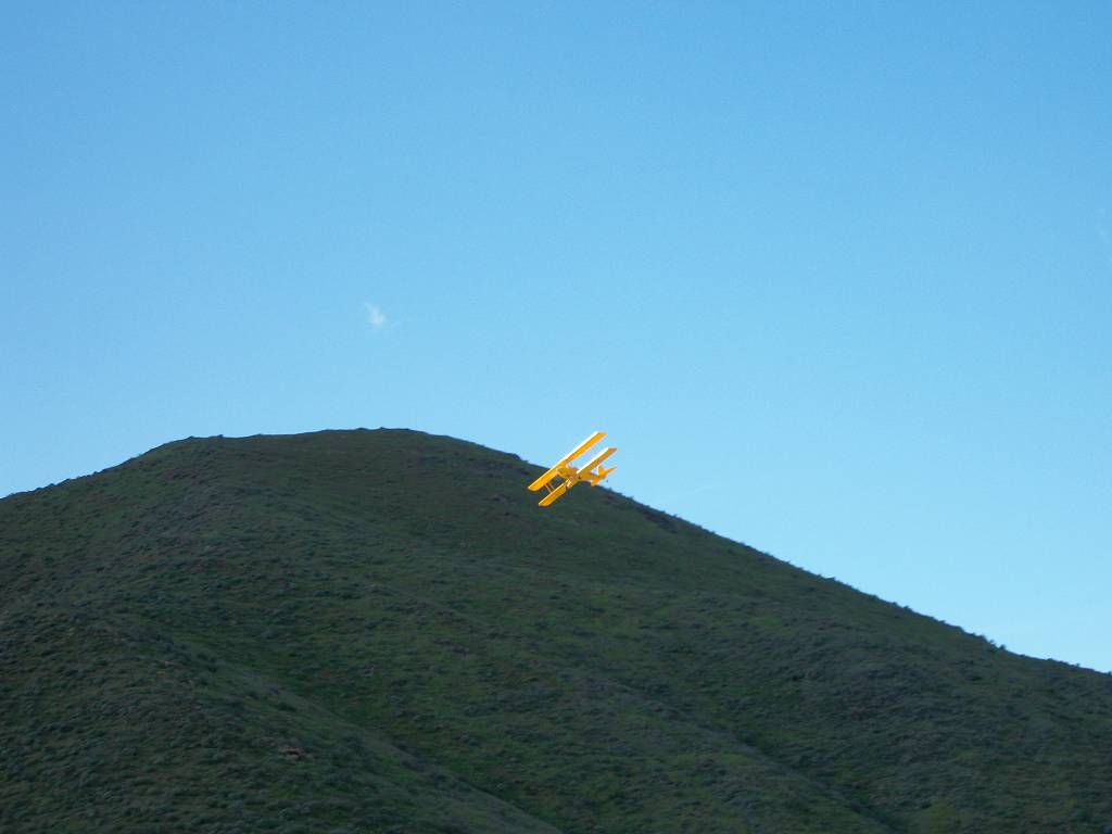

YS 120 and flys like a trainer. The YS 120 provides plenty of power. No weight was needed to balance. PM me for a RC Report Review
