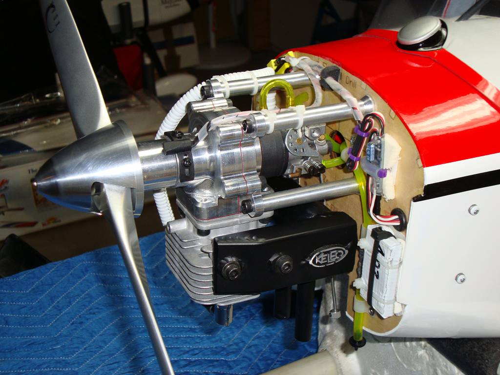

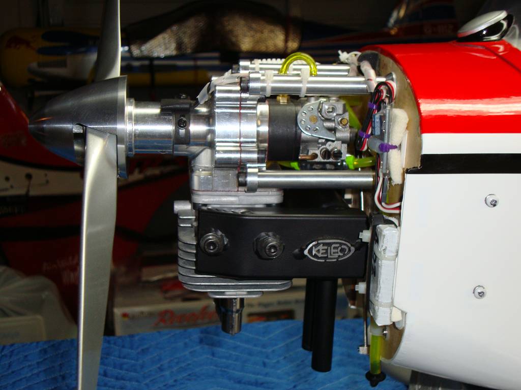

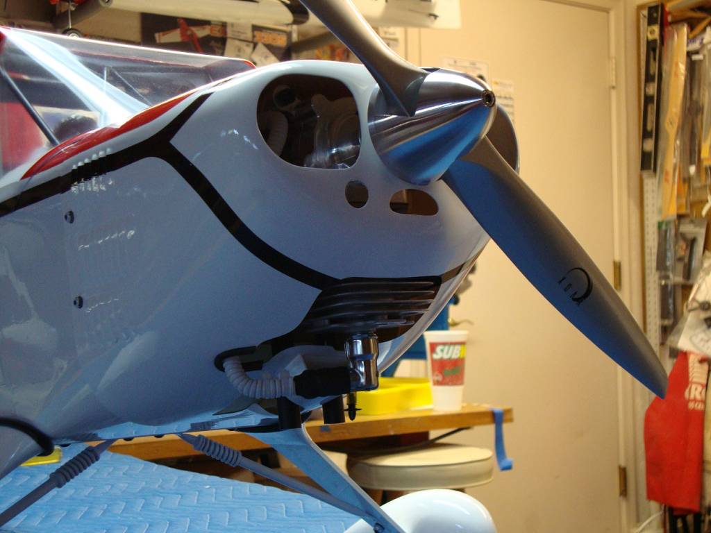

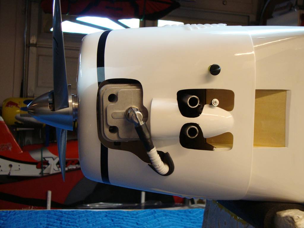

Old 09-18-2010 | 12:32 AM
Joined: Jun 2002
Posts: 128
From: No City
Default RE: hangar 9 Taylorcraft 20
RC Aero Prodcuts JC28cc with a Keleo Pitts muffler (mufflers are now sold by VQ Warbirds). The standoffs are 3" long and made by Keleo. Good performance with a Xoar 17X8 sword prop in silver.
