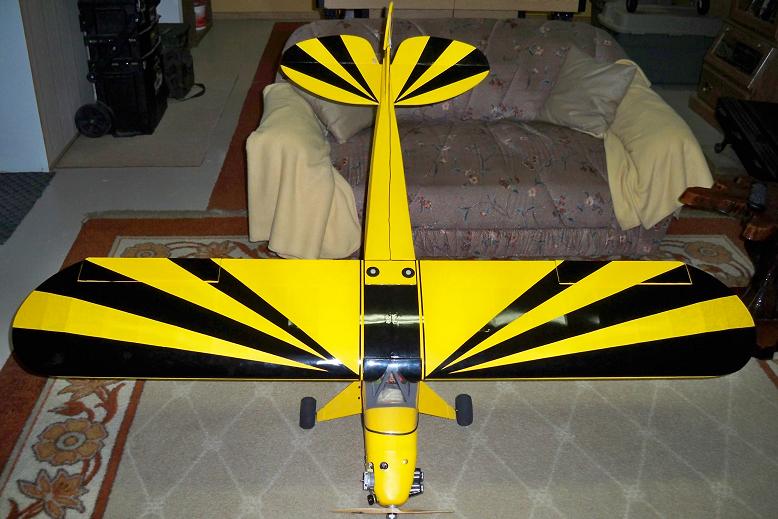

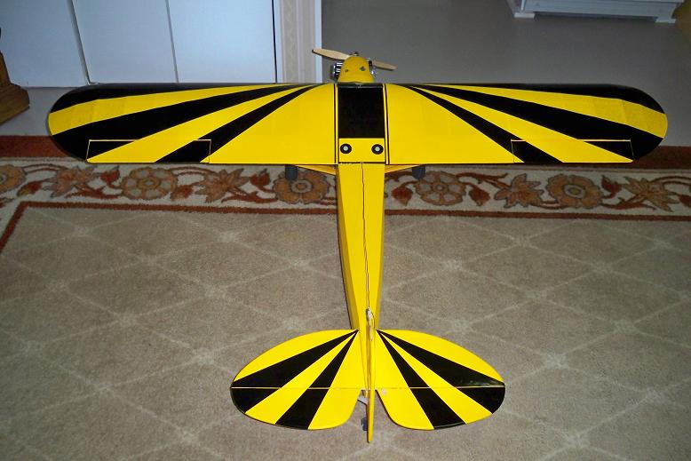

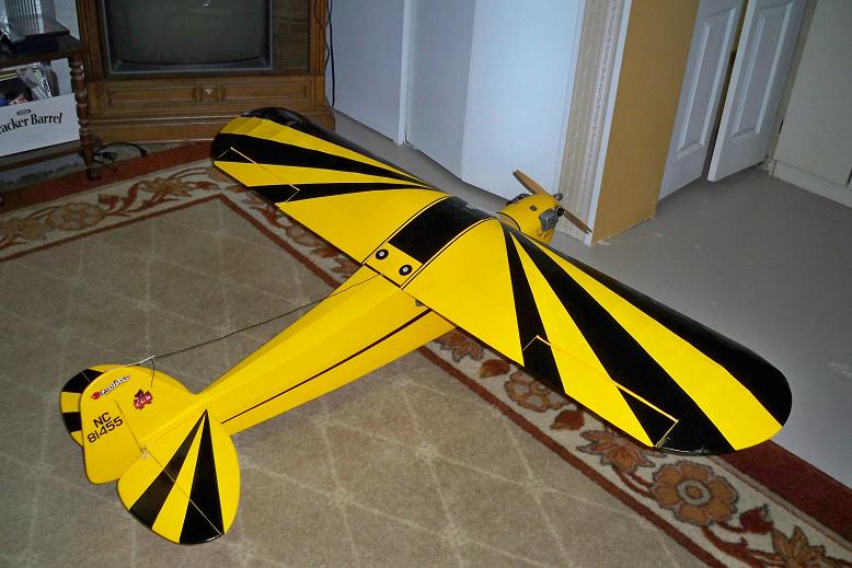

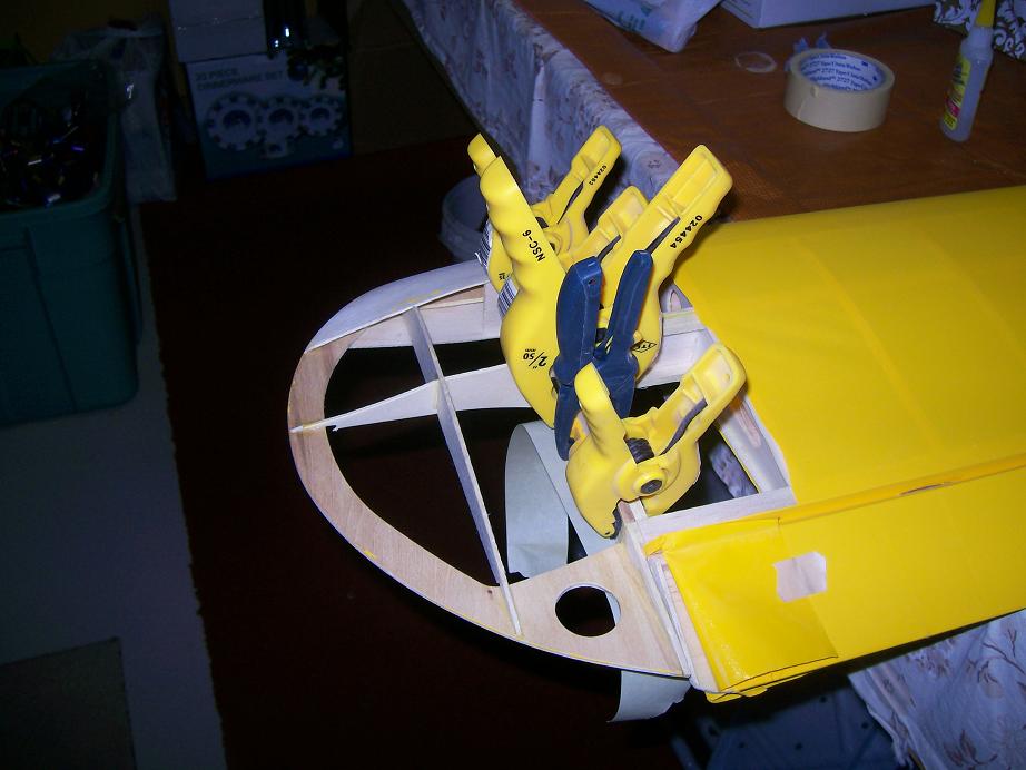

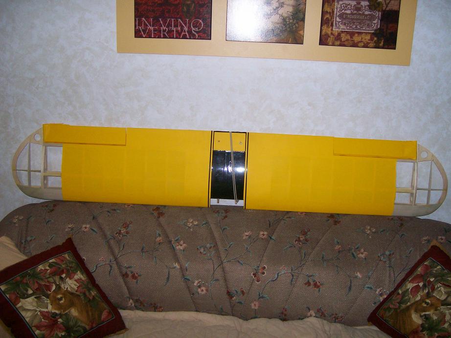

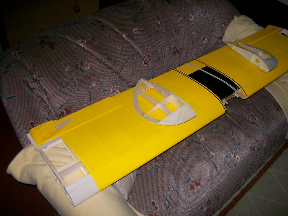

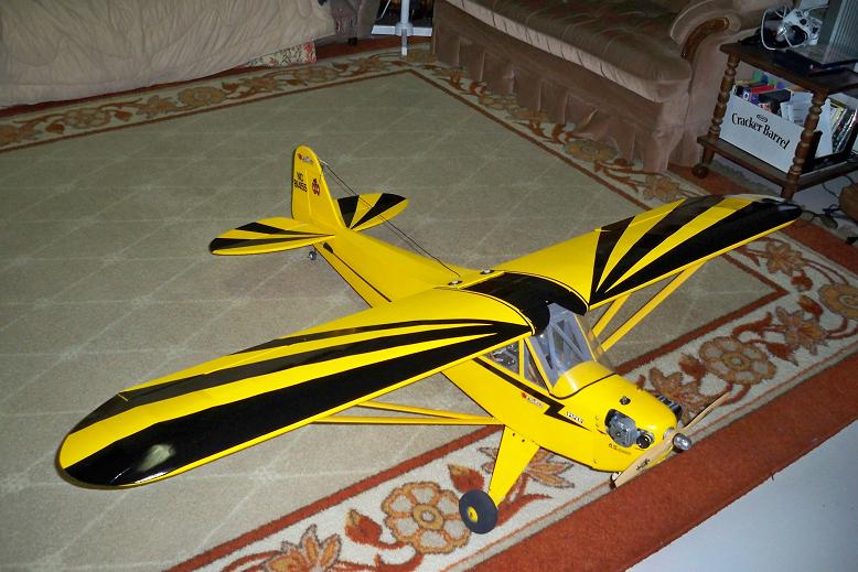

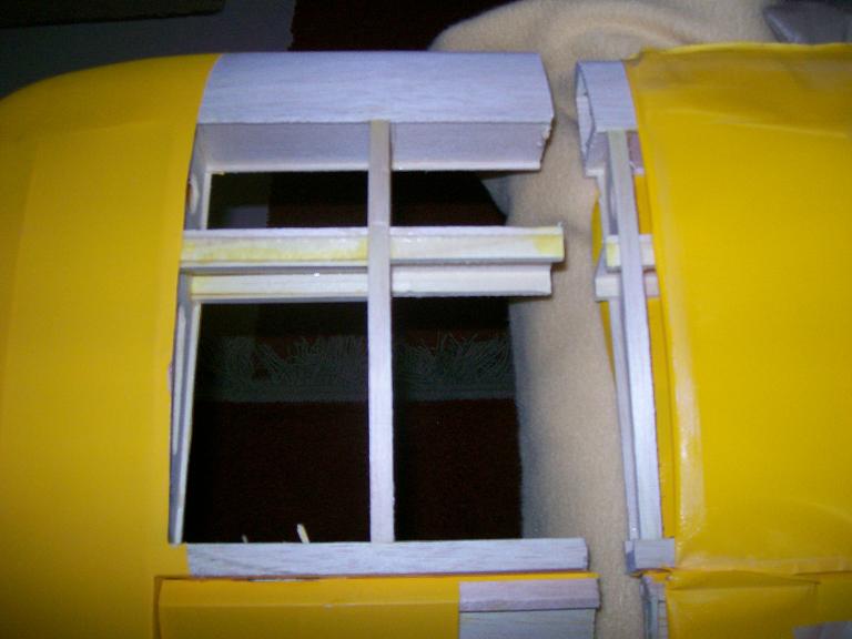

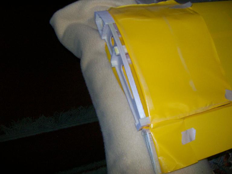

I had the same problem with my Great Planes Cub with the one piece 81" wing. It was such a pain to haul around, that I hardly ever flew it anymore and I almost sold the plane as a result.

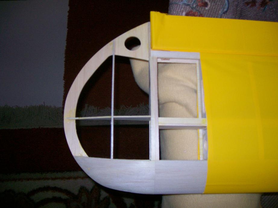

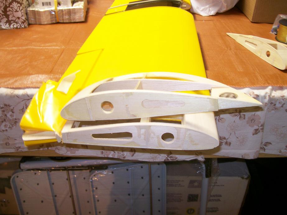

SO....Last winter I decided to "CLIP" the wings and I am sure glad I did. Now the wing is still one piece but only 68" long. I can now haul it with ease and it still flies fantastic and is way more aerobatic to boot.
I removed 2 bays from each wingtip to accomplish this but still used the original wingtips.
It was an easy one day mod and I am exstatic with the results.
Where there is a will.... there is a way!!
Good luck
Curt

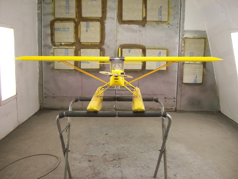

FWIW, I have a Great Planes version. When I was deciding on power, I was thinking of how it might fly on floats? I went with an Enya 80 I had because of that. A little bit much for normal flying (flies great using no more than 1/2), but absolutely perfect choice when on floats.....
