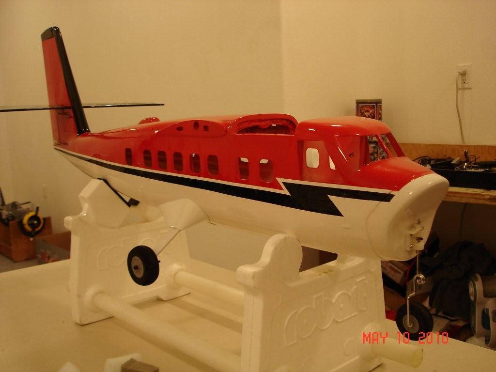

I purchased an ESM (ever soaring models), twin otter recently. I believe this model is discontinued, and I have no instructions with it. I'm hoping someone can help me with the battery placement, motors and batteries used, prop sizes etc. This is a very pretty aircraft in black and red. It's 62" span and about 6lbs. Fiberglass fuse with built up wings. Any help will be greatly appreciated.

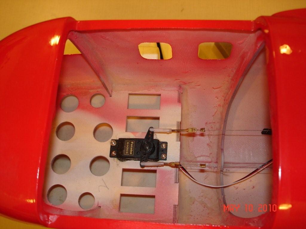

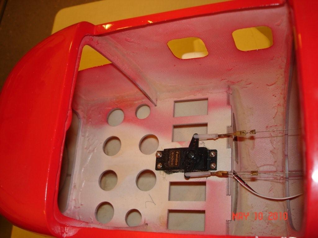

here's a couple of pics. It looks like they want me to mount the battery under the cables for the rudder. This would put it more rearward toward the cg. I believe I'm missing a few pieces from this kit - like the battery mounting tray, and a small tray for mounting the nosegear steering servo. The instructions are very vague and do mention battery placement, although the specs on the cover do mention 2 2200ma 3s packs as required equipment. I was thinking a single 4400ma pack just for ease of charging. I was hoping someone out there has this airplane and could give me tips or pics would be even better, on the interior placement of things. Thanks.

I have built two and they are great planes. The first one suffered a solid encounter but only damaged the fuse and nose cone. They do require a little messing about when building but they are rock solid.
I'm running two E-flite power 10s with 9x7 three bladers and a 3S 3600 that gives me about 10 min airtime. This time I added some nav lights but left the cockpit detail out. I just built a little cradle for the battery and used a velcro strap to hod in in along with some foam to locate the battery fore and aft.
