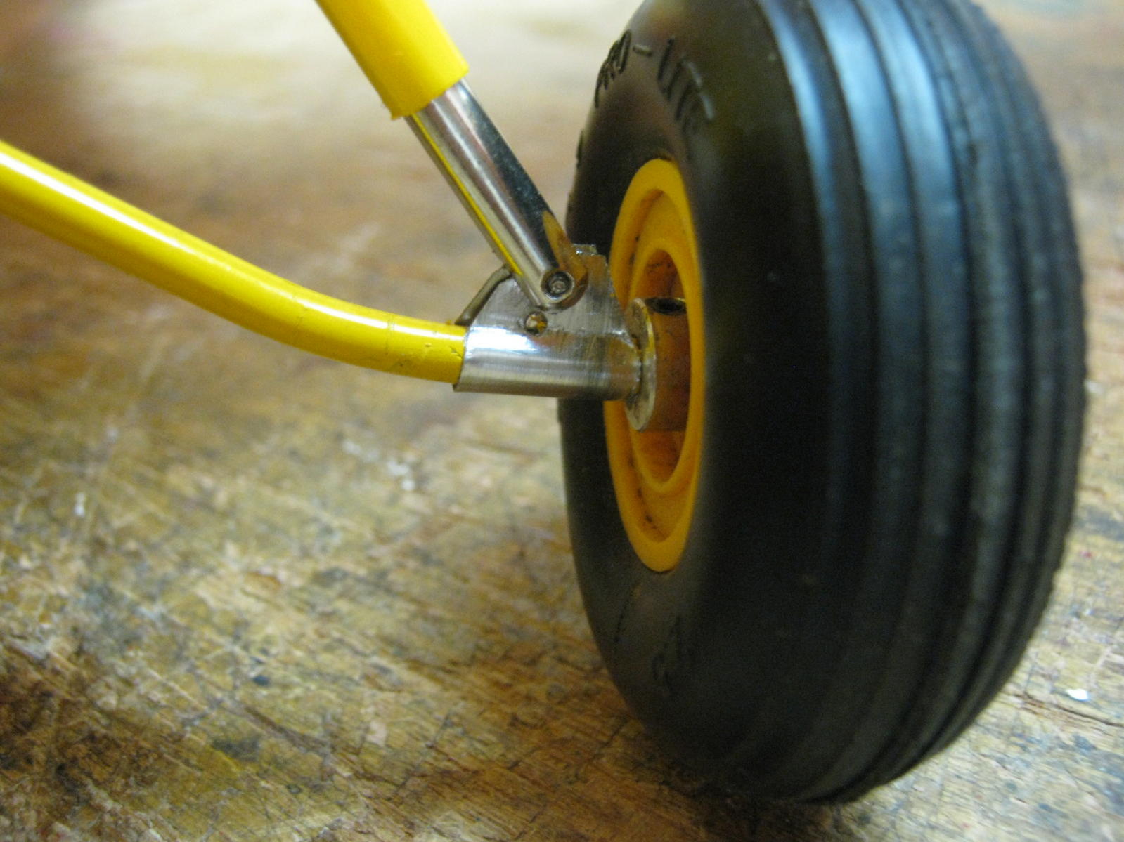

rafeeki 01-02-2014 08:01 PM
1 Attachment(s)
This is a custom spring landing gear I concocted for my 1/5 scale cub. I might have to revert to a similar arrangement for the Moth.
Rafeek

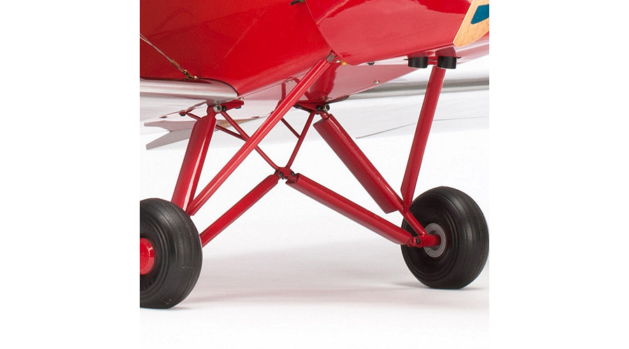

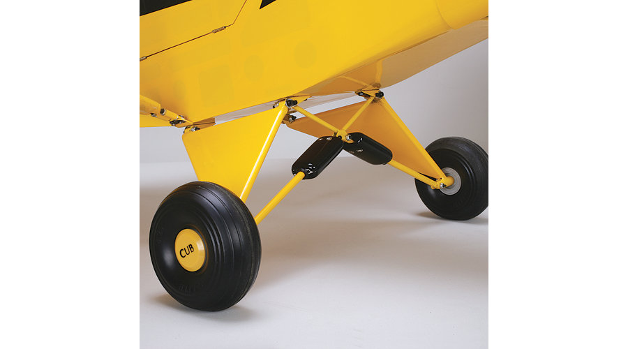

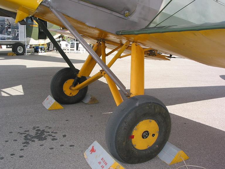

dgliderguy 01-02-2014 11:35 PM
4 Attachment(s)
Kochj, I don't have my Cub handy right now (it's out in the storage shed), but here's a file pic of the Cub gear. The covers on the diagonal struts conceal two tension coil springs, that retains the two-piece sections of the diagonals under tension when the gear articulates. On the Tiger Moth, the faired portion of the vertical struts would conceal a compression spring, with a telescoping strut that is held at full extension by the spring in flight. The spring then provides shock absorption during landing. The E-flite Aeronca Champ 15e had this type of compression spring gear, and it worked really great. You could really feel it on landing, as the struts compressed and the gear legs splayed slightly outward. You can make something like this out of steel tubing, if you happen to have oxyacetylene equipment handy.

rafeeki 01-03-2014 05:58 AM
Brilliant comparison.

farmerric 01-03-2014 07:33 AM
Rafeeki
I like the arrangement you have for the gear on the Cub. If I am reading the photo correctly, the springs are in compression when loaded, not tension. That makes a huge difference in the operation. I have a Dave Patrick Super Cub where the springs stretch in tension under load. One or two hard landings and they take a permanent set due to overstretch. I now use stretched O rings for the spring, and they last a while longer. I plan to make a similar arrangement to yours on a Rascal 110 I am working on
Ric
rafeeki 01-03-2014 07:51 AM
Its worked really well. It ceratinly puts a limit to how much the landing gear may spread after that first or second bounce. Note that when I put it in under some compression to eliminate any slop. It is a very inexpensive way of dealing with the problem. I picked up few springs from Lowes and am playing with the idea for the Moth.
I also covered the springs with a heat shrink tube used in el. work. Hit it with the hair dryer after I positioned it. Keeps the springs clean of exhaust fuel. You can see them in the pic not already slid in place.
