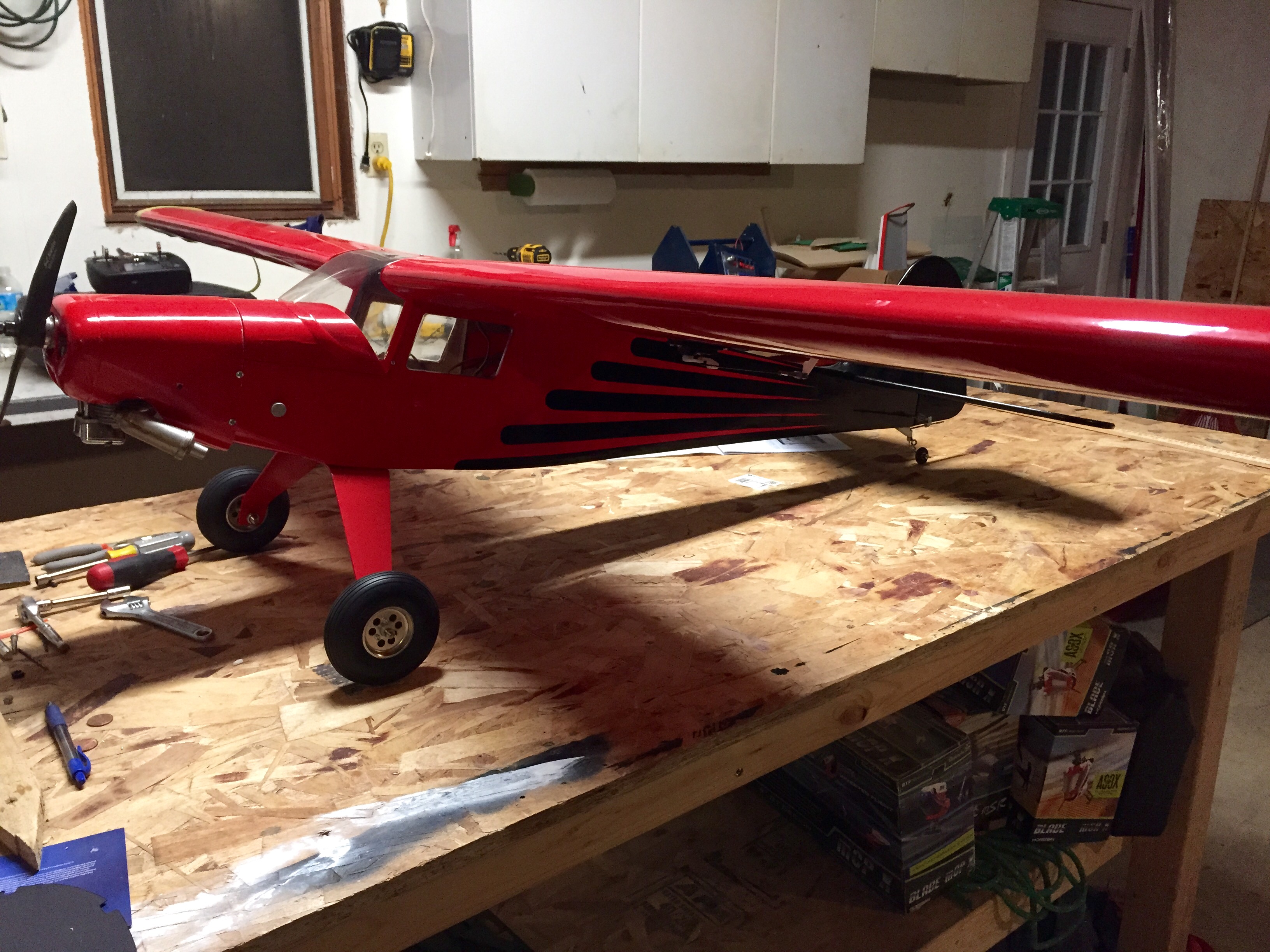

Got the FA-72 mounted...LOVE the look and sound. Got it to balance w/o adding weight by putting the battery 1/2 way to the rudder. Had to enlist my son's smaller arms... Flew it for a minute the other night but it was too windy..I know, I should have waited. Can't wait for the wind to die down next week so I can see how this thing really flies.
AK-DMK 04-02-2015 06:35 PM
1 Attachment(s)
http://www.rcuniverse.com/forum/atta...mentid=2085946I'm not a fan of wheel pants, so they had to go...it's just my preference. 4" Sullivan aluminum wheels...Much better!
acdii 04-02-2015 06:36 PM
Awesome. Thats the same thing I did to balance mine, except I cut out the bottom covering so I could glue in a mount to strap the pack to. I got some H9 covering to match and then sealed the opening. My FG-11, though smaller, once the module is added probably weighs in the same as your FA-72, so perfect match. What prop are you running? I put an APC on mine, but dont remember the diameter or pitch. Can't wait until June to see how many show up at the fly in.
AK-DMK 04-02-2015 06:48 PM
1 Attachment(s)
I'm running a Master Airscrew S-2 in 14x6...Lots of torque but not too much speed. The plane doesn't need speed. Here's a pic with the wing on and the new wheels. I think they're a nice fit.http://www.rcuniverse.com/forum/atta...mentid=2085954
