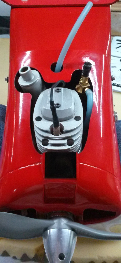

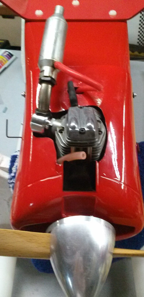

Here is the OS-70 mounted in my friends T-clips and the Laser 70 mounted in mine. Have not balanced them yet but using a quick finger test they seem to be nose heavy. I will put them on the Vanessa to get an accurate reading.
http://www.rcuniverse.com/forum/atta...mentid=2098447 http://www.rcuniverse.com/forum/atta...mentid=2098448

I still have reservations about mounting my O-70 inverted. Can you let me know how it performs inverted. I do no like dead sticks. Other than the cosmetics could you mount the engine upright? Thank you. Todd

thebluemax 05-26-2015 06:48 AM
It should run ok as we have remote glow on it. It is tied into the transmitter to light the glow plug any time at middle to low throttle if needed. But due to work schedules and family medical issues I am not sure when the maiden will be but I can let you know when we do.
You can side mount the engine if you are concerned about mounting it inverted. According to the manual, the engine mount should not be a problem. However you may have to raise the fuel tank to be even with the centerline of the carb as the fuel tank as well as the hole in the firewall for the fuel lines is low in the bottom of the fuse.
