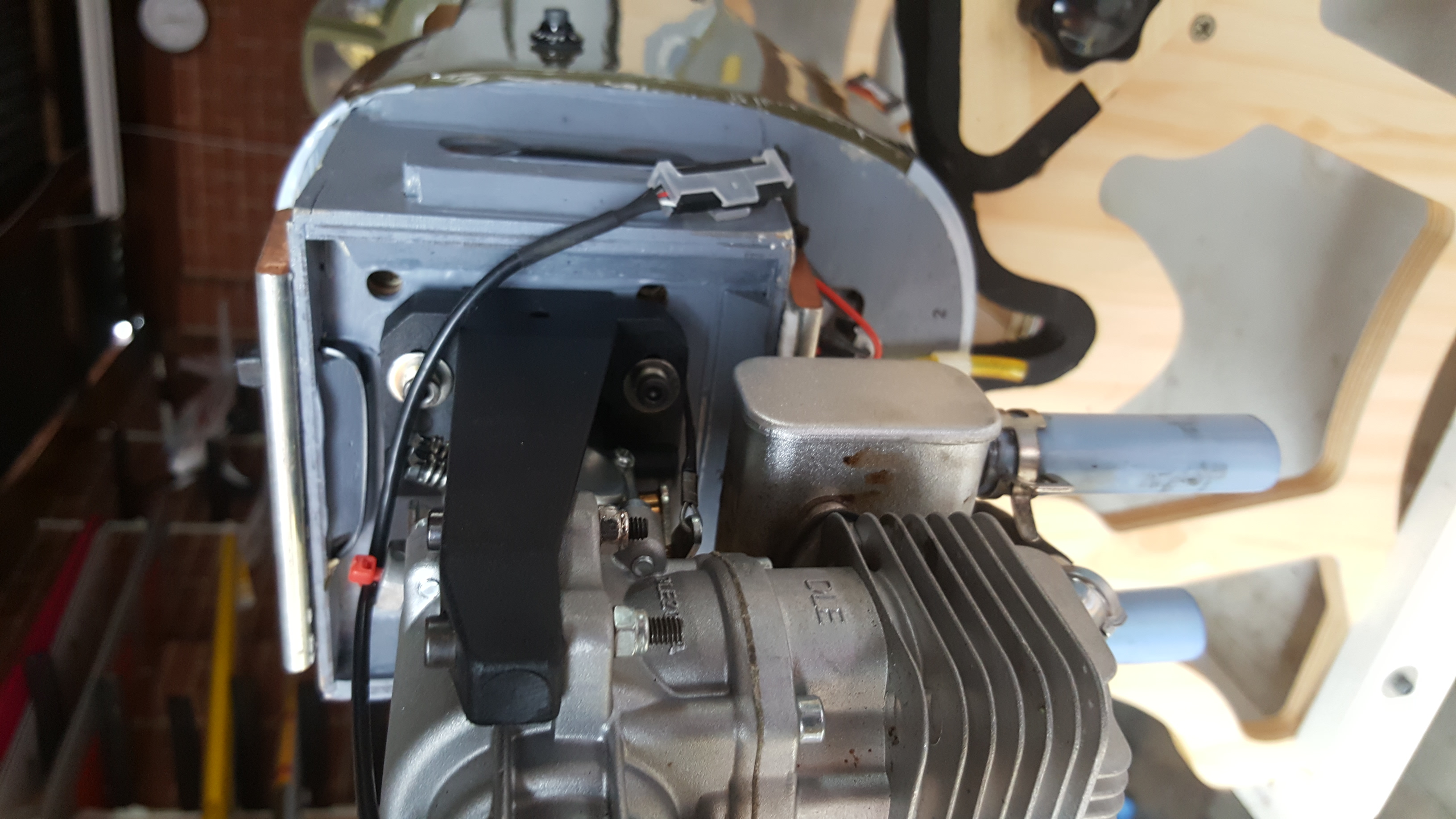

I found the firewall already had 5mm blind nuts installed that fit the EME-35 perfectly. Will also work with a DLE-30. The stand offs for the EME-35 use a 5mm cap screw thru the firewall to the stand-off. I wanted to use the 5mm blind nuts that where already installed so I install 5mm bolts into the stand-offs and cut the head of the bolt off. I then installed them to the firewall and I had to use some 3/8 plywood to extend the engine out to get the 6.5"(165mm) need for the prop hub distance. You can see in the last pic there is down trust configured into the firewall. Here are some pics that show how I did this:)

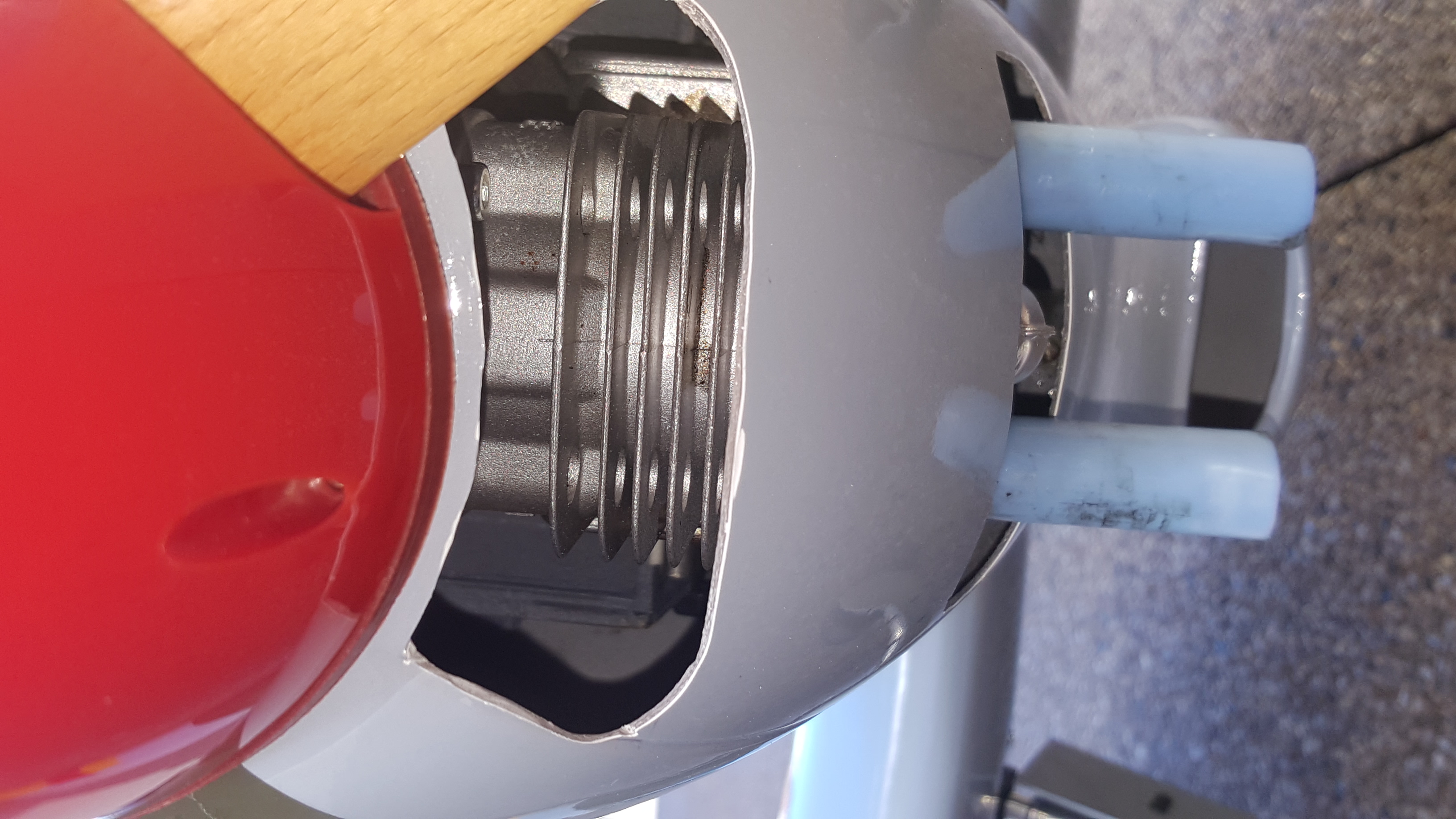

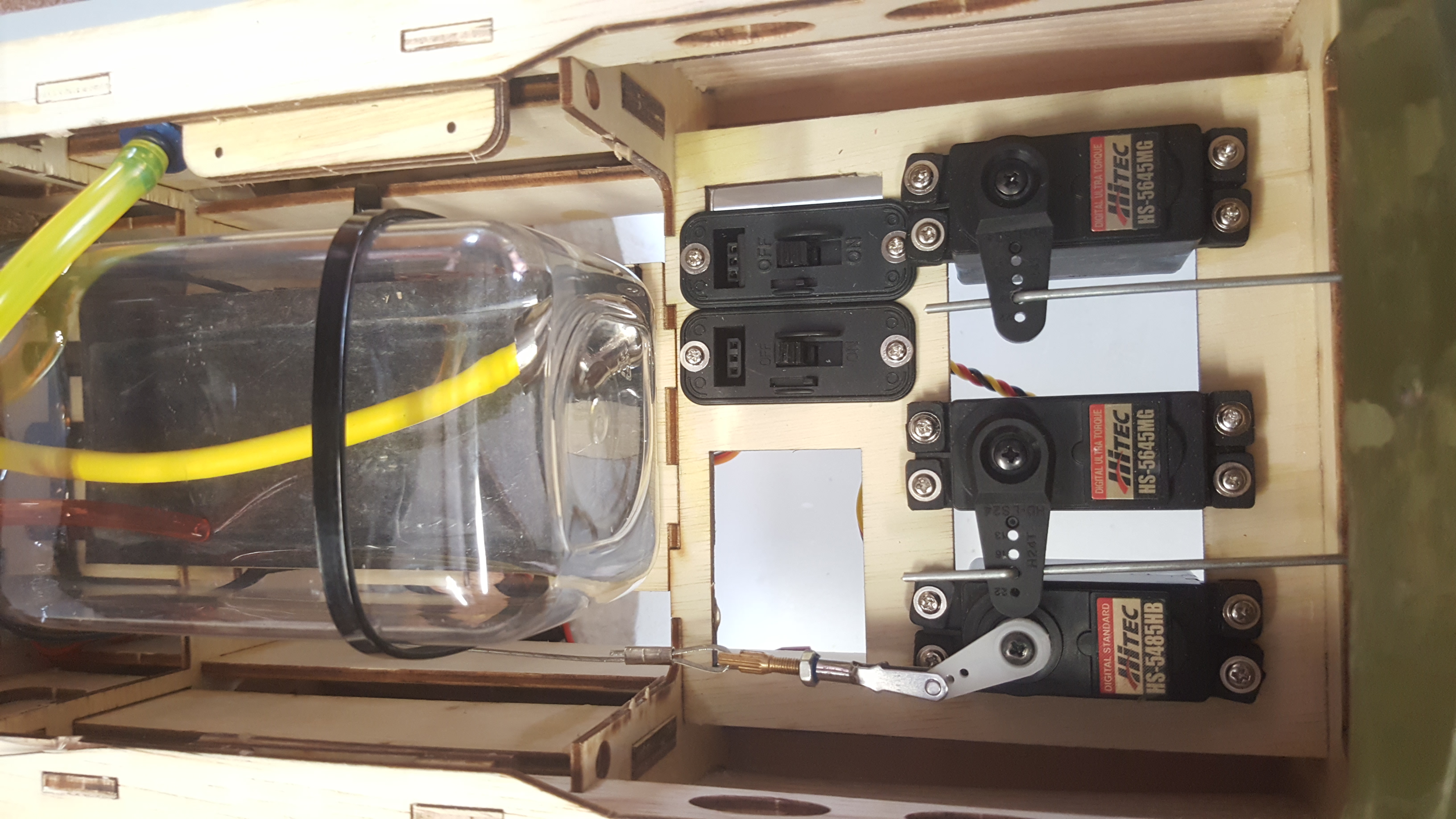

I have the cowl fitted to the fuselage now. The EME-35 fit in the cowl very easily. Here are a few pics of the cowl :)nd the elevator servo setup.

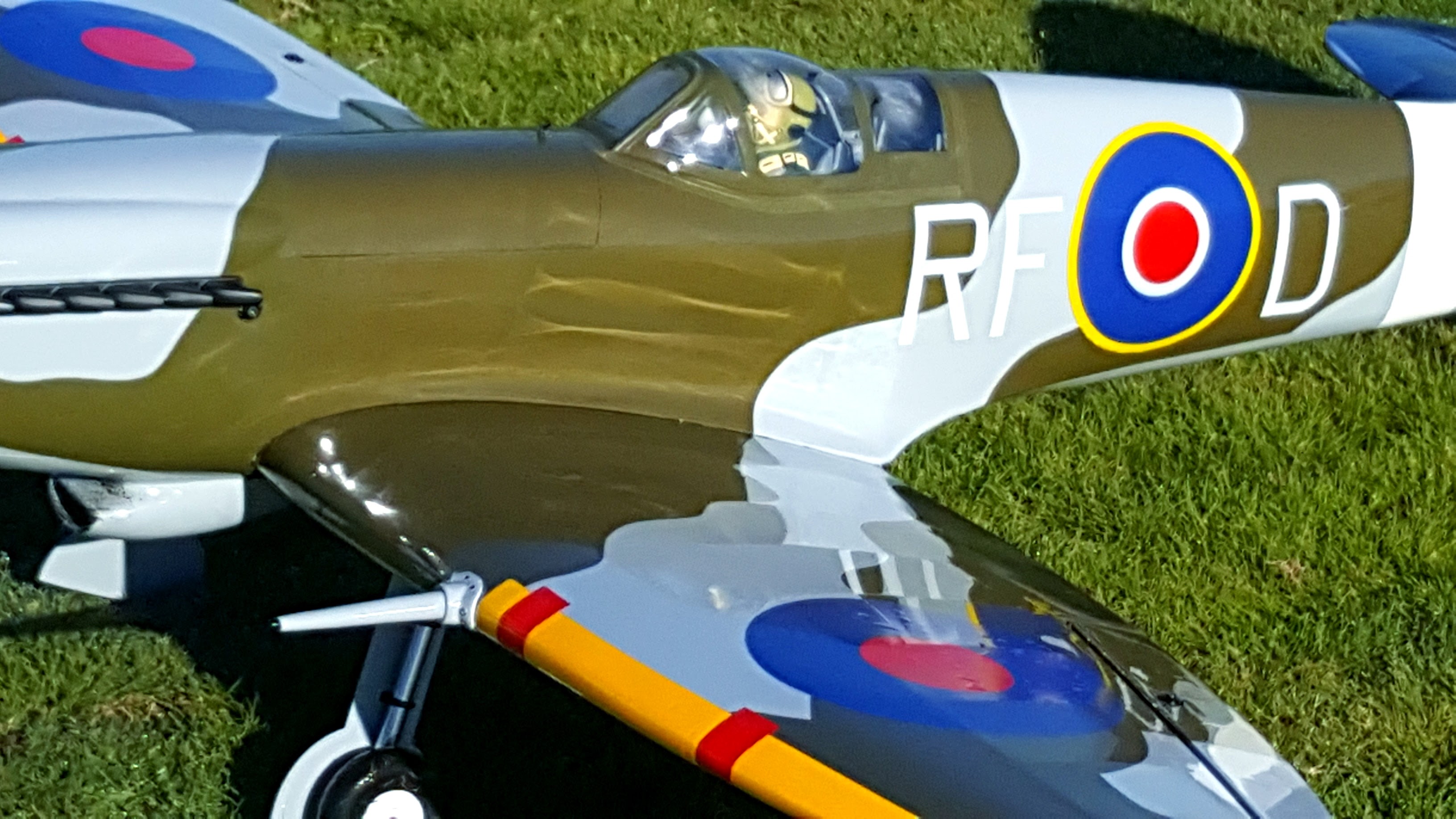

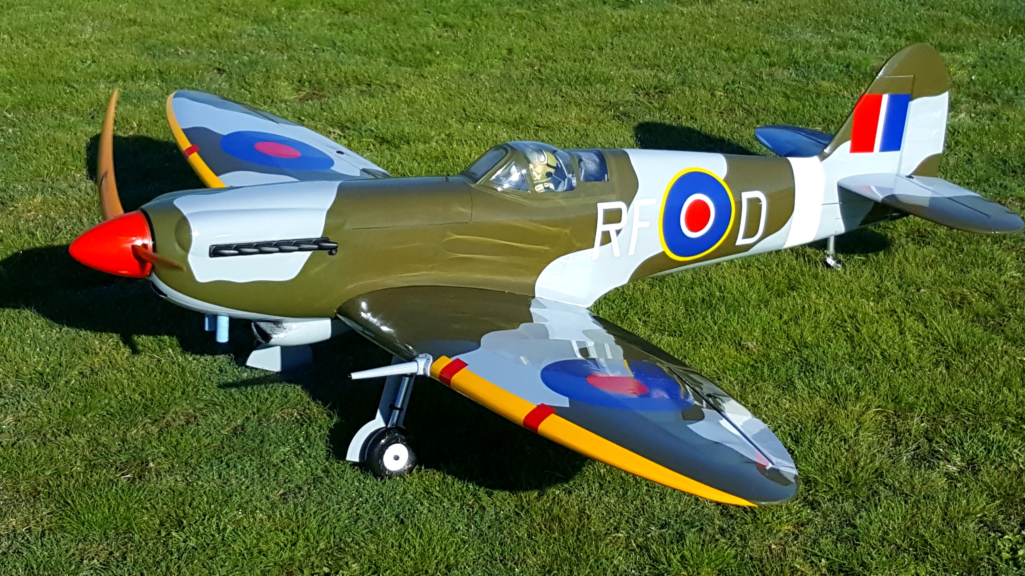

I just saw this thread, so apologises for a late reply. I have just finished assembling and flying this Spitfire for a review in our Australian magazine Airborne. It's a nice little war-bird, went together easily and flies perfectly on the DLE 20RA. Like you, I thought that 30cc was too much for it. I used the AM electric retracts which slotted straight in. Very little weight needed in the front and finished flying weight was around 6.2kg.
jstanton 06-04-2017 01:39 PM
6 Attachment(s)
Very nice looking Spitfire and glad to here is fly's well om a 20cc engine. I just finished mine today and I hope to maiden her next weekend. I did not have a 20cc engine but I did have the EME-35 that is the same weight as the DLE-30 I had to add 4 oz of weigh to the nose the get the plane to balance. I am using a Xoar 18x10 prop that should provided plenty of speed. Here are a few pics:)
