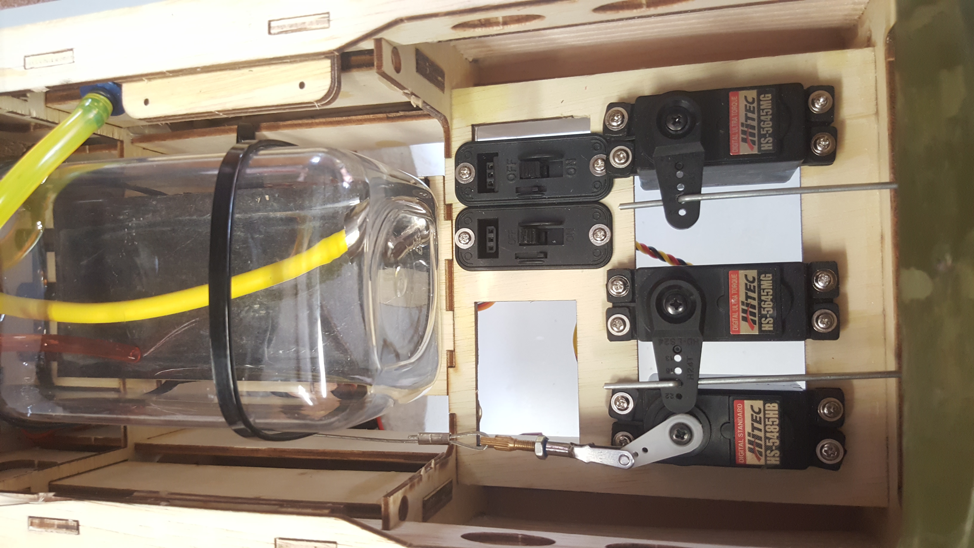

I am just finishing up on mine. Not a bad plane but has a few shortcomings. The furnished metal push rods and most bolts are JUNK, very soft low grade. Figure on replacing all of that right off. I went to the Sporting goods store and purchased coated metal braided line to use for the Rudder control cables, 35 lb. rated very easy to work with and I can trust it. Just a few bucks for 35 feet.
I purchased Hitec landing gear Servos but did not enjoy setting up the gear. Had to remove some wood to mount the servos and the furnished push-rods bent right off, replaced those with good stuff. In retrospect I think the Hobby King retracts would have been a better choice, no external servos and cost about the same as the servos I used.

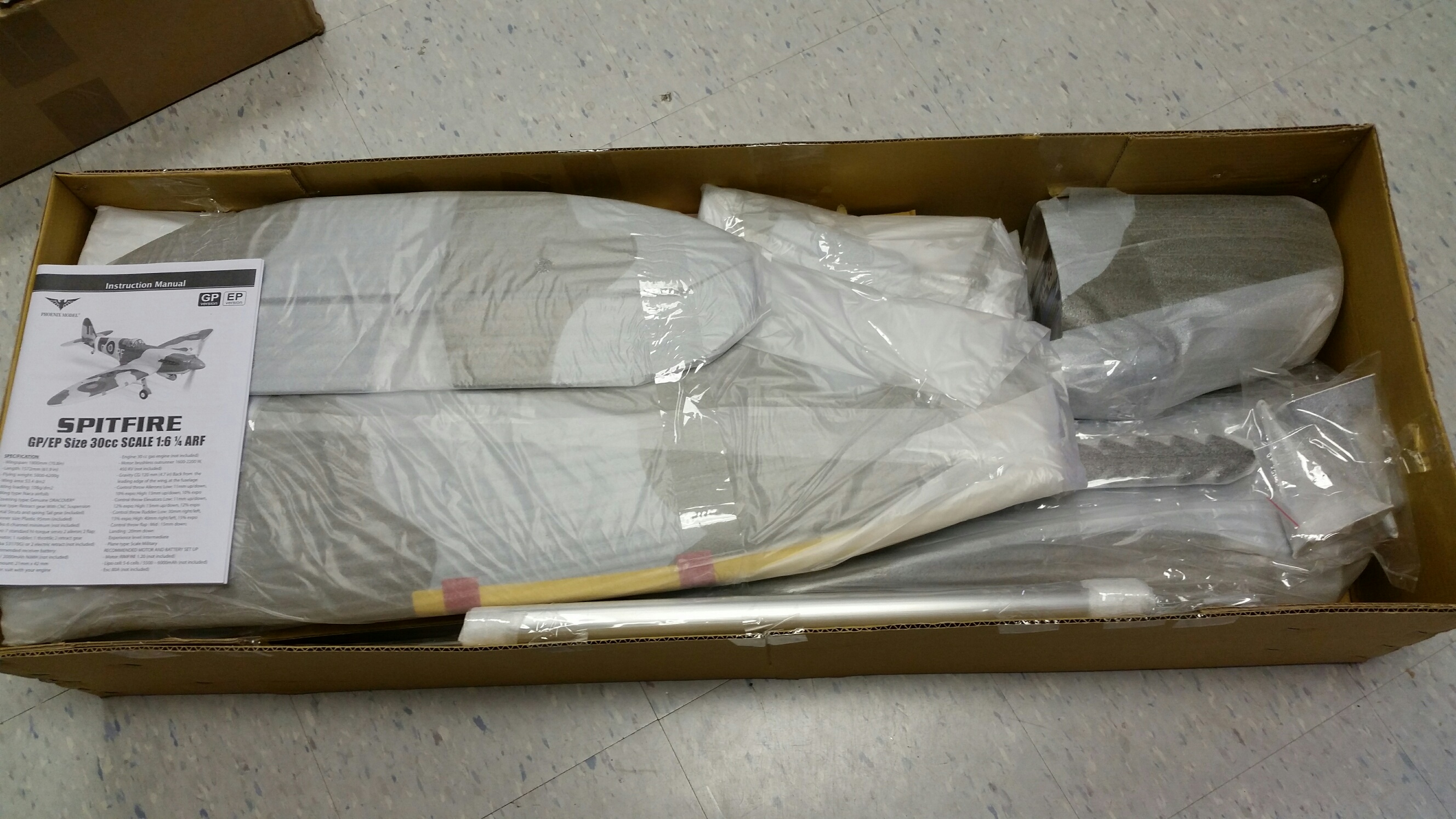

Well the Spitfire came in today. I hope to get started on it this weekend. Rain is coming so I won't be at the field flying tomorrow. Here are a couple of pics. The plane was well protected and each peace was individually wrapped.

I flew mine last week for the first time. Have a AGM 30cc gas engine with 18 - 8 prop, I used the Hitec mini servos for retract that fit the cutouts and they're pretty useless as they don't have the power to pull them both back in. Flew it gear down and plane was no problem and handled really nice. Weak point is the gear which I'm sure will promptly collapse with anything but a feather lite landing. I have the HK heavier electric retracts which I'm sure will be an improvement but haven't put on as I haven't figured out the struts yet. I thought the plane was a pretty quality ARF otherwise and it looks really good when completed.

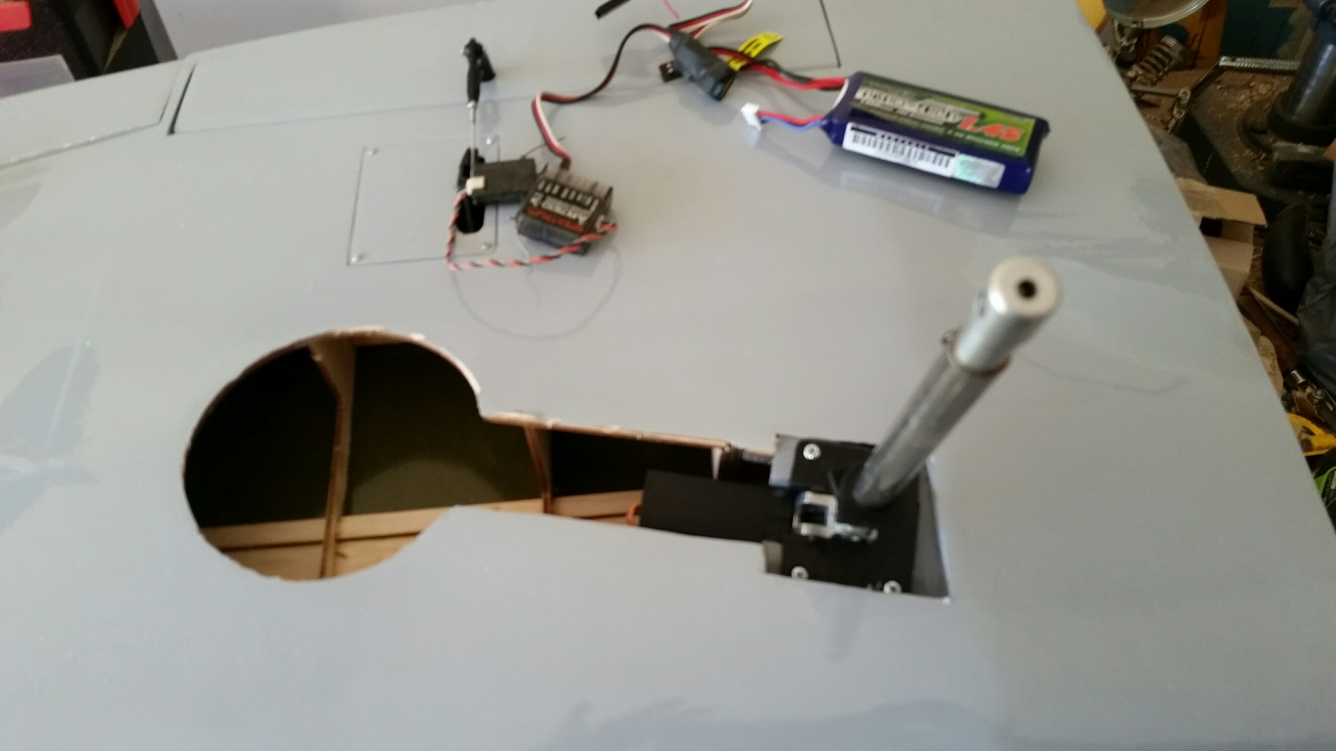

The HK HD servoless retracts fit this plane just fine and the struts that come with the Spitfire work on the HK retacts. I have posted some pics and a short video of them working. I also installed a retracts delay switch so the look a little more realistic

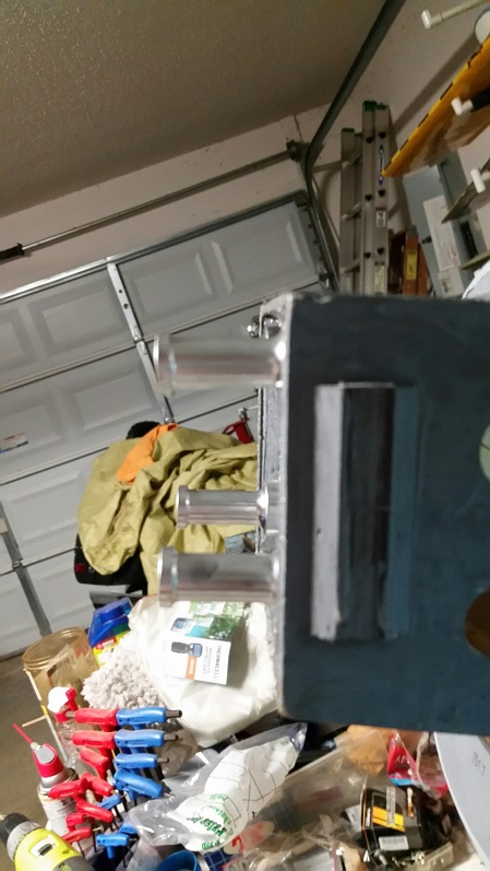

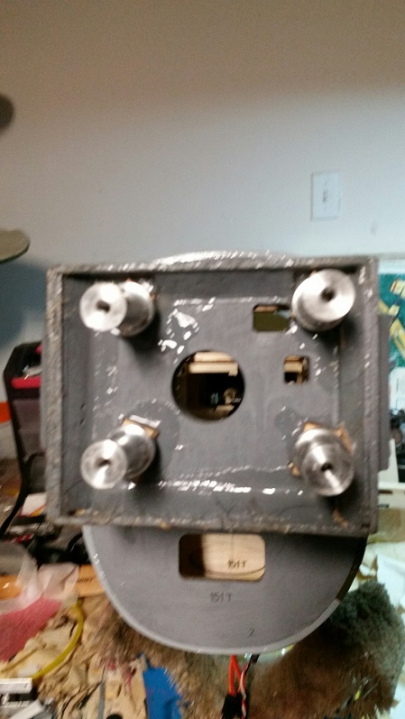

Old 05-12-2017 | 06:04 PM
jstanton's Avatar
My Feedback: (14)
Joined: Aug 2002
Posts: 3,257
Received 26 Likes on 26 Posts
From: Millington, TN

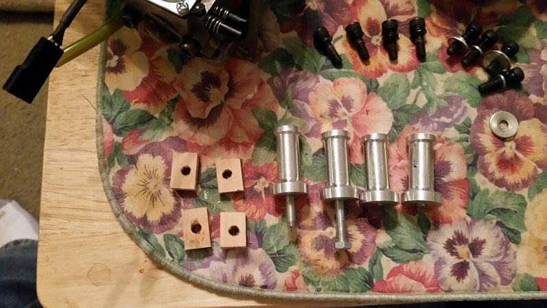

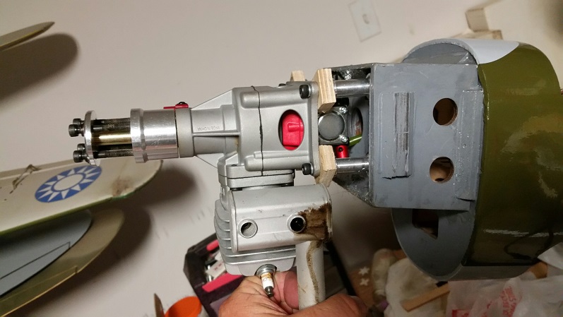

Default eme 35 installation

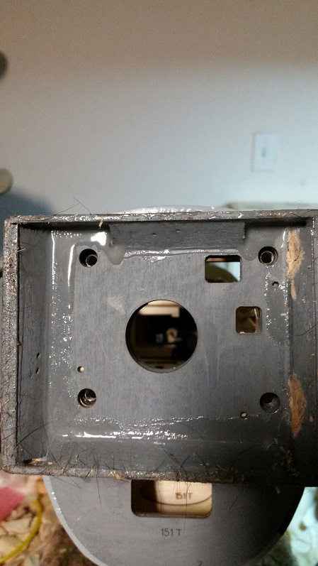

I found the firewall already had 5mm blind nuts installed that fit the EME-35 perfectly. Will also work with a DLE-30. The stand offs for the EME-35 use a 5mm cap screw thru the firewall to the stand-off. I wanted to use the 5mm blind nuts that where already installed so I install 5mm bolts into the stand-offs and cut the head of the bolt off. I then installed them to the firewall and I had to use some 3/8 plywood to extend the engine out to get the 6.5"(165mm) need for the prop hub distance. You can see in the last pic there is down trust configured into the firewall. Here are some pics that show how I did this

Default Cowl
I have the cowl fitted to the fuselage now. The EME-35 fit in the cowl very easily. Here are a few pics of the cowl nd the elevator servo setup.

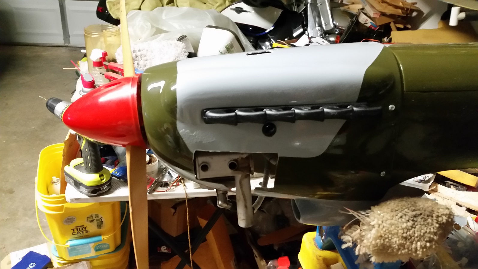

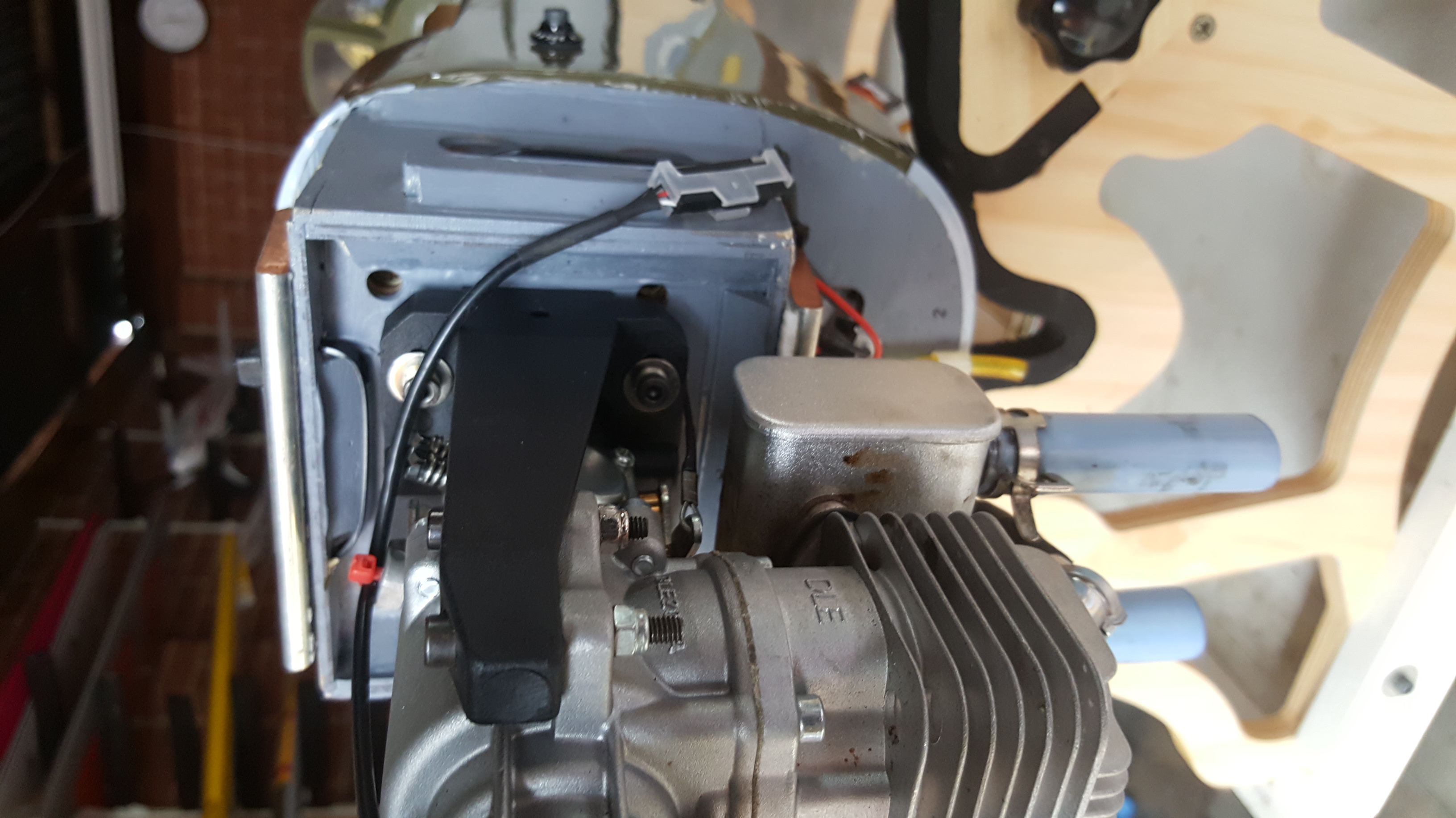

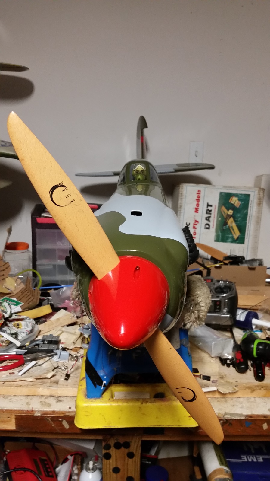

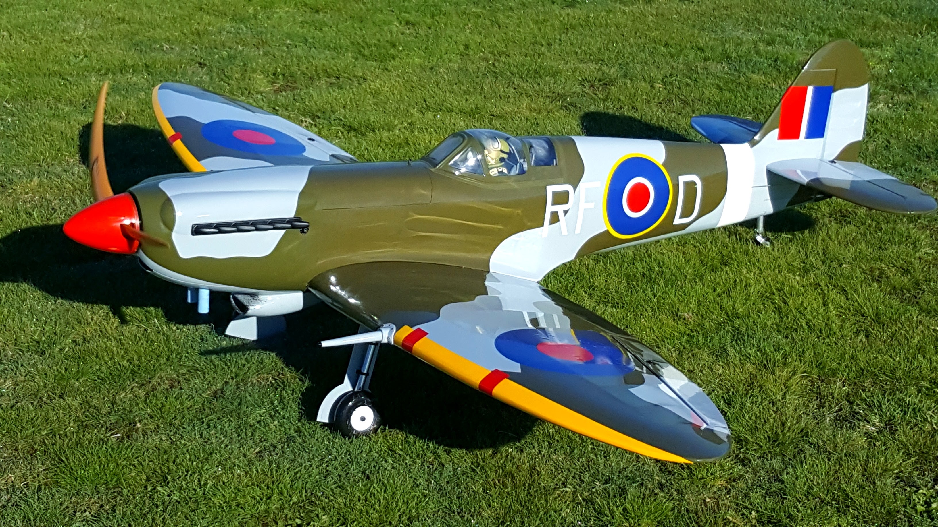

Old 05-31-2017 | 12:08 AM
Joined: Oct 2014
Posts: 4
ID:	2217955Click image for larger version
ID:	2217956Click image for larger version
ID:	2217957Click image for larger version
ID:	2217958Click image for larger version

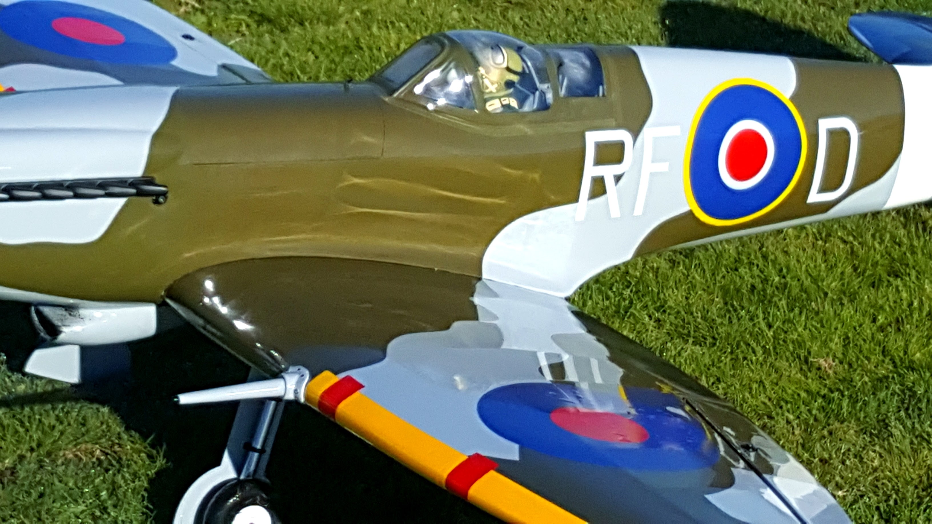

Originally Posted by jstanton
I have an EME-35 I am hoping to use on this Spitfire. I know the directions say a DLE20 to 30 can be used. This plane really seems a little small to me for a 30cc gas engine. Has anyone installed a DLE-30 into this plane? If so how do you like it? Seems a lot of power for a War Bird with just a 70" wing span. Did the factory drilled holes in the engine mount line up with a DLE 30?
I just saw this thread, so apologises for a late reply. I have just finished assembling and flying this Spitfire for a review in our Australian magazine Airborne. It's a nice little war-bird, went together easily and flies perfectly on the DLE 20RA. Like you, I thought that 30cc was too much for it. I used the AM electric retracts which slotted straight in. Very little weight needed in the front and finished flying weight was around 6.2kg.

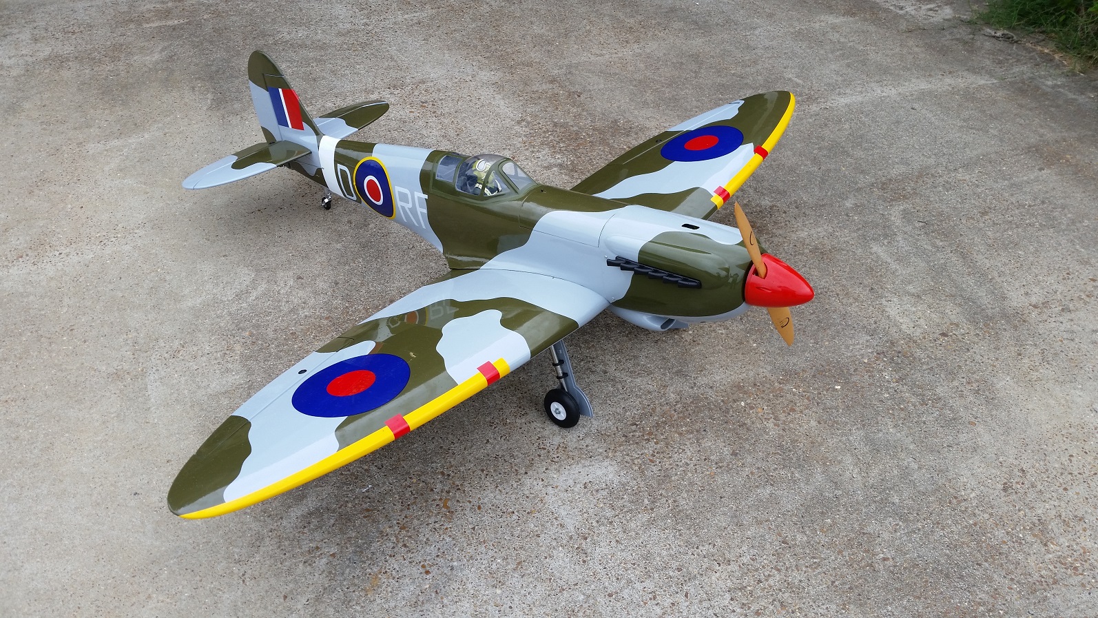

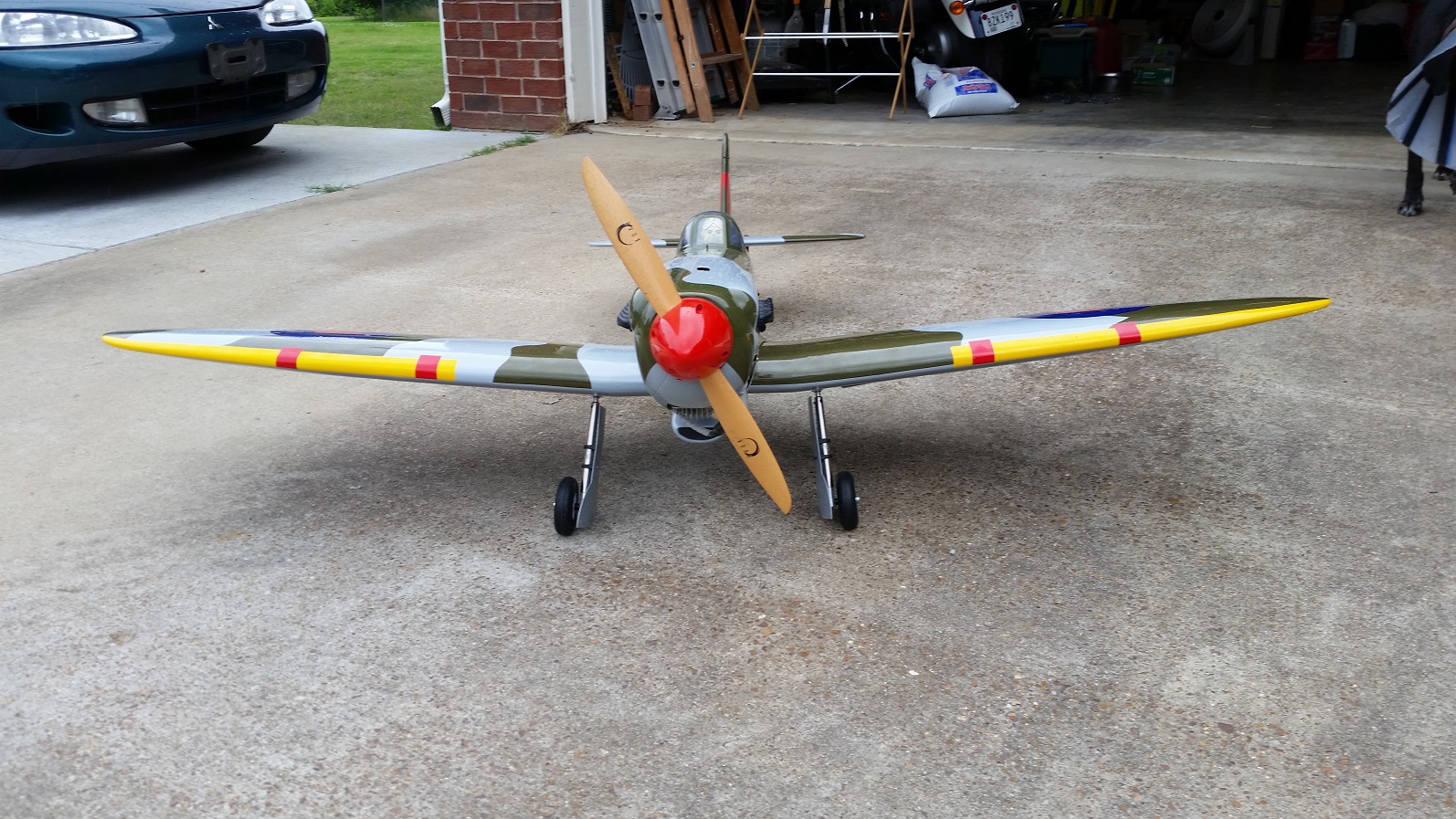

Very nice looking Spitfire and glad to here is fly's well om a 20cc engine. I just finished mine today and I hope to maiden her next weekend. I did not have a 20cc engine but I did have the EME-35 that is the same weight as the DLE-30 I had to add 4 oz of weigh to the nose the get the plane to balance. I am using a Xoar 18x10 prop that should provided plenty of speed. Here are a few pics
