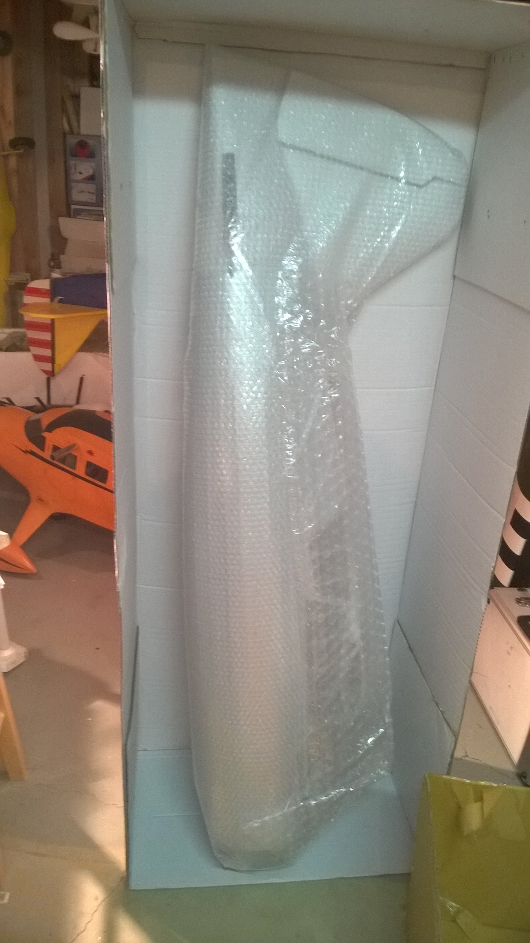

OK, it showed up.
It was an adventure getting this into my basement, as it was too long so I had to stand it on end to make it around the corner through the top door. This cause several alarming thuds to issue from inside. Box seemed to be in pretty good condition; a few dings and punctures but nothing serious.
Please excuse the clutter, bad lighting and mediocre photography.
The great unboxing...

The box - this is REALLY big. That's a meter stick on top of it. As you will see, my workshop was unprepared for this, so this will be presented in stages.

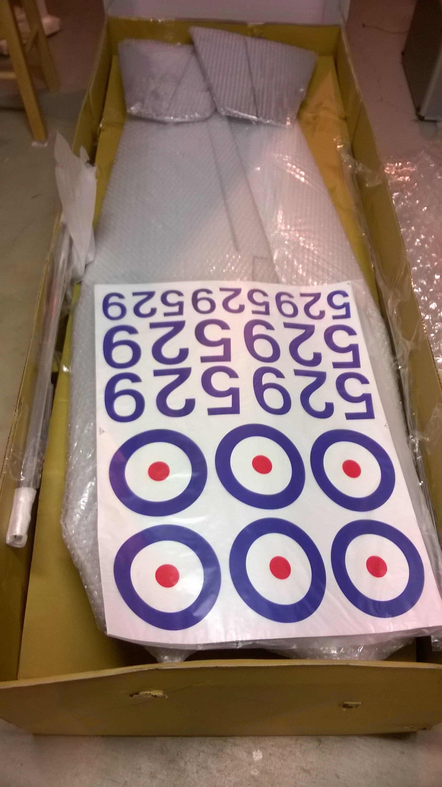

The inside. Typical Vietnamese packing job - large pieces wrapped in fairly thick bubble wrap, other parts wrapped in foam wrap, everything loosely packed and stuck together with yards of packing tape.
Attachment 2214361

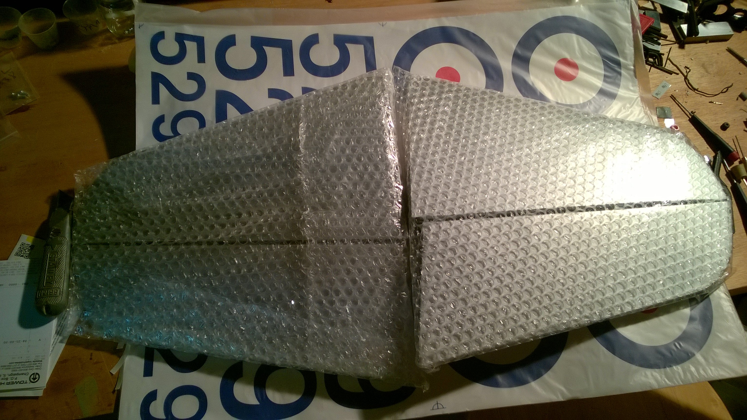

Under the tailplanes and decal sheet are the wings...
Attachment 2214362
The tail planes
Attachment 2214363

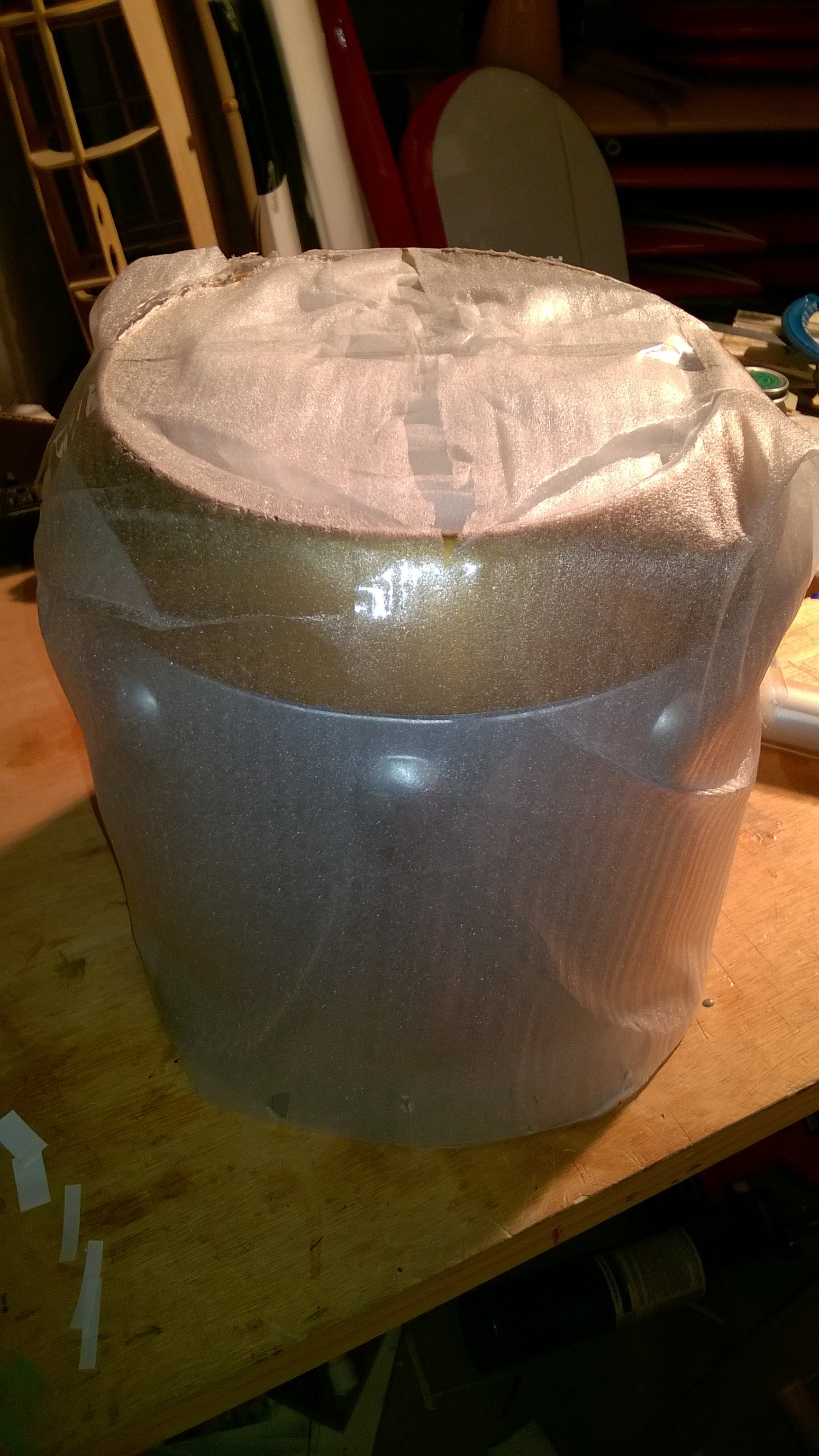

Under the main wings and the main divider we find the fuse, wheel pants and cowl...
Attachment 2214364
The cowl is closed off as a container for most of the smaller parts.

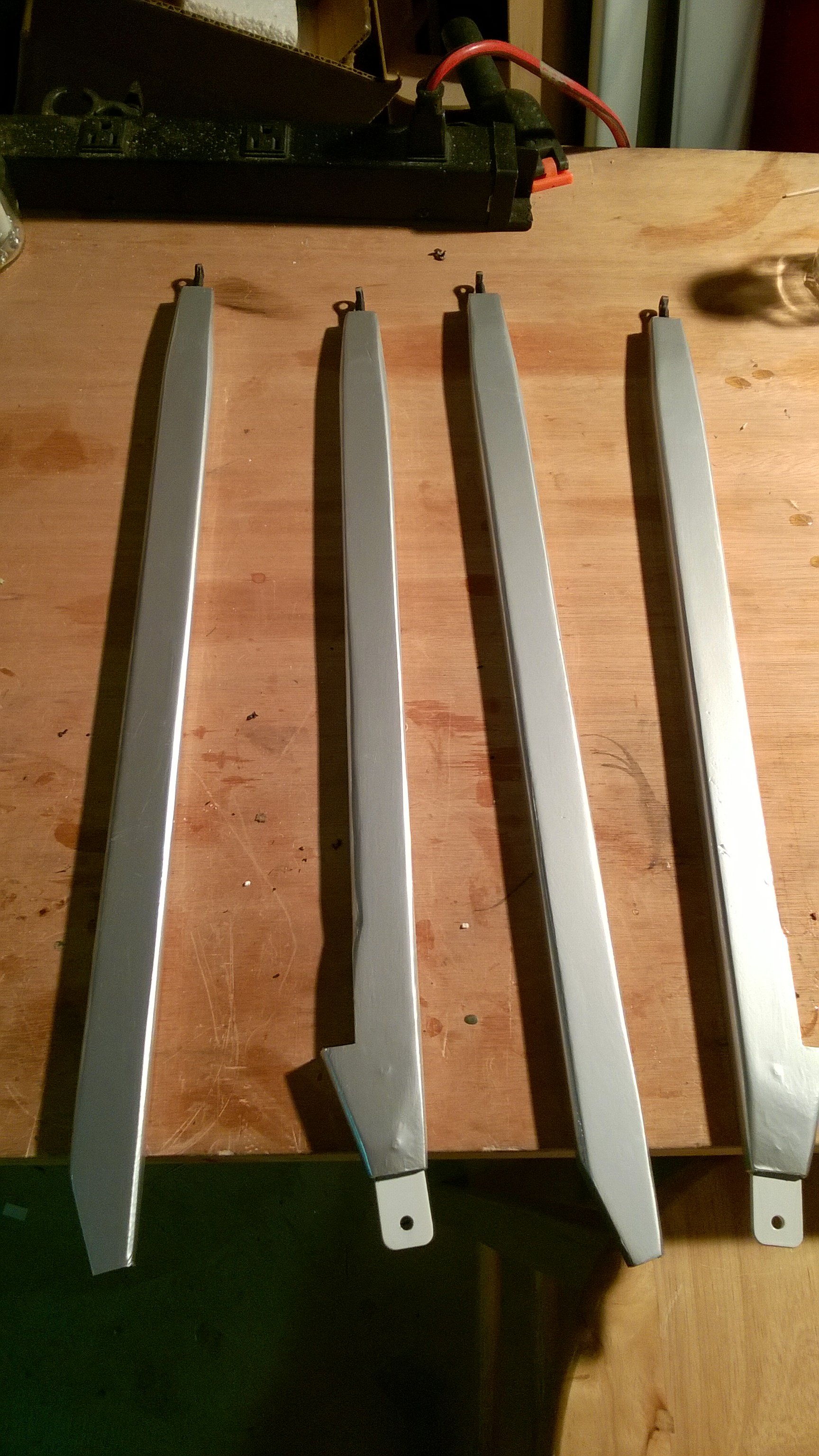

The wing struts were loose in the box, and probably the source of the loudest thuds. These are about a foot and a half long.

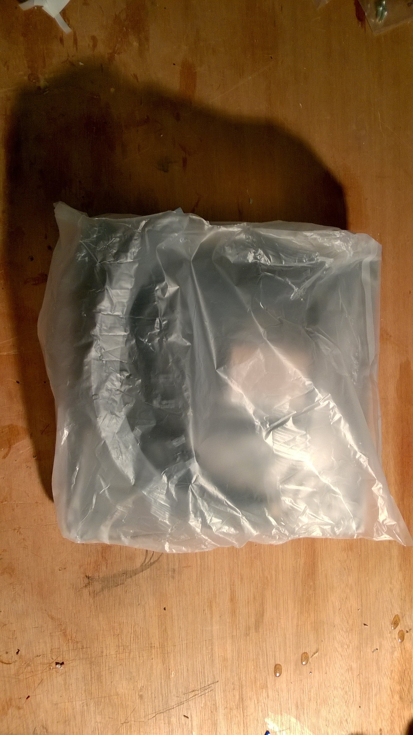

Bag containing dummy motor and misc cowl mounting hardware.
Attachment 2214368
The fuselage. OK, it would have taken me 15 minutes to clear enough bench space for this, so I just stood it up in the box top.
Attachment 2214369

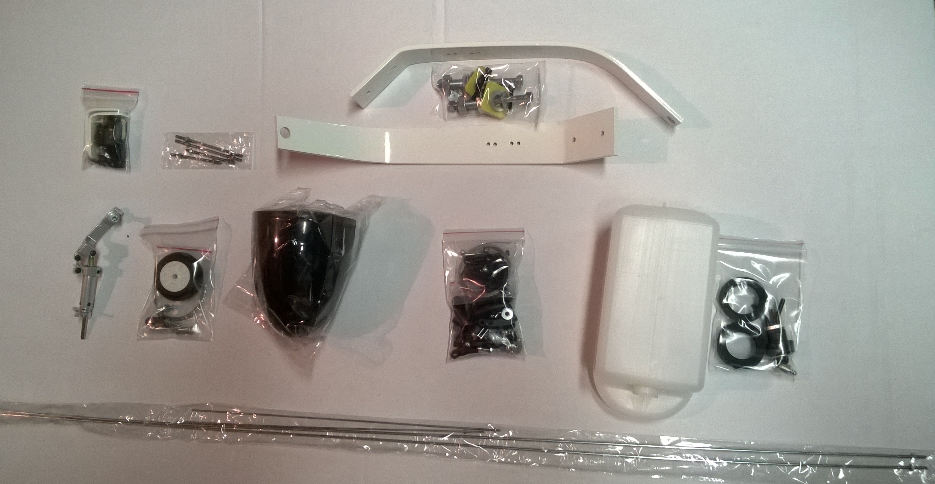

The contents of the cowl - wheels, spinner, fuel tank, and motor mount.
Attachment 2214371

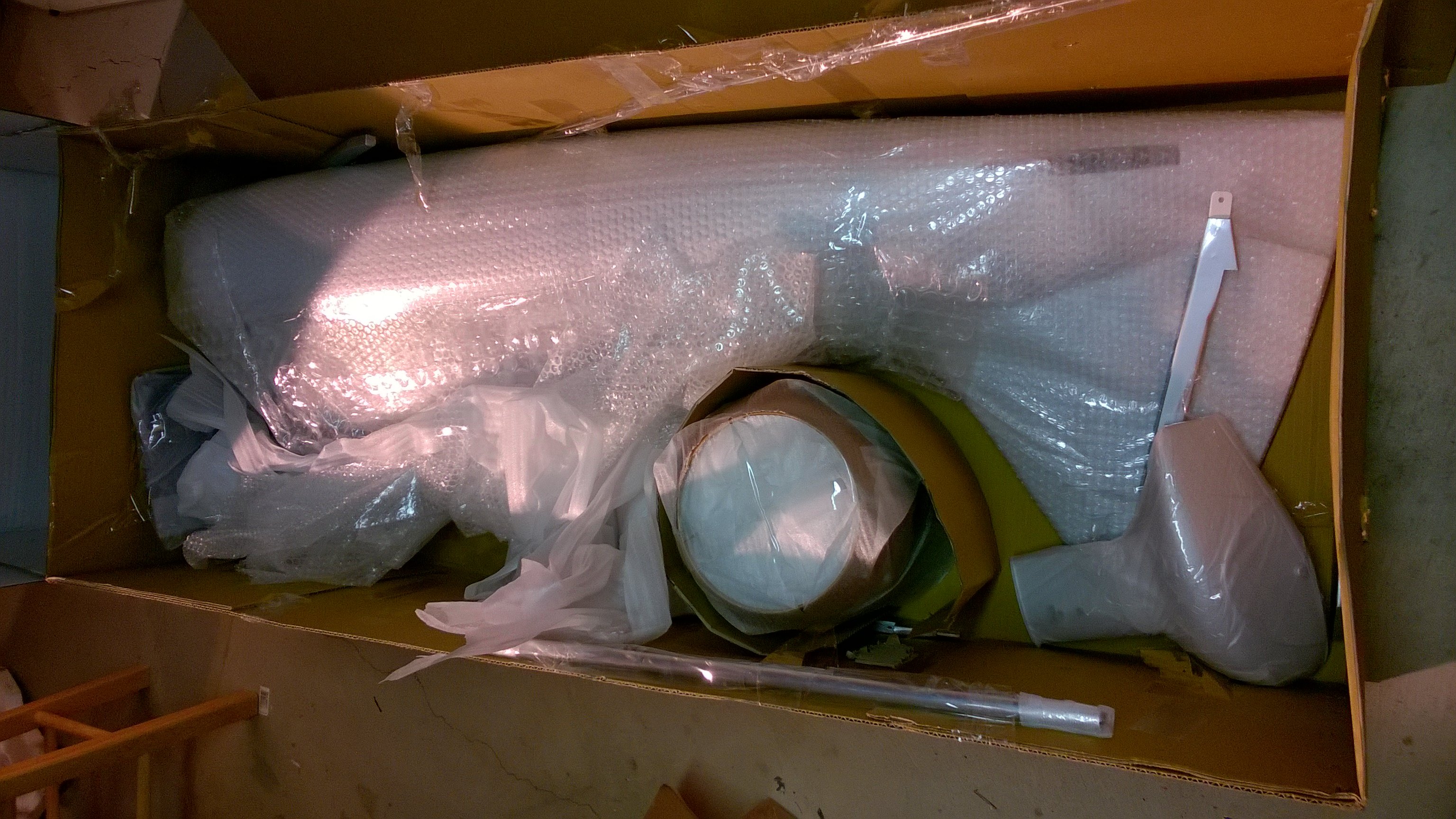

mine arrived in perfect condition. Wow - this thing is huge!

Drat, you guys beat me to it. I arrived home to find a coffin-size box at my side door, the UPS driver must have had fun getting it up the driveway. Took it in the back door and unboxed in the living room. Lots of bubble wrap and foam sheets. Found some loose bolts which turned out to be for the landing gear, one bolt and some washers missing, so off to the well-stocked hardware store. The shipping carton is shown standing next to a 6 foot fence in the photo, another "cardboard condo". Mods to the firewall begin for mounting the Zenoah G-62. More to come.

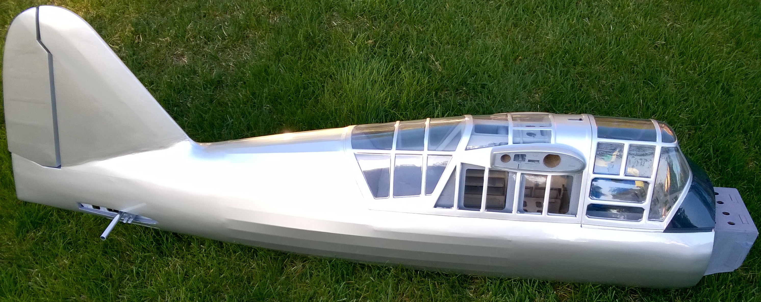

The fuselage appears to be entirely ply, balsa and sheeting, covered with Oracover. they did a really nice job of the covering. No dings or wrinkles are apparent. The cockpit is a removable hatch, that is held on by a spring loaded latch on the top. As has been said, this thing is huge...

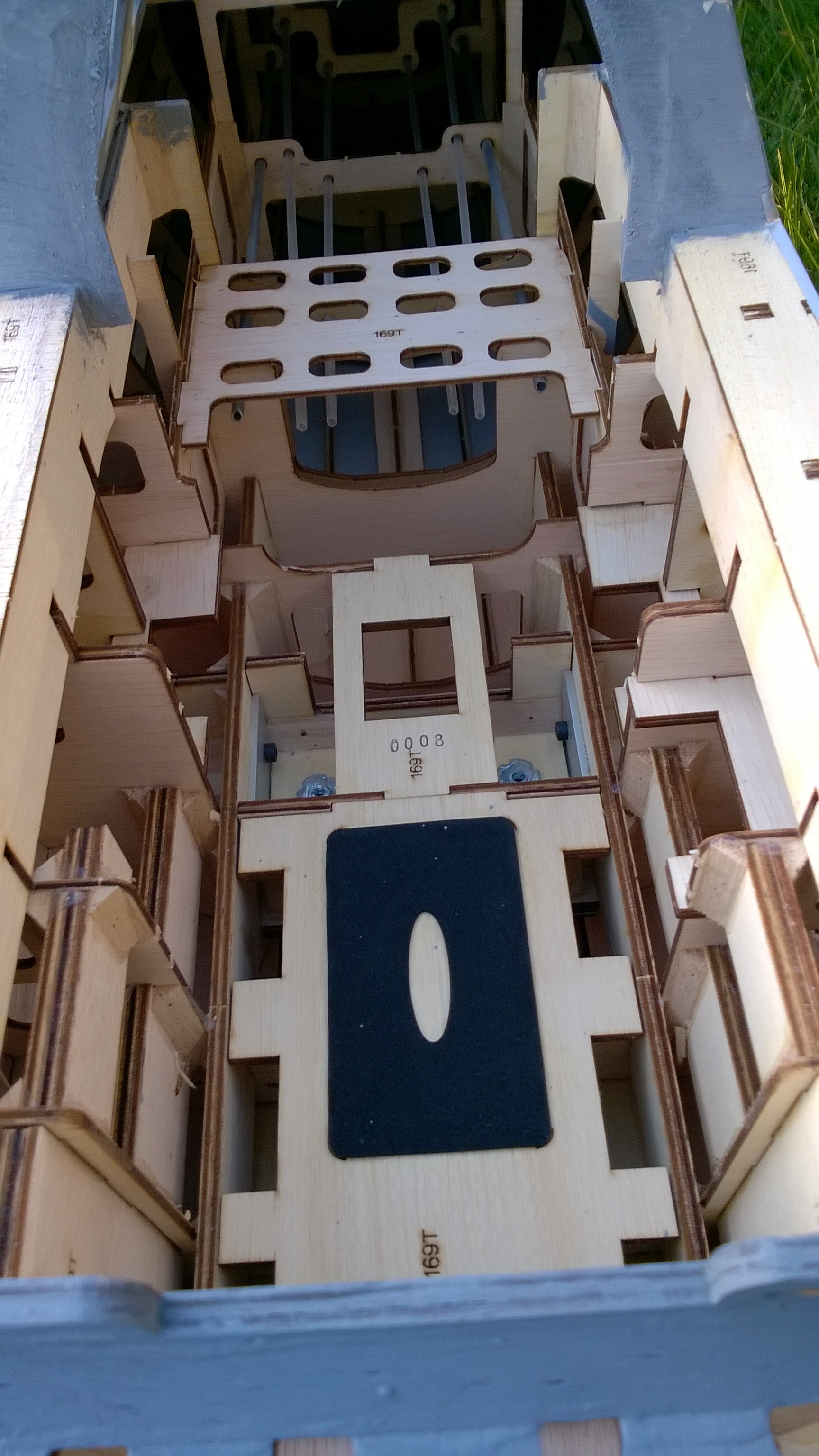

The interior is indeed cavernous.
Attachment 2214607
My big hands will fit way back in there with no problems at all.

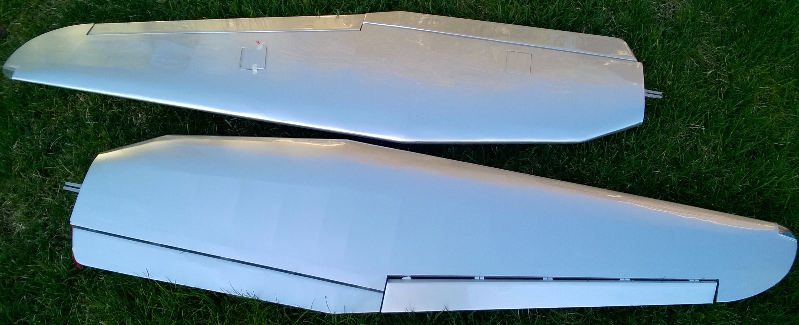

The surfboards, er, wings are also nicely covered, with no dings or wrinkles. Pull strings are threaded through to the servo hatches.
Attachment 2214609

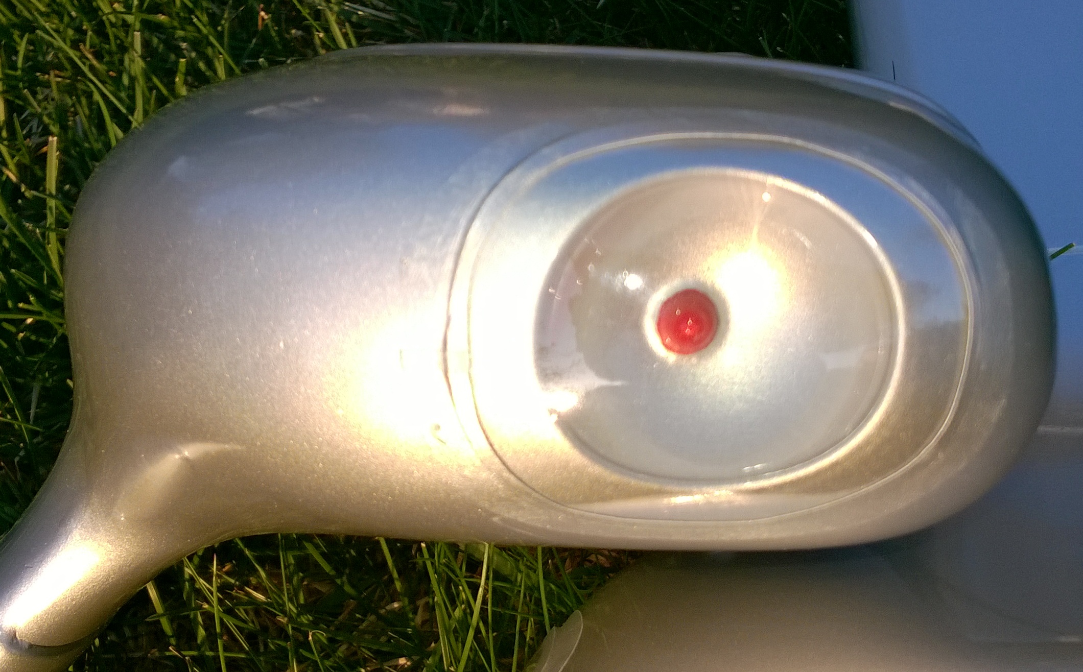

The wingtip nav lights are crying out for a lighting system. They are faked here by little painted bumps, but both sides are red.
Attachment 2214610

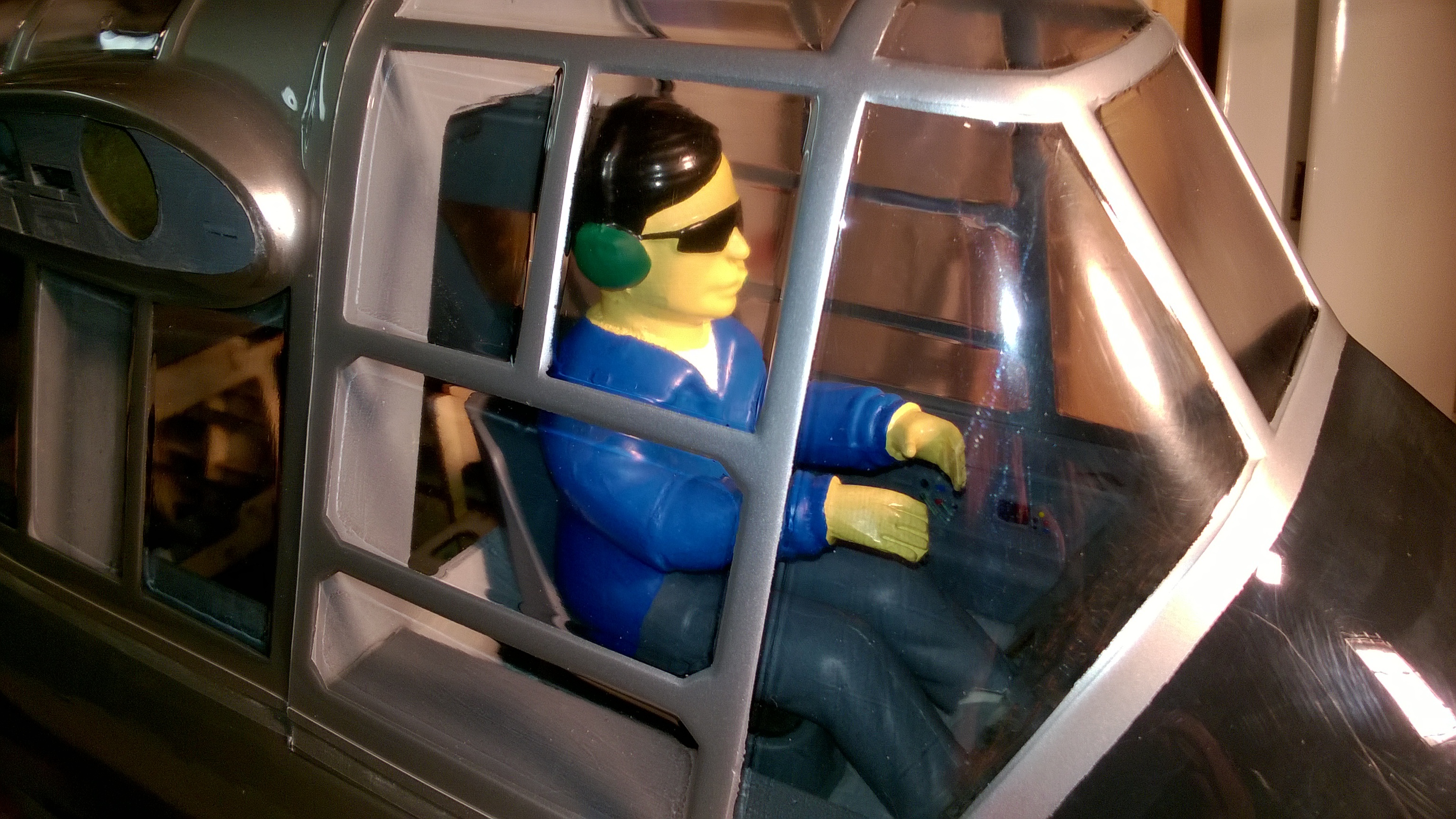

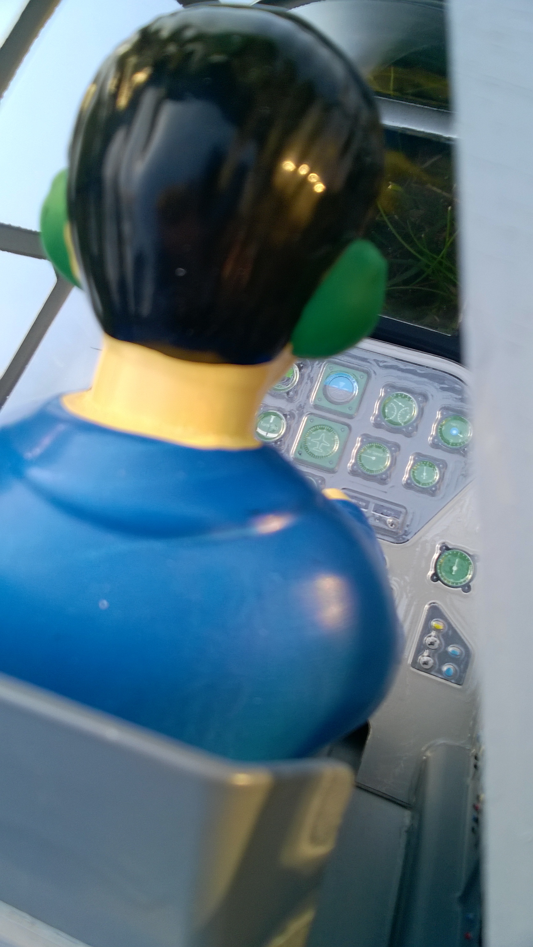

The canopy glass is pretty fuzzy. This isn't all bad as the instrumentation is not even the right colors, let alone accurate, and the pilot figure is a joke. This is the biggest disappointment for me.

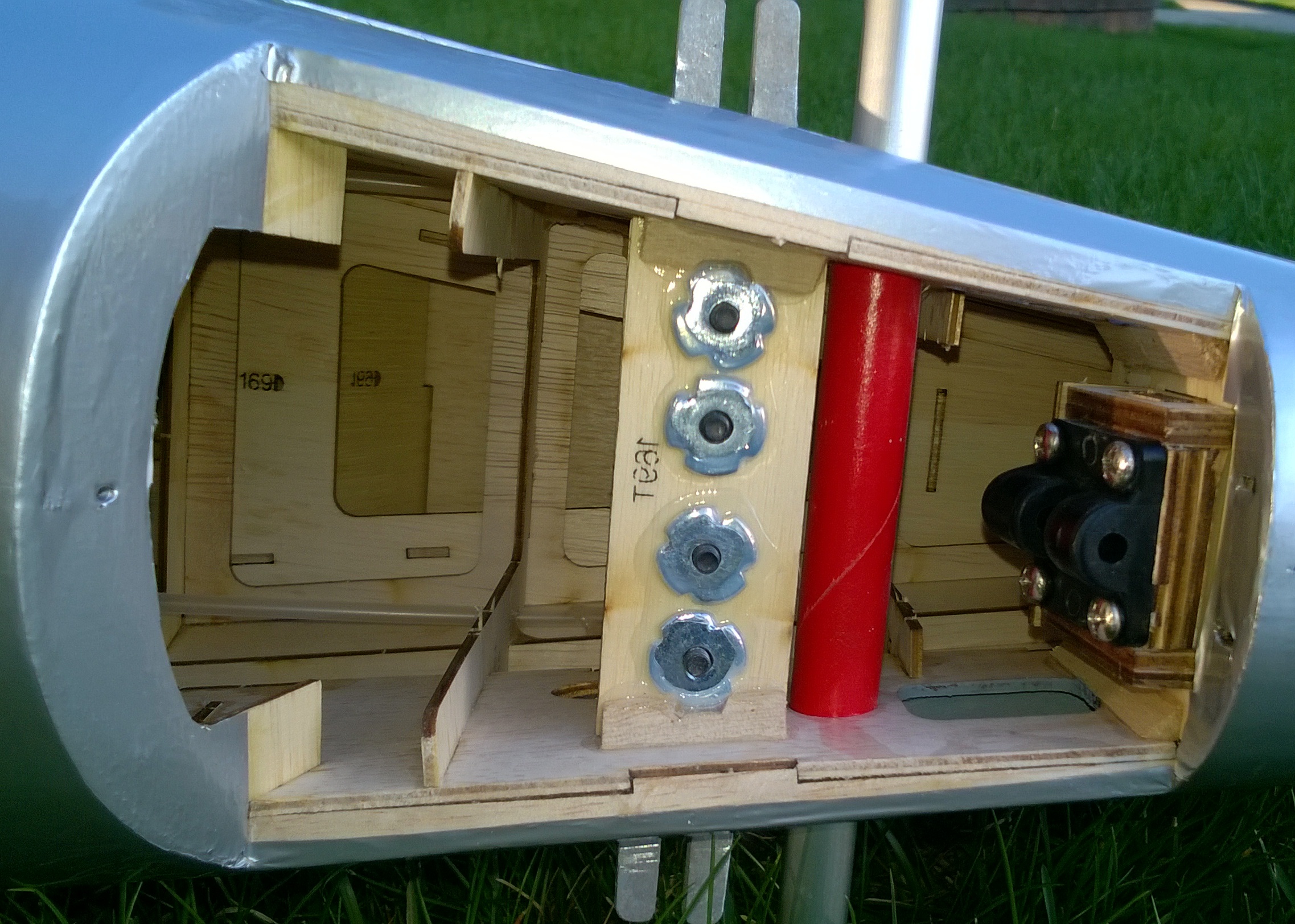

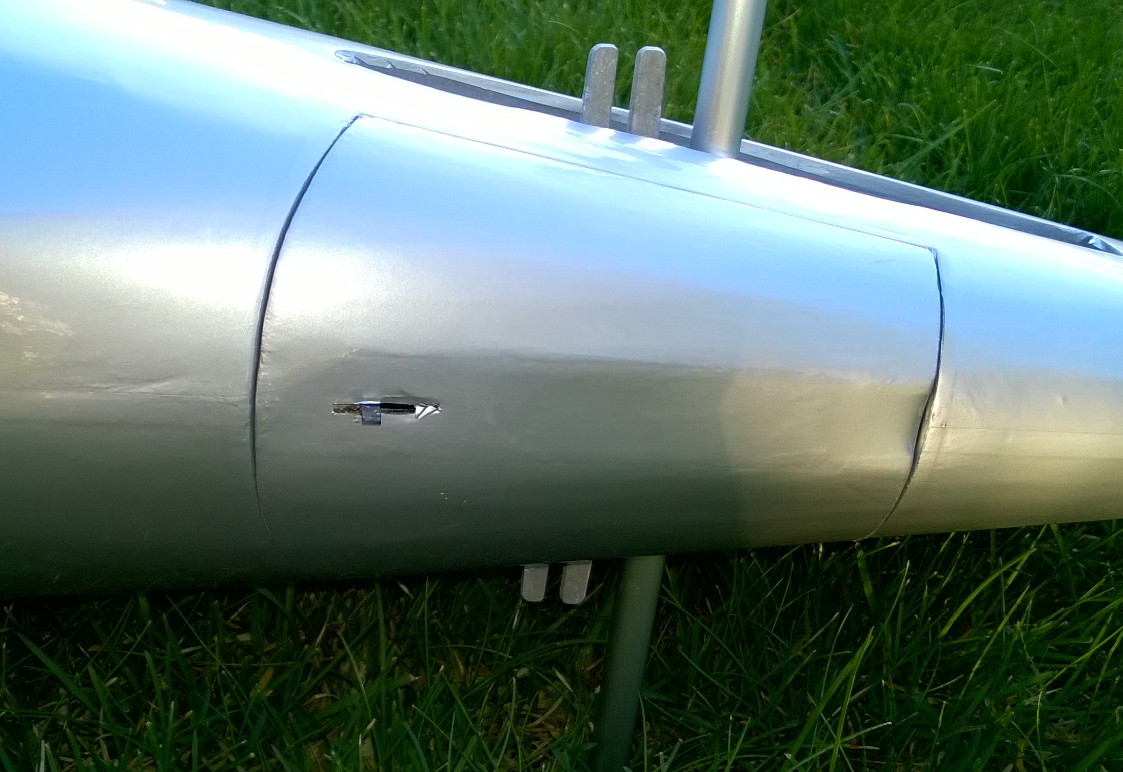

The tail has another hatch with spring loaded retaining latch, to allow easy access to the tail gear mounting and steering hardware. The horizontal stab mounts appear majorly over-engineered to me.
Attachment 2214615Attachment 2214616

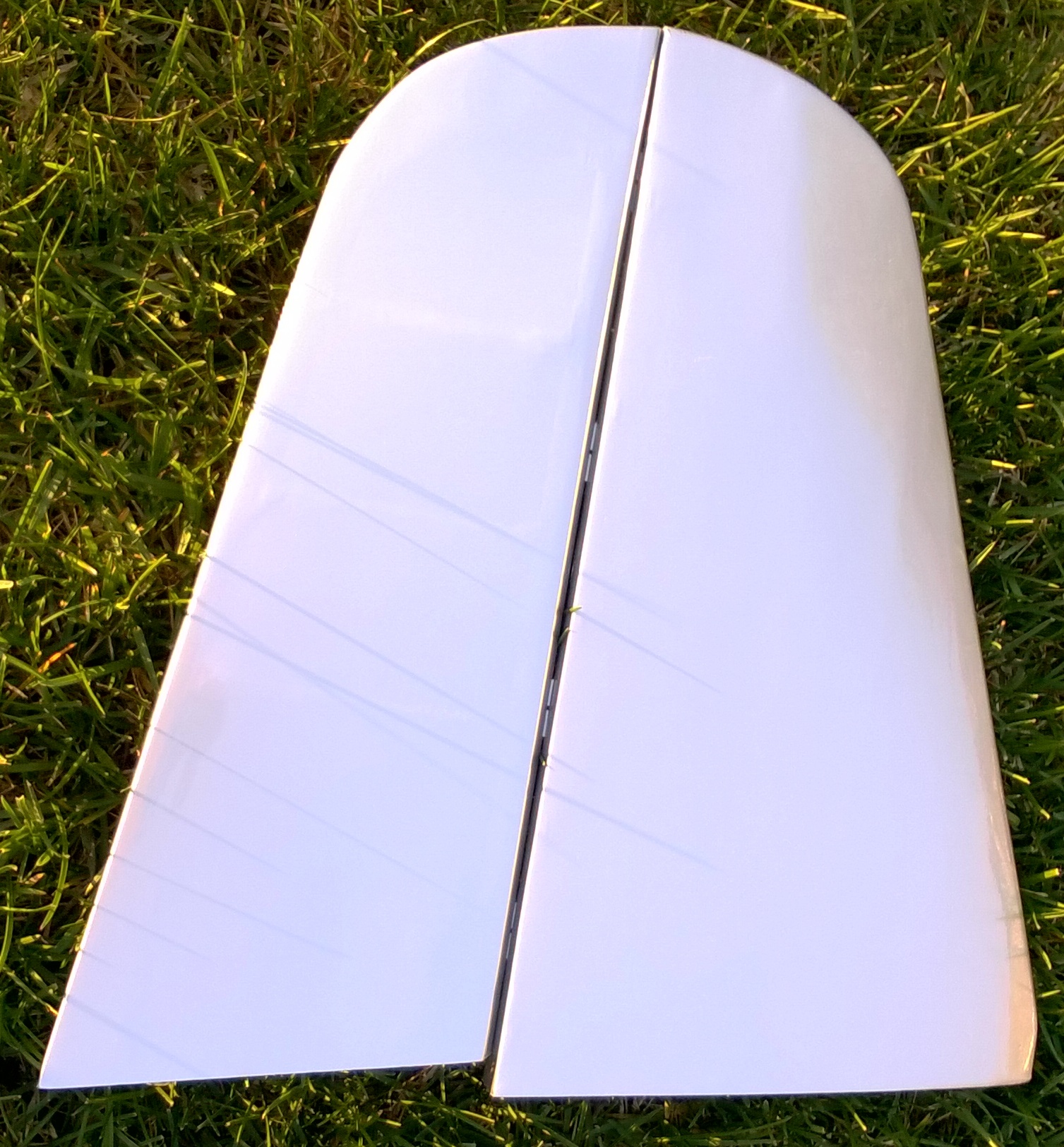

A horizontal stab half, again nicely covered and without wrinkles. All control surfaces are hinged, but not glued.

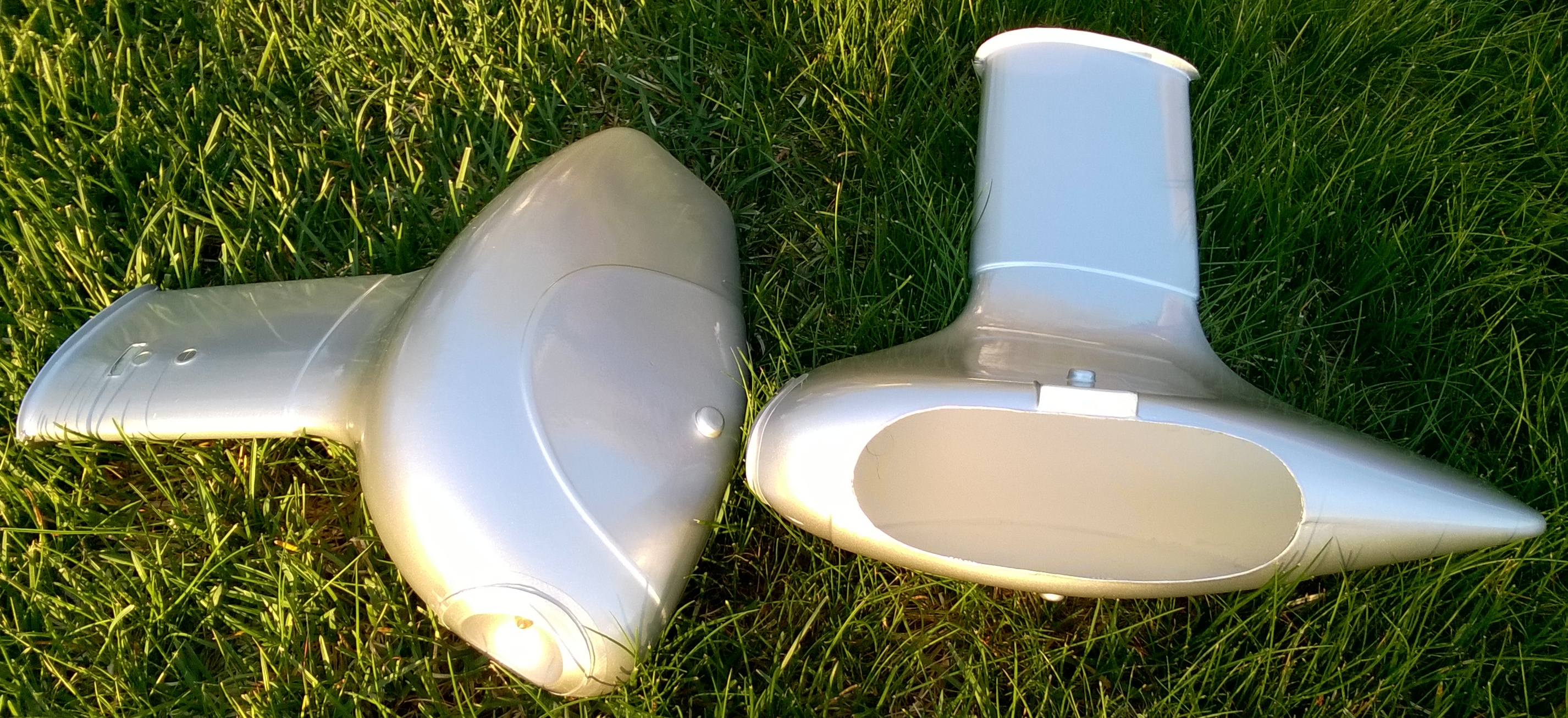

The wheel pants are very substantial fiberglass parts. I wouldn't even bother to reinforce these. The landing lights again contain red painted bumps for bulbs.
Attachment 2214618Attachment 2214619

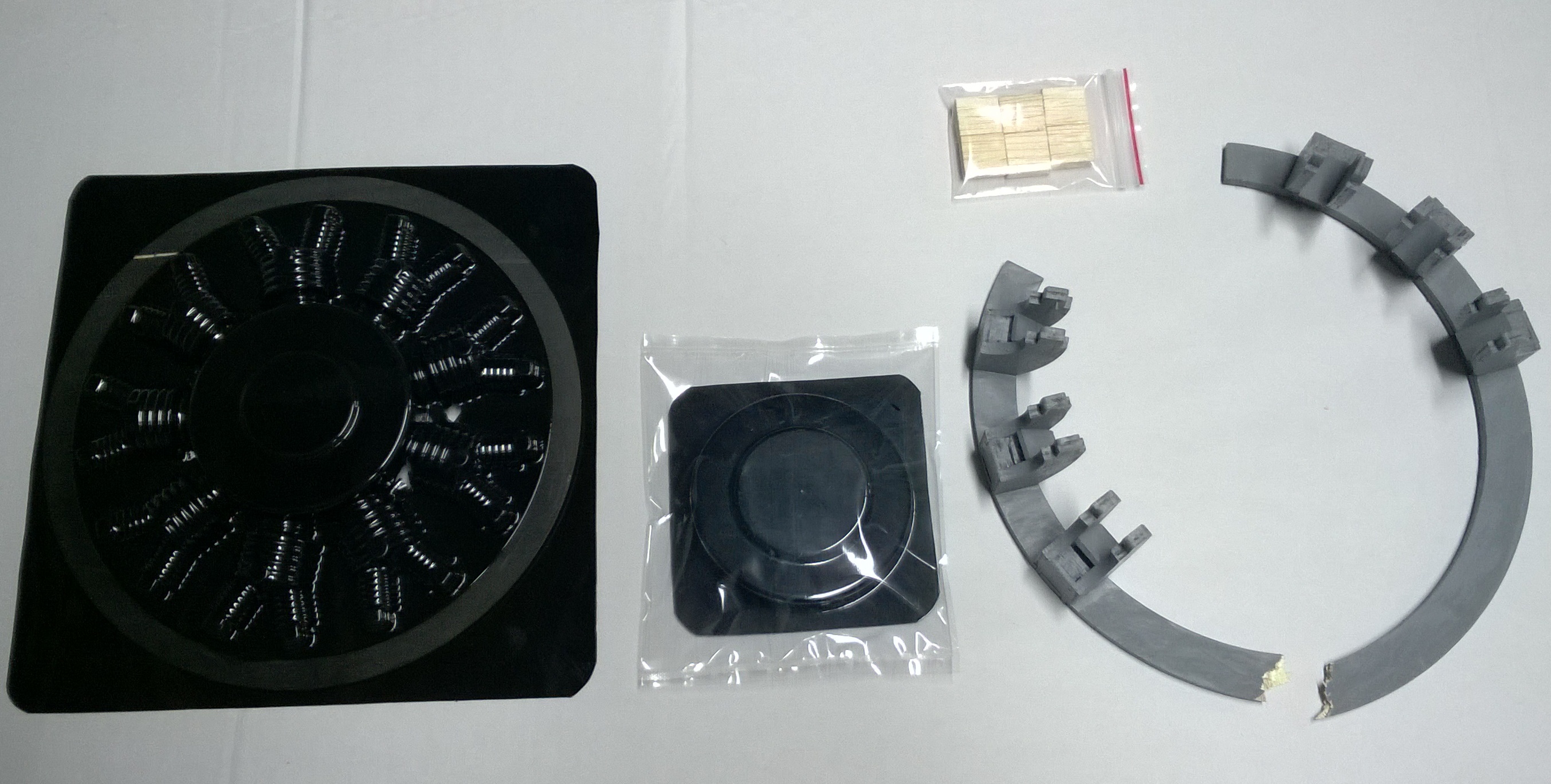

There is an included two-piece dummy radial, a plywood cowl ring (that cracked in half in transit; because of the way it is mounted to the fuse this really makes no difference).
Attachment 2214620

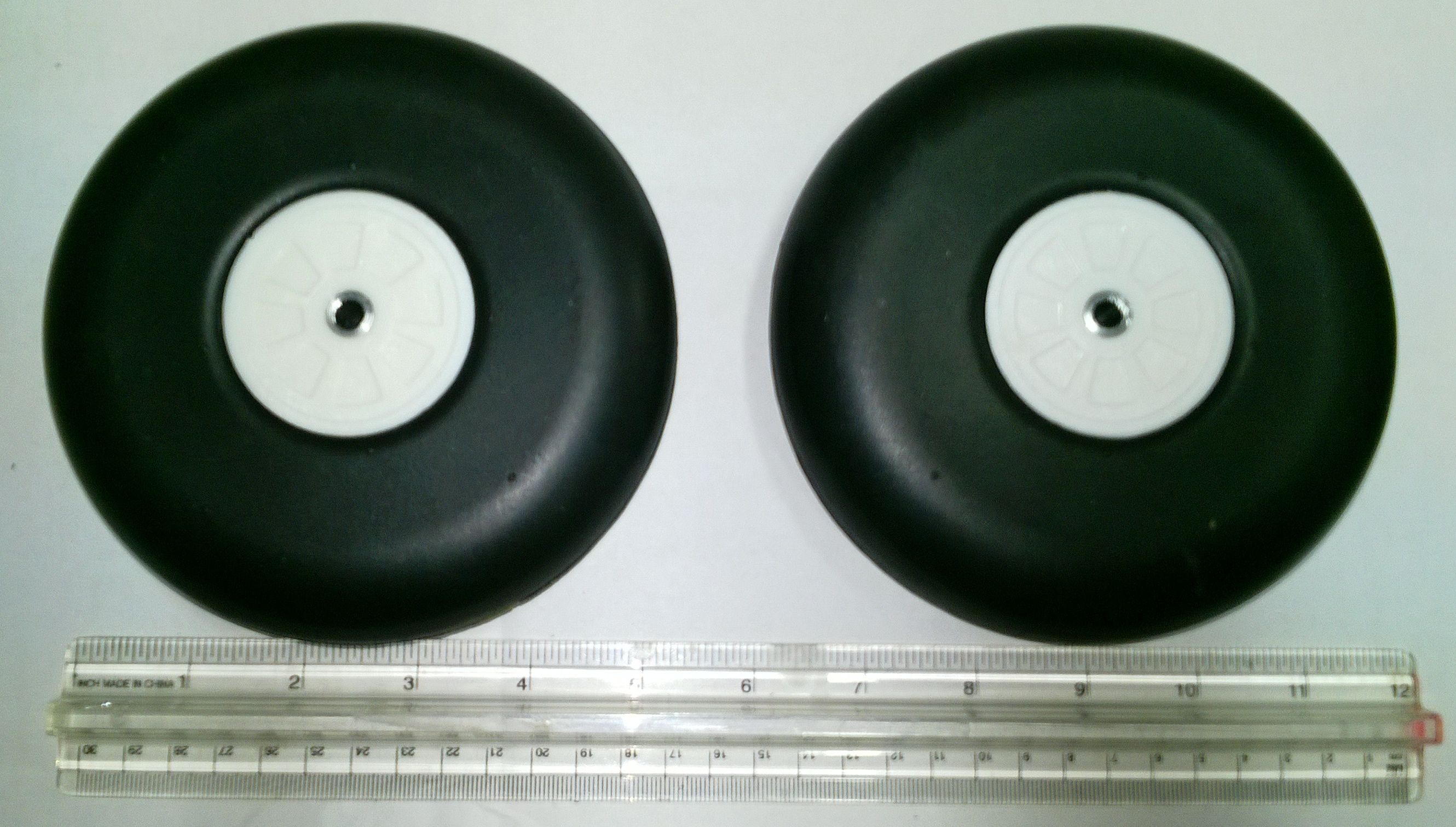

Finally, we have the main wheels. They are about 5", and rather than the cheezy foam we've been seeing on models like this, appear to be foam-filled plastic. They are very hard. If you're finicky, you might want to spend $75 on nice rubber ones, but I won't bother to start with.
Attachment 2214623

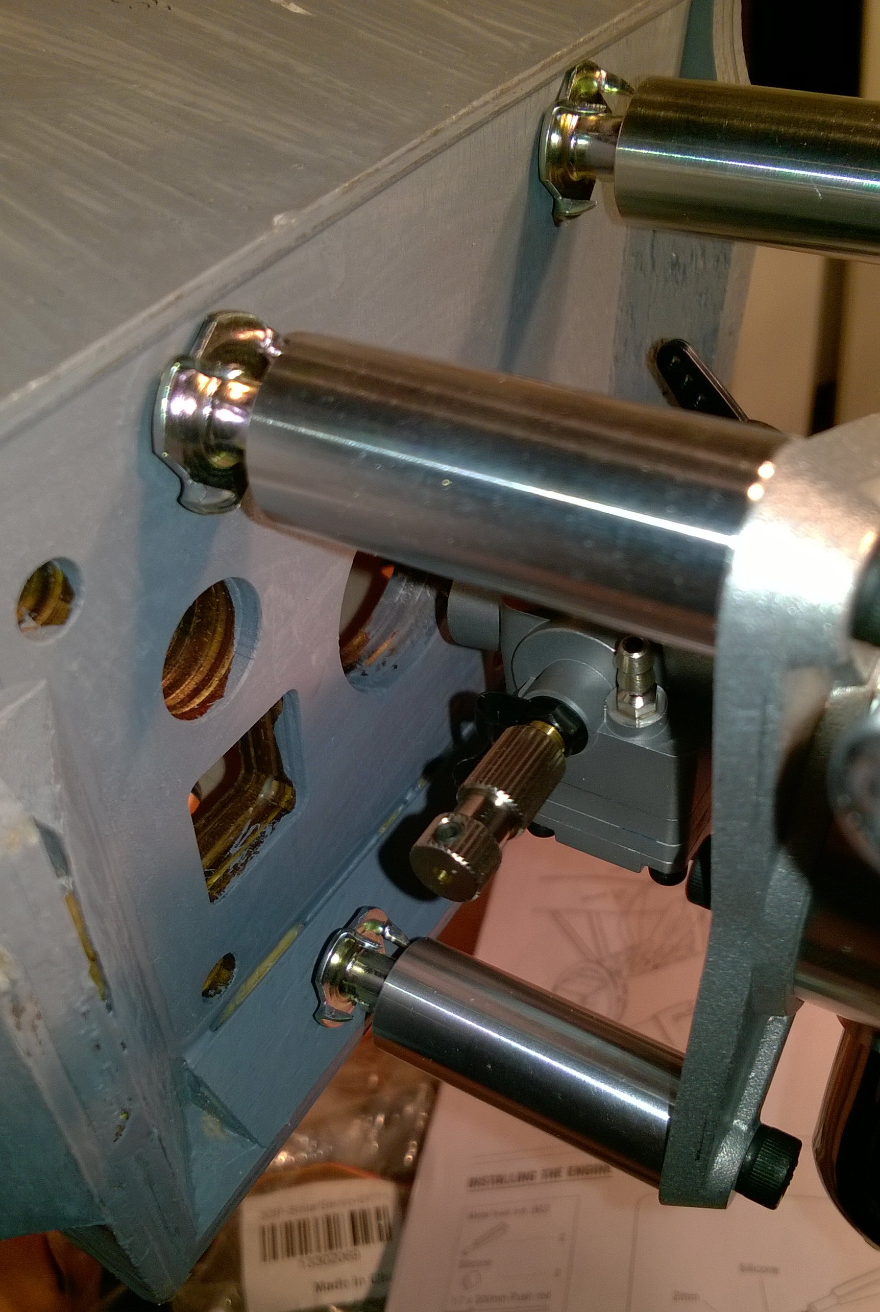

Anyway, purchased some 5 1/2" DuBro inflatable treaded wheels for some cushioning in the landing gear, also went with a 2" aluminum hubbed tail wheel. Sent an order request to Cal-Grafx for some custom numbers per the attached photo so we won't all have the same markings. Fake engine is glued up into the cowling and G-62 fitment trials will begin.
Wile E 05-12-2017 04:38 AM
10 Attachment(s)
Firewall pre-drilled bolt holes were filled with dowels. New mounting points for the G-62 were drawn and drilled. A 1/8" aluminum backing plate was constructed for the back side of the firewall to spread the load of the through bolts (all will be thoroughly epoxied and braced on the inside, also). Engine was bolted up to the firewall and the cowling slid into place. TADA! Engine fits inside cowling, may need a bump for the spark plug cap. Specs for a custom Bisson wraparound muffler have been sent for a quote, the mod would raise the assembly to almost level for inside cowl clearance.

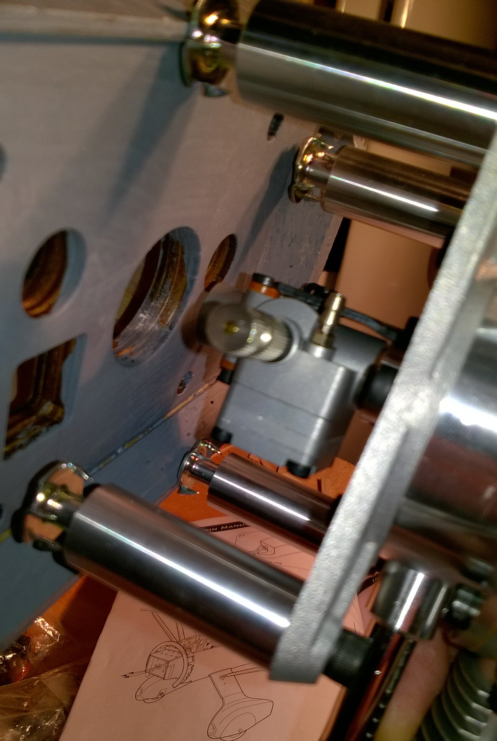

G-62 engine fitment:
Using the Toni Clark cast aluminum 90 degree bend carb adapter: https://www.aeroscale.shop/collectio...um-intake-bend
and 7 mm thermal block : https://www.aeroscale.shop/collectio.../thermal-block as a spacer along with the regular carb block,
and an 18 mm intake tube:https://www.aeroscale.shop/collectio...nt=40161414791 from Vogelsang Aeroscale, plus some fine work with a Dremel tool, the carb lays nicely along the motor box. A choke rod will come out of the cowl ring and be hidden by the cowl flaps. An ignition kill switch will also be hidden in the cowl flap opening.

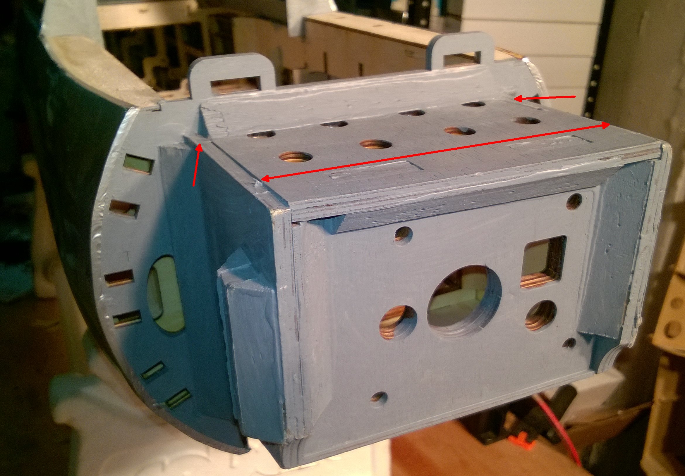

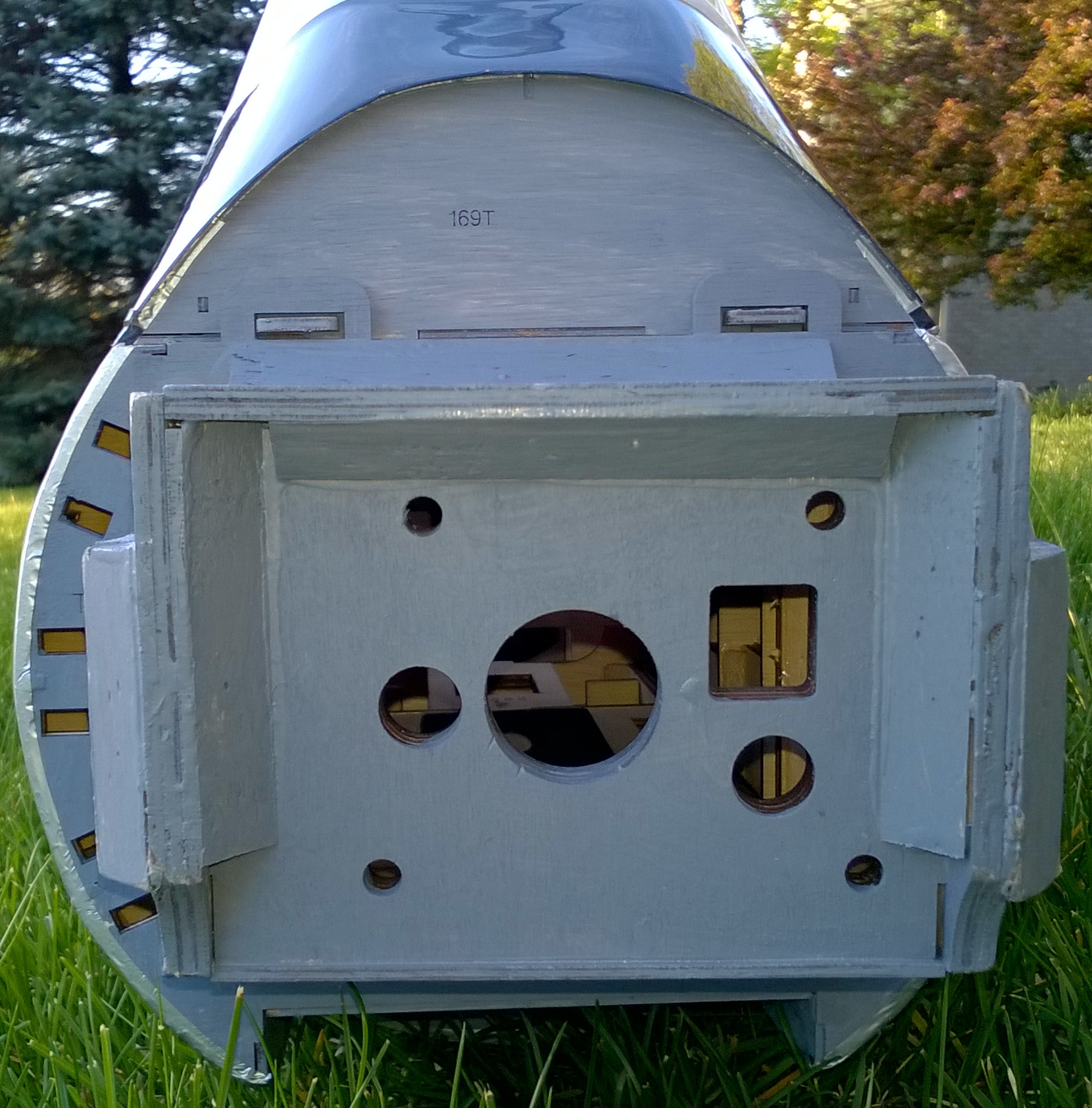

So I have a much more complicated engine mount story, confounded by my inability to "just put it together" without alterations...
I am using the Saito FG-60R3 radial, and the mount spacing is such that the holes in the firewall will be very close to the edge at the top, even if I were to mount it upright and square (which I don't plan to, as you will see). I just bolted the standoffs to the mount plate to eyeball the position on the firewall, and you can see it's probably tight (note that the fuse is inverted in this photo)...
Attachment 2215449
To further complicate matters, I stubbornly wish to add what I consider the most glaringly obvious omission on the model, and that's the external exhaust extension on the outside of the cowl:
Attachment 2215455
I could just make it cosmetic, but where'd be the fun in that... :rolleyes: So I need to route the actual engine exhaust out through the cowl bottom side, so it can exit in the scale position. However (again), I have an exhaust ring that outputs on the bottom, which means I'd have to route it sideways, then back, etc. Which I could do, but where's... well you know.

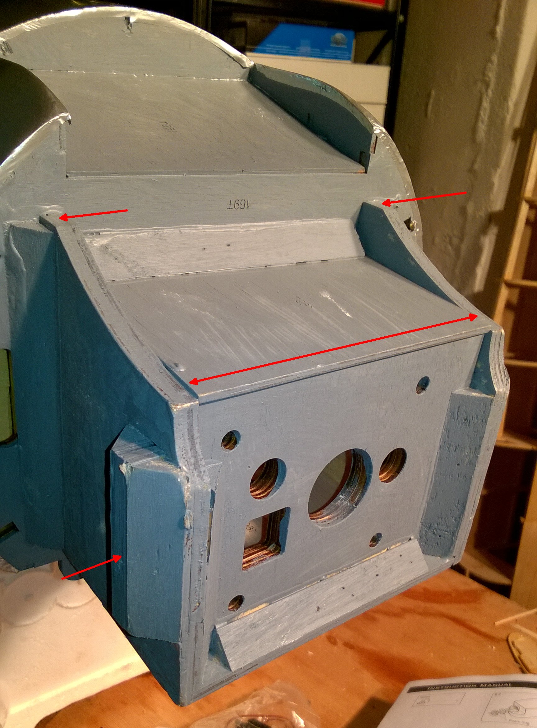

So it occurred to me that I could rotate the engine 1 scale cylinder (as in 1/9 of the circle or 40*) have have the exhaust in the exact right spot. Problem is, that makes the mount spacing even worse...
Attachment 2215450
You can see if I am to mount it in this manner, I will need a new larger firewall to mount it to. One more wrinkle is that the instructions call for the firewall-to-thrustwasher distance to be 170mm, and I measure stock mount on the engine to the thrust washer as about 180mm already. So just doing something like cutting of the front edges of the motor box and slapping a larger firewall on it won't work unless I significantly shorten the standoffs, which will probably result in other interference problems.
To make things even worse, this motor mount is put together like a Chinese puzzle. The firewall has tabs that stick through the sides and top of the motorbox, and the sides are actually two extended plies that continue through the front former and the next two formers inside the fuse (being joined by a third ply in the process). See the single-headed arrows in the pictures below. Thus, disassembling this mess is out of the question, and some cutting must be done.
Attachment 2215451Attachment 2215454
I am thinking of just cutting the whole front off the box, right behind the current firewall, along the double headed arrows above, and in the photo below. Then I think some 3/4 ply might be just the right size, and glued and pinned it might be strong enough. What do you all think?
Attachment 2215452

RickVB 05-17-2017 01:57 PM
In a "duh" moment, it occurred to me that it would be much easier to accomplish the same thing (mounting the engine rotated by 40*) if I just made a new back mount plate for the engine with the screw holes moved 40*... duh. So I'm going to figure that out tonight. Hopefully I have the right thickness of aluminum stock to cut it from (no mill here...).
