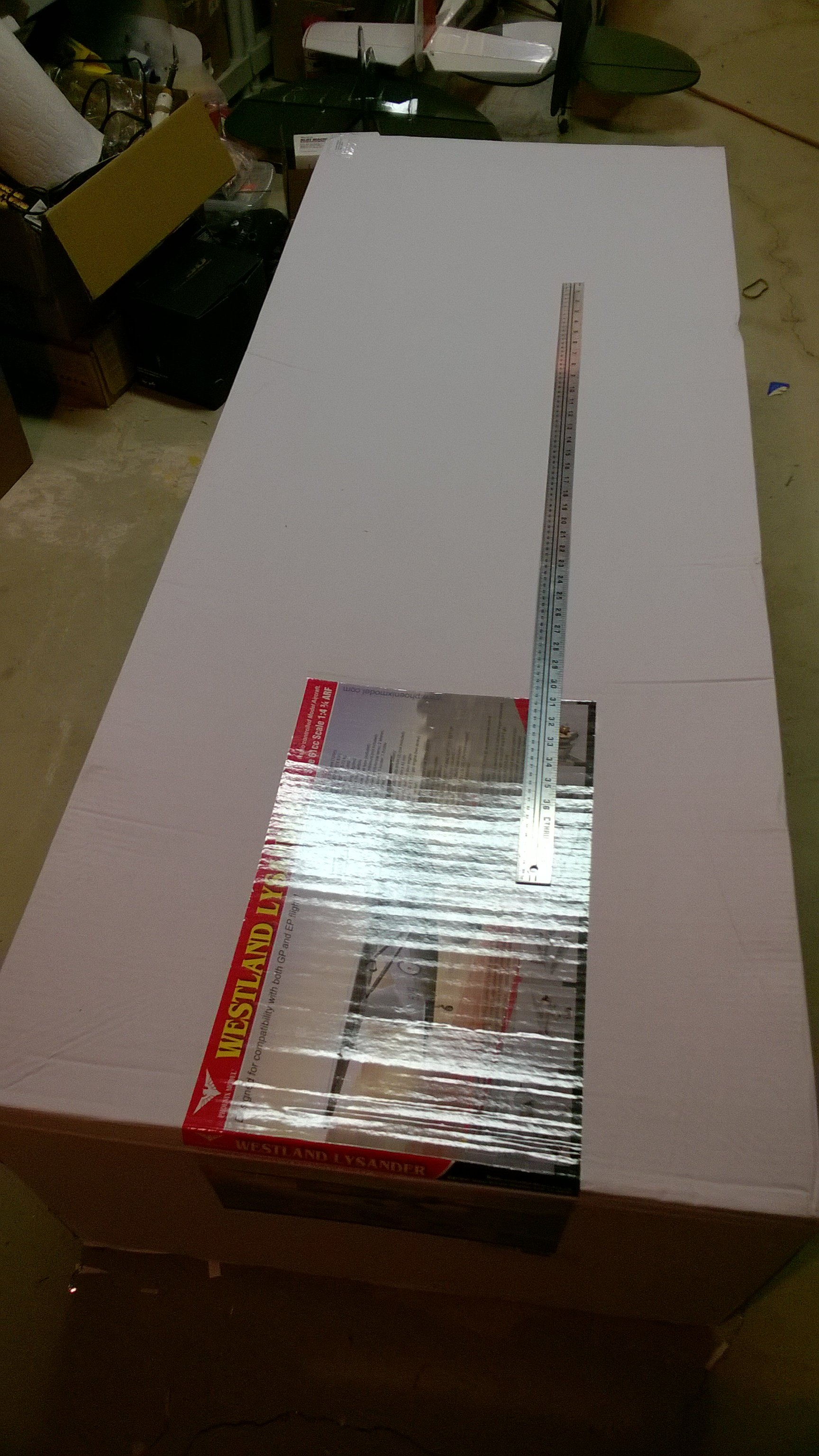

The box - this is REALLY big. That's a meter stick on top of it. As you will see, my workshop was unprepared for this, so this will be presented in stages.

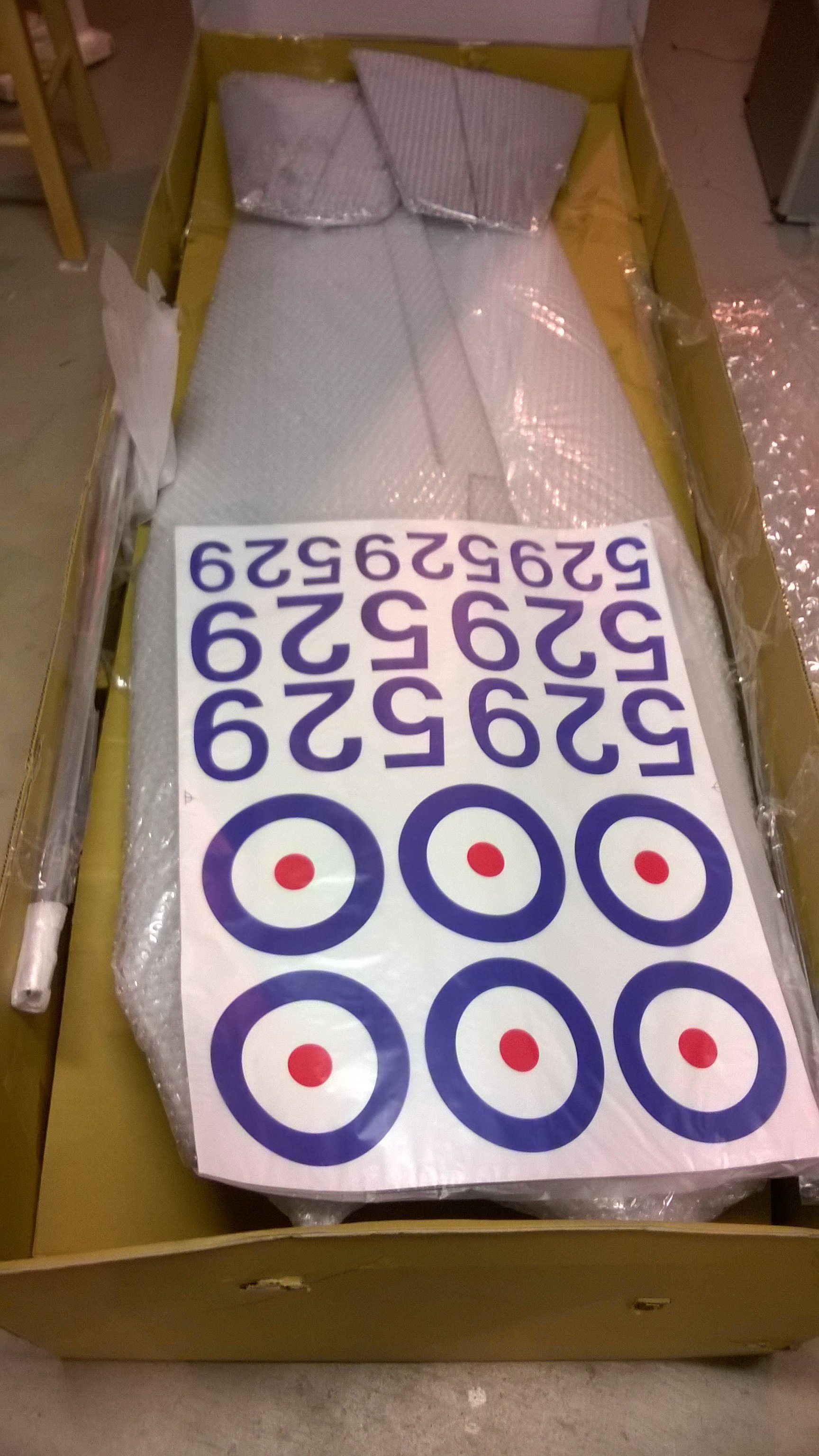

Under the tailplanes and decal sheet are the wings...
Name:	First Layer.jpg

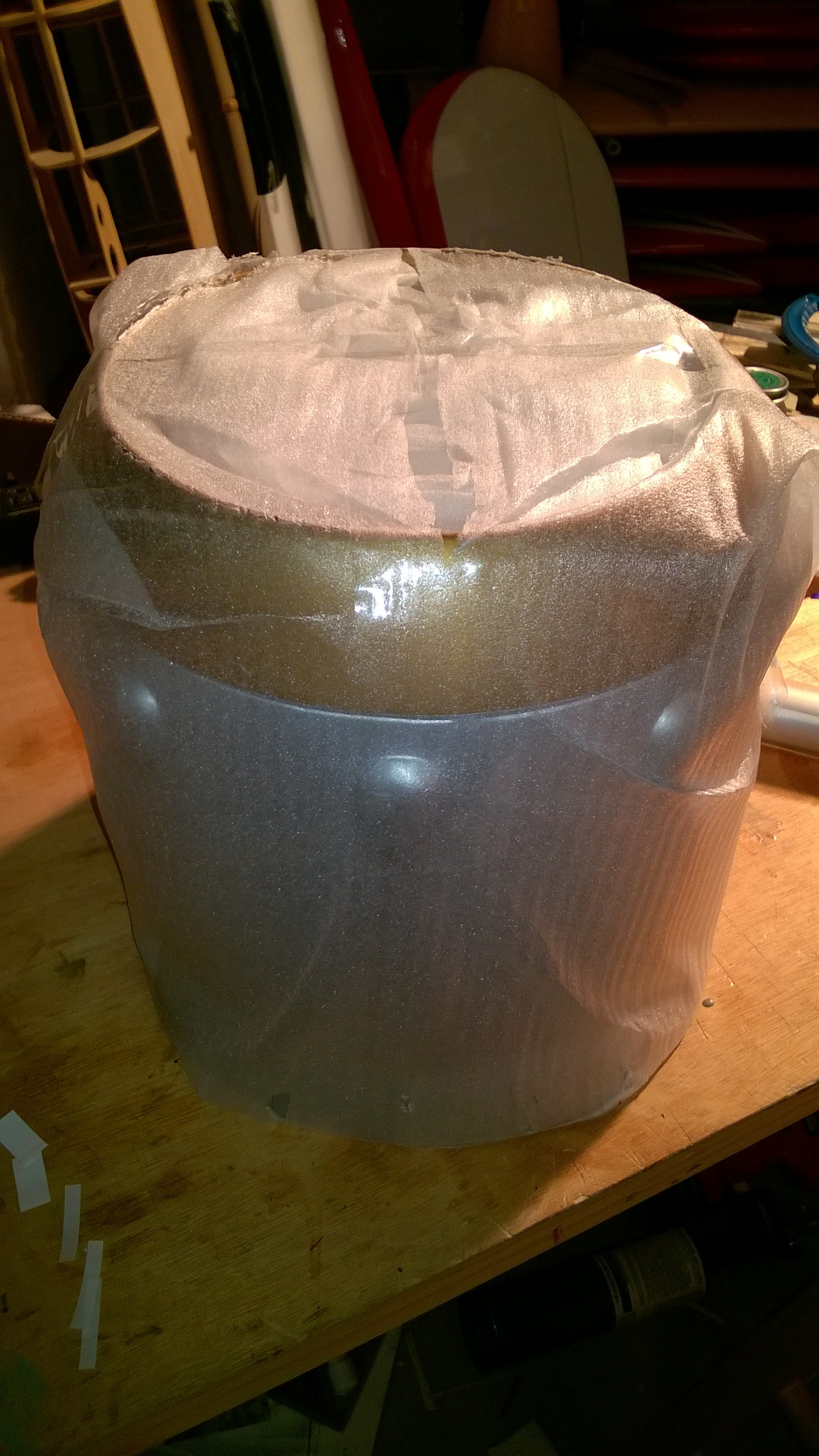

The cowl is closed off as a container for most of the smaller parts.

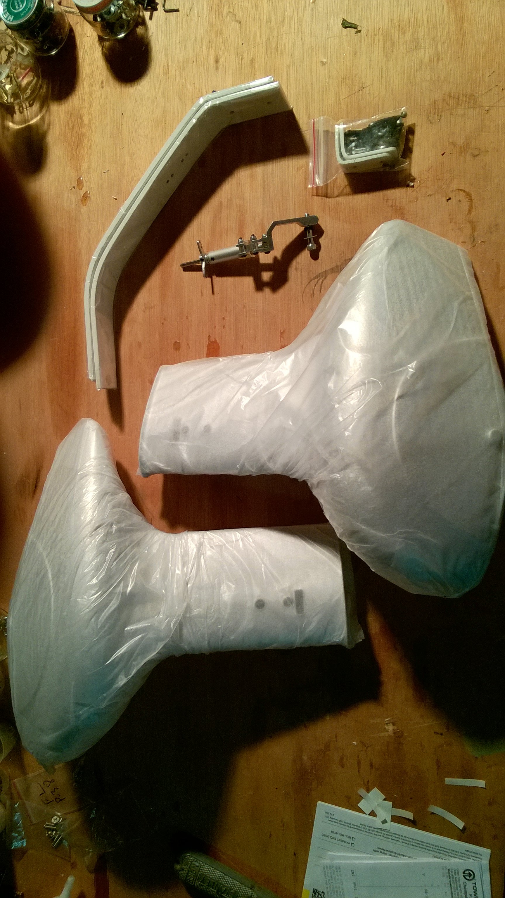

Wheel pants, main gear, tail gear and mounting hardware. The top three items were also tumbling around loose in the box.
Name:	Wheel Pants Etc..jpg

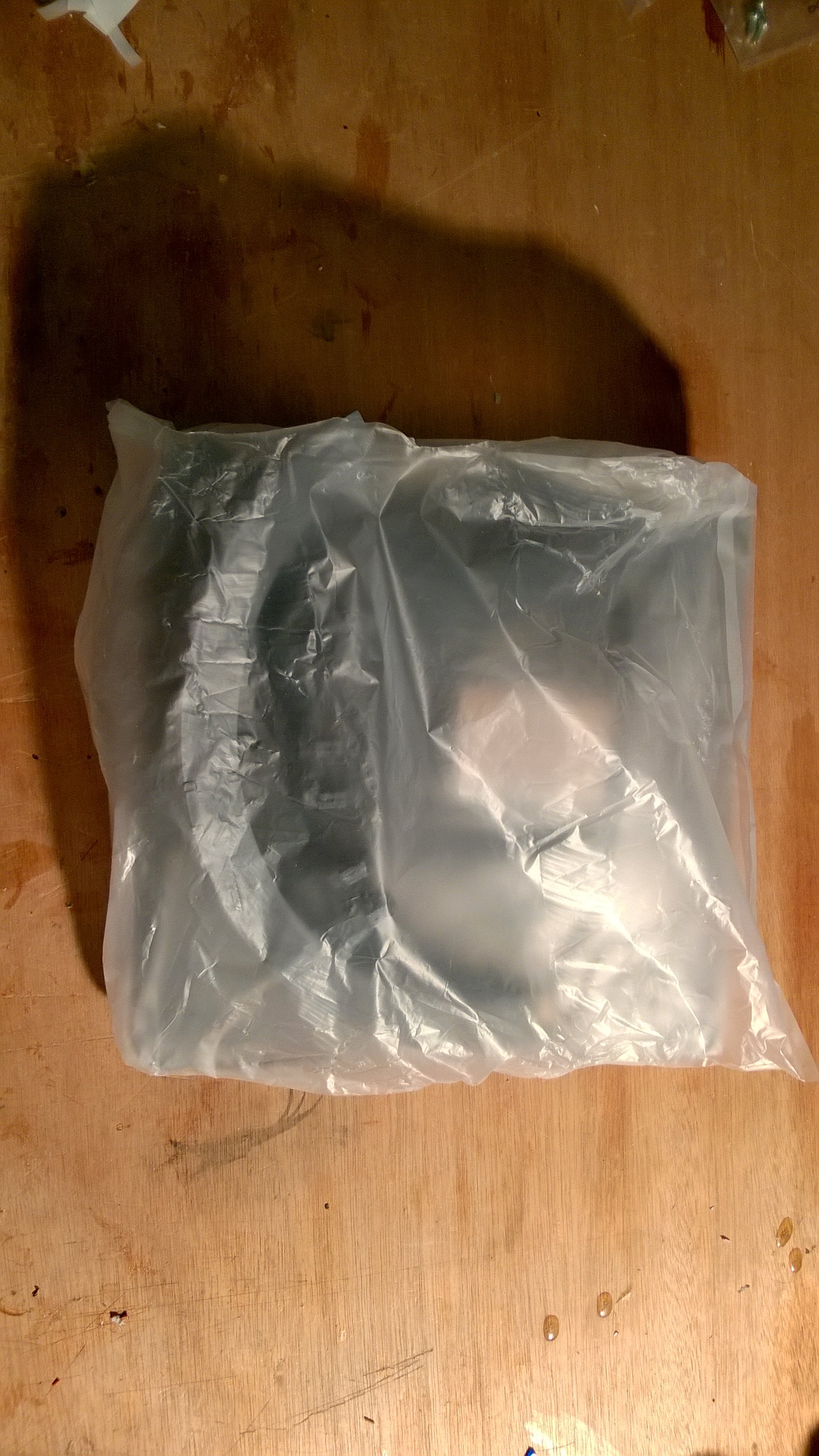

Bag containing dummy motor and misc cowl mounting hardware.

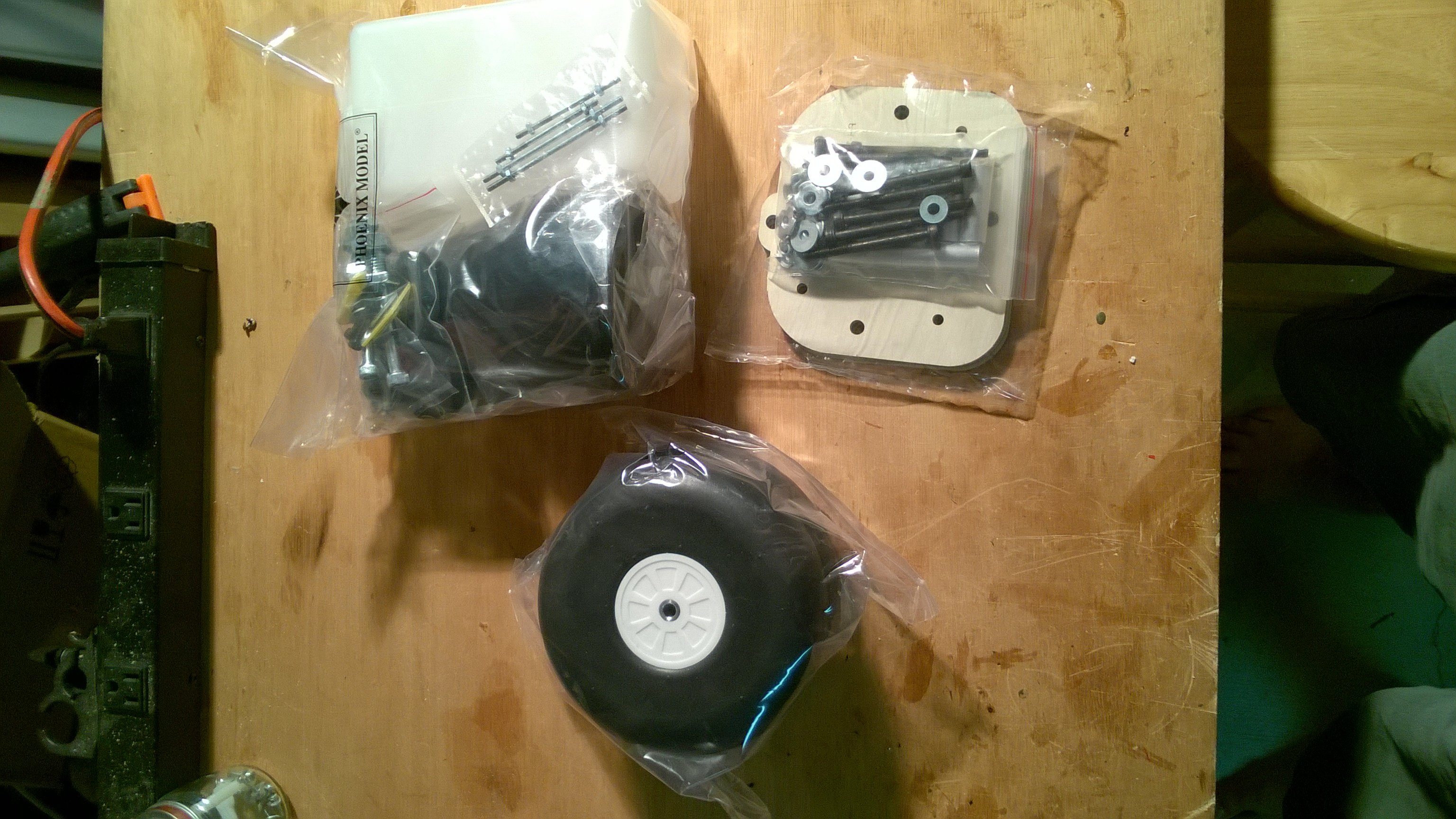

The contents of the cowl - wheels, spinner, fuel tank, and motor mount.
Name:	Wheels Spinner Etc..jpg

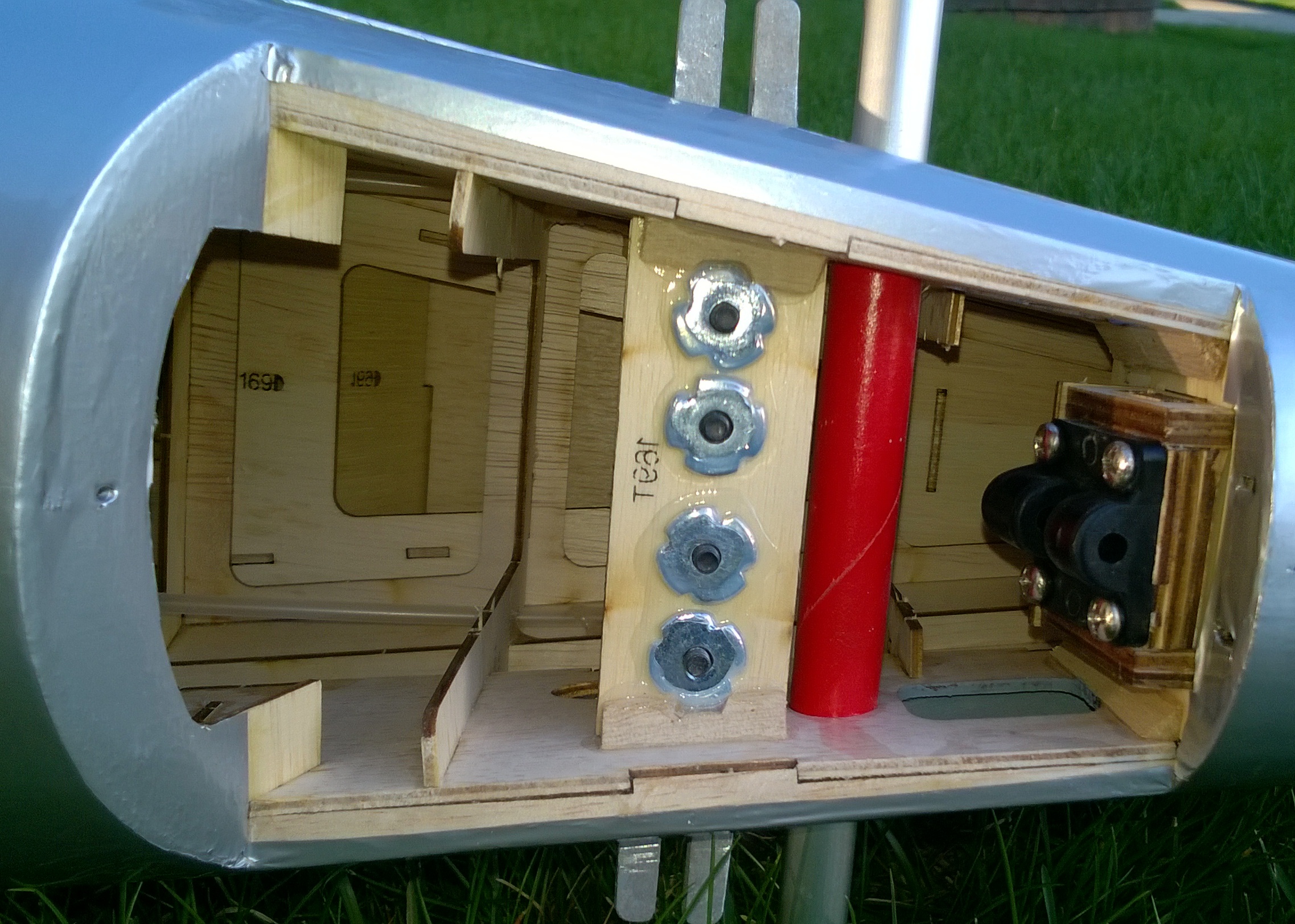

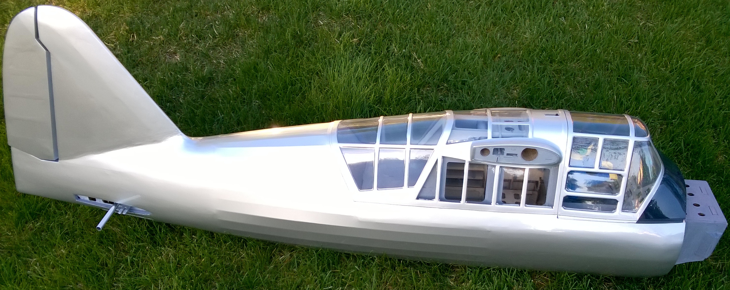

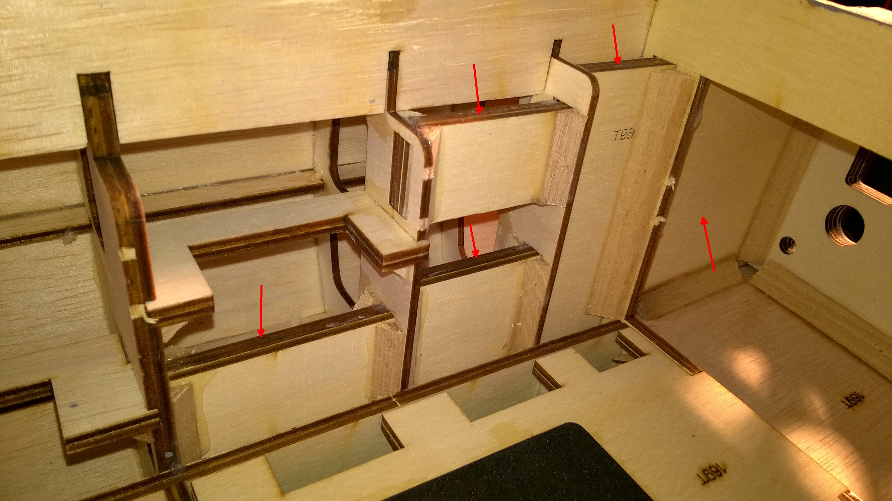

So the unpacking is complete... I gave up on trying to clear enough space to photograph in the shop, so I moved the big parts to the front lawn get get them in a good enough position.
Despite the dings in the box and the loose items, the only damage I found to anything was the cowl ring being cracked (no biggy, as you'll see).
The fuselage appears to be entirely ply, balsa and sheeting, covered with Oracover. they did a really nice job of the covering. No dings or wrinkles are apparent. The cockpit is a removable hatch, that is held on by a spring loaded latch on the top. As has been said, this thing is huge...

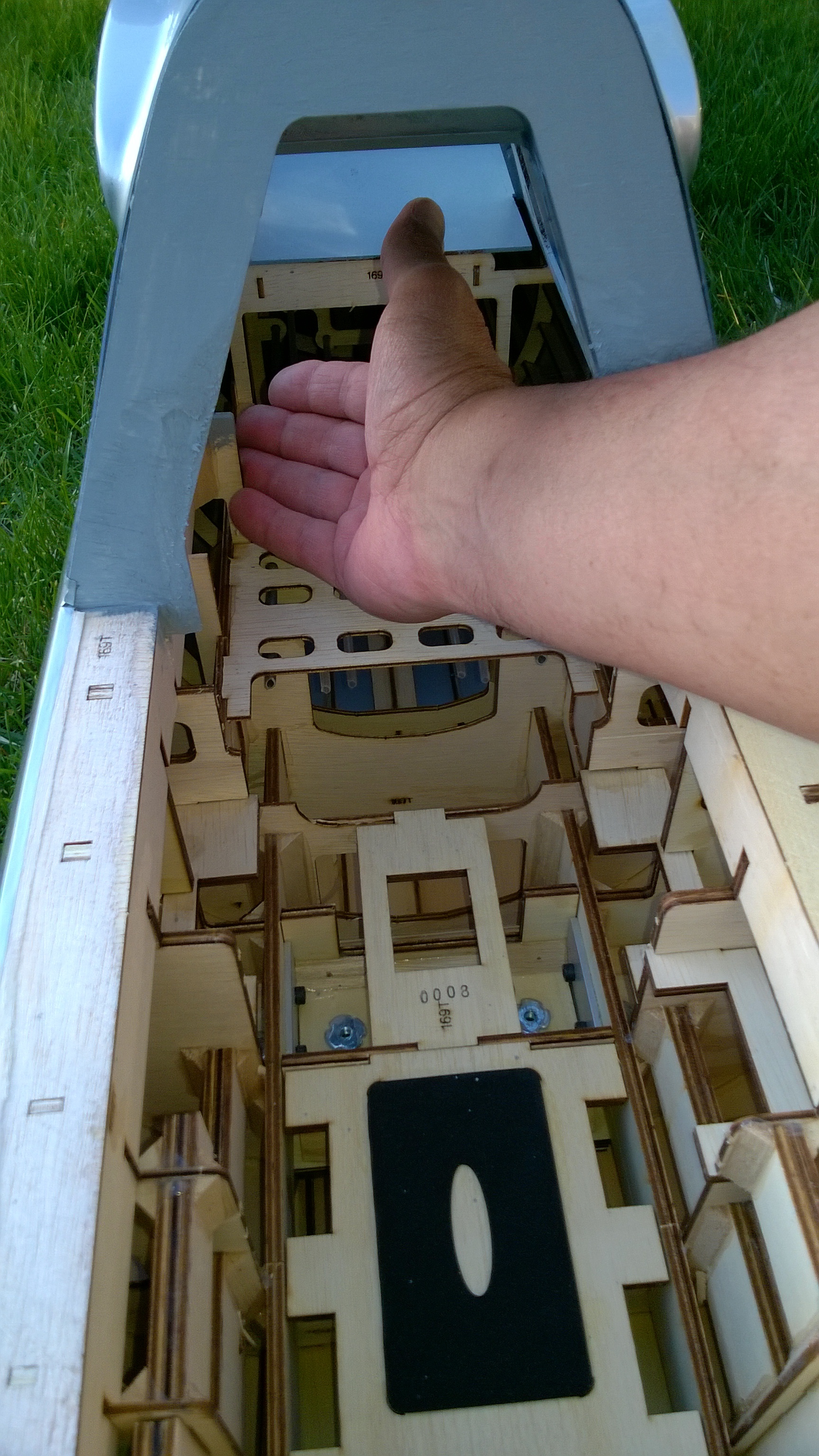

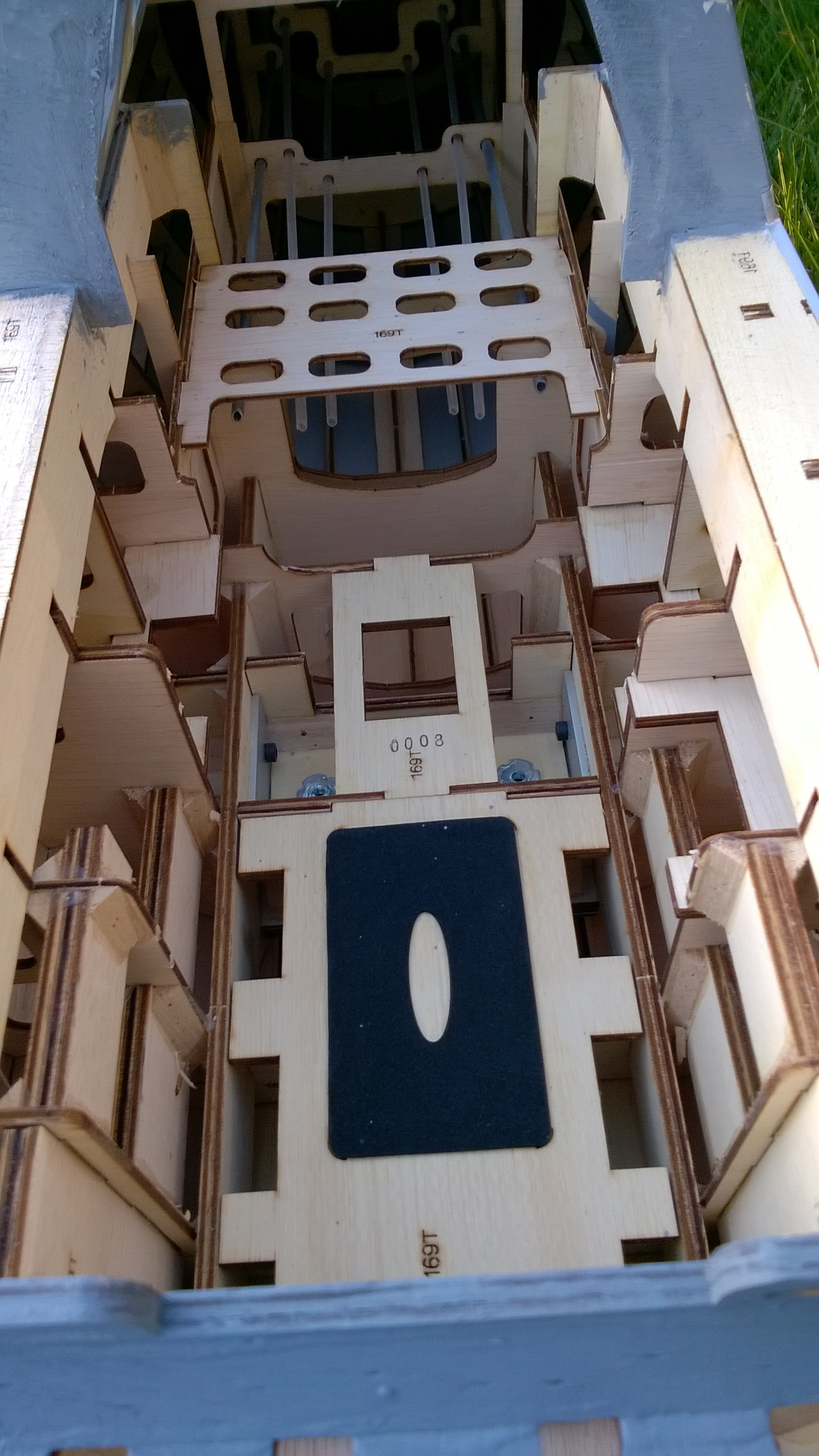

The interior is indeed cavernous.
My big hands will fit way back in there with no problems at all.

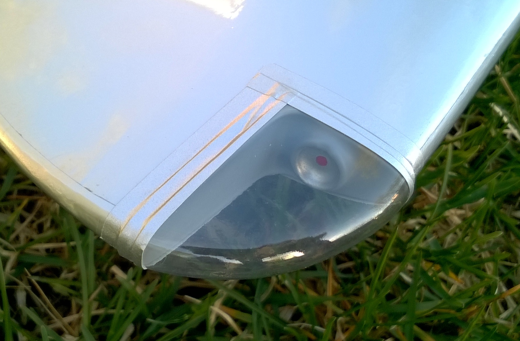

The wingtip nav lights are crying out for a lighting system. They are faked here by little painted bumps, but both sides are red.
Name:	Nav Light.jpg

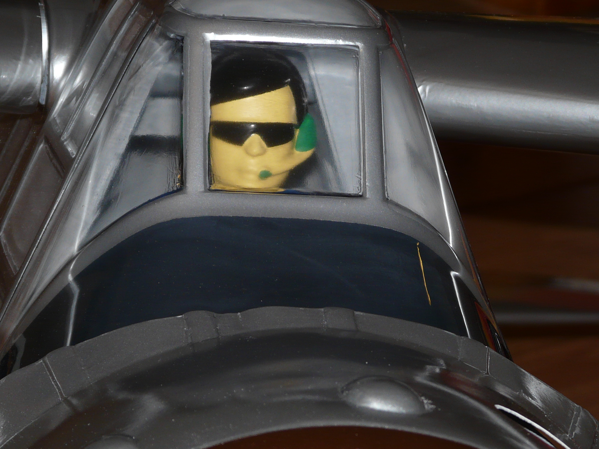

The canopy glass is pretty fuzzy. This isn't all bad as the instrumentation is not even the right colors, let alone accurate, and the pilot figure is a joke. This is the biggest disappointment for me.
ID:	2214611Click image for larger version

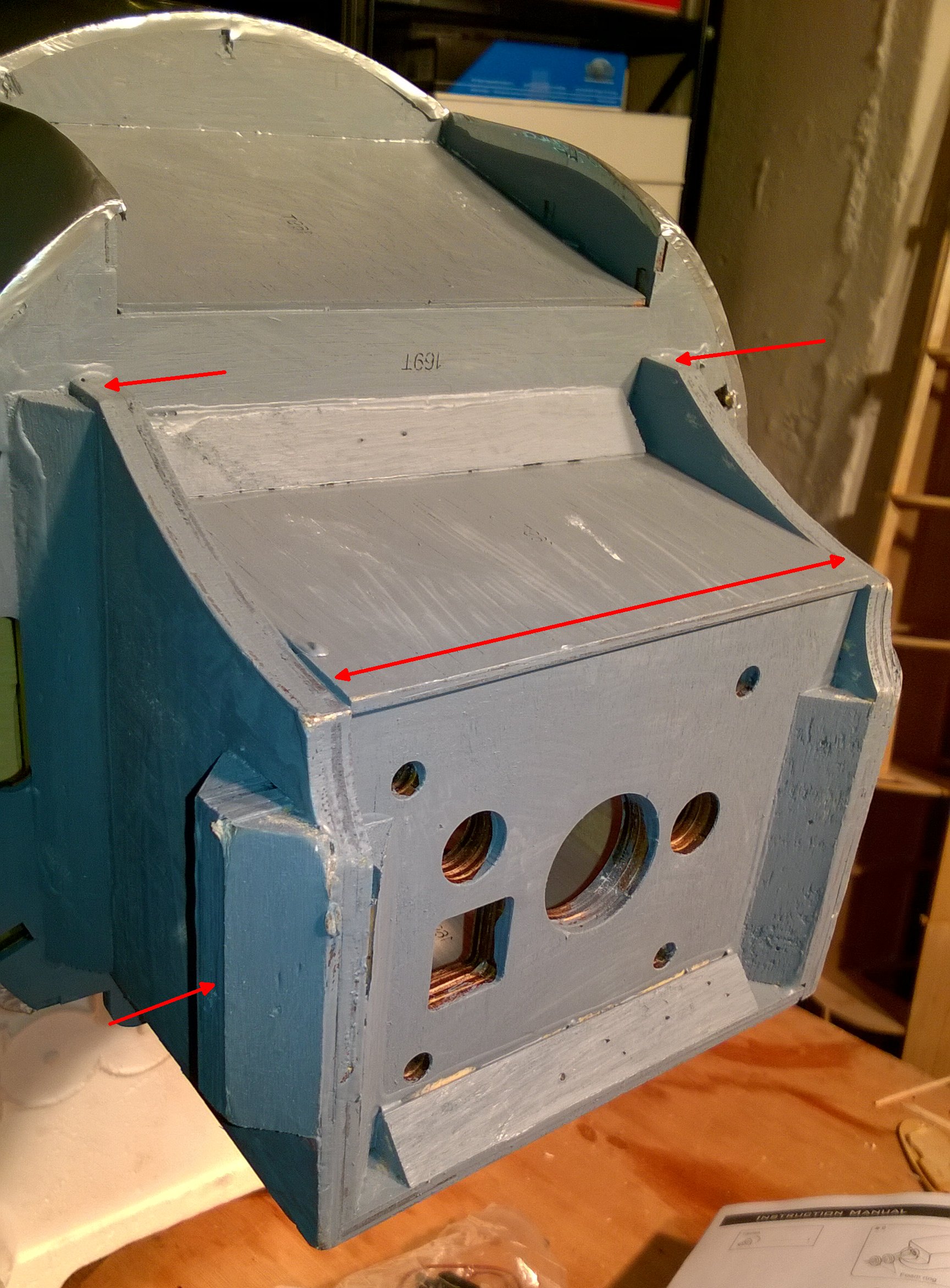

The motor mount is substantial, and has a fair amount of right thrust built in it. It doesn't appear to have down thrust built in.
Name:	Motor Mount.jpg
ID:	2214612Click image for larger version
Name:	Motor Mount 2.jpg

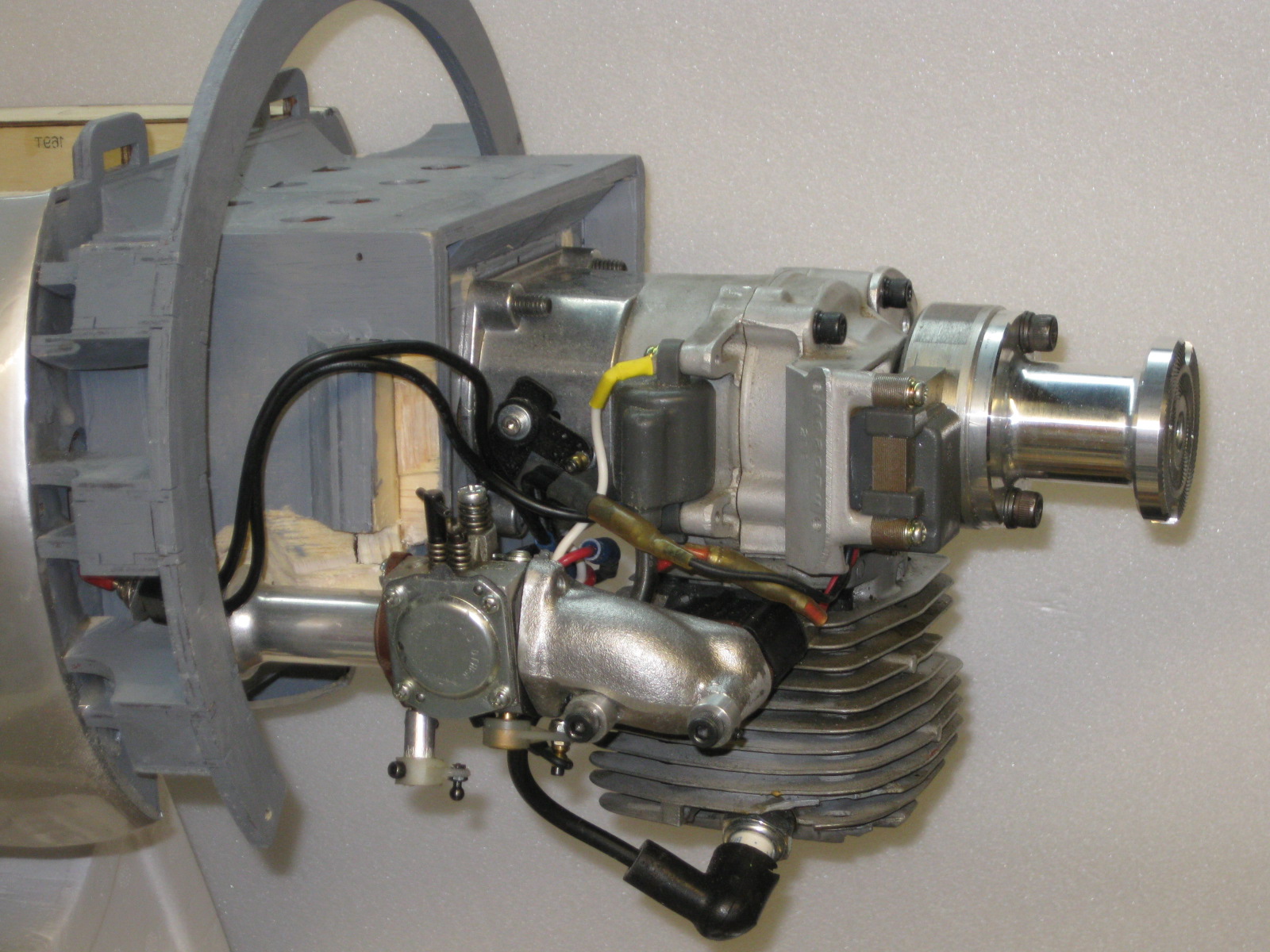

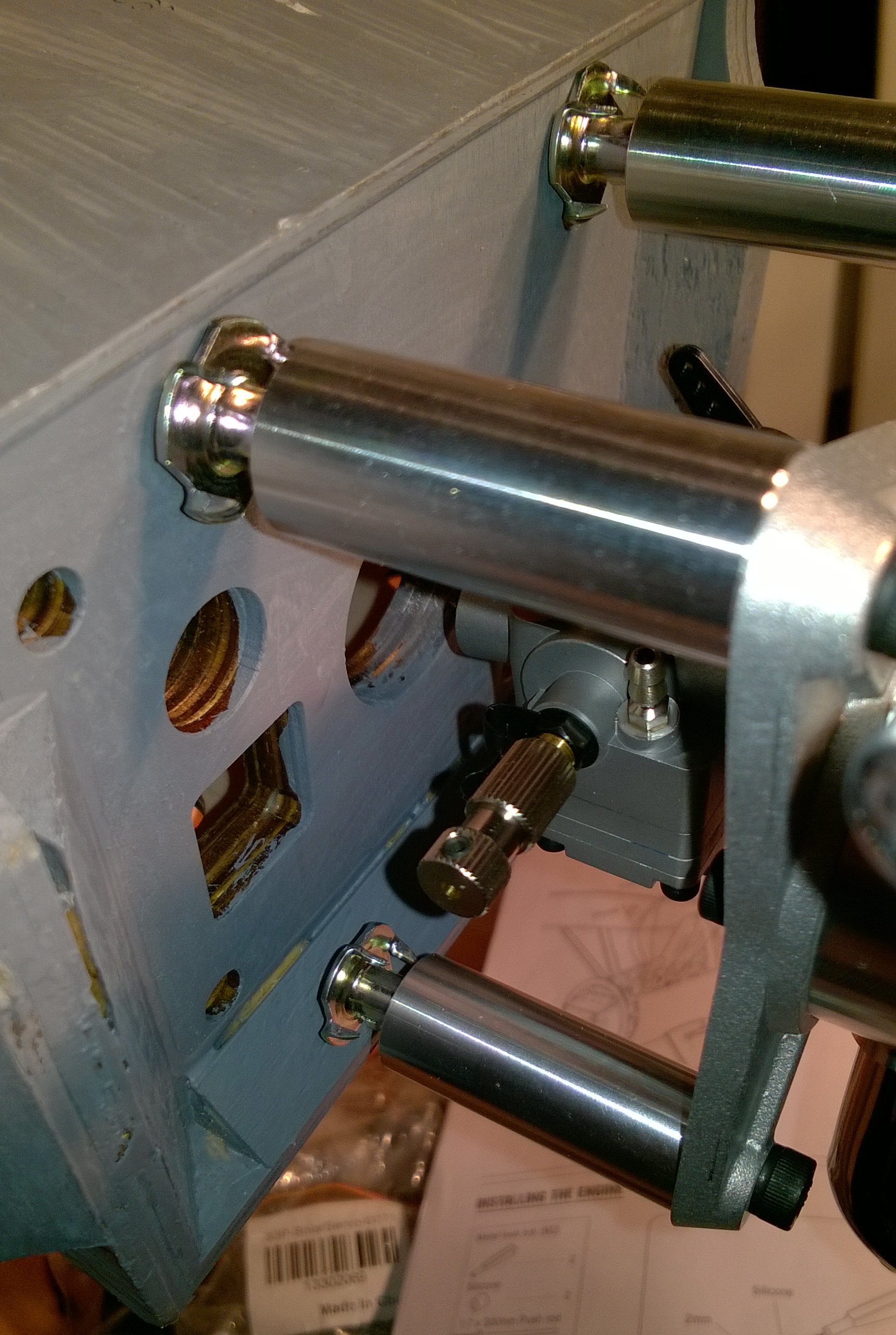

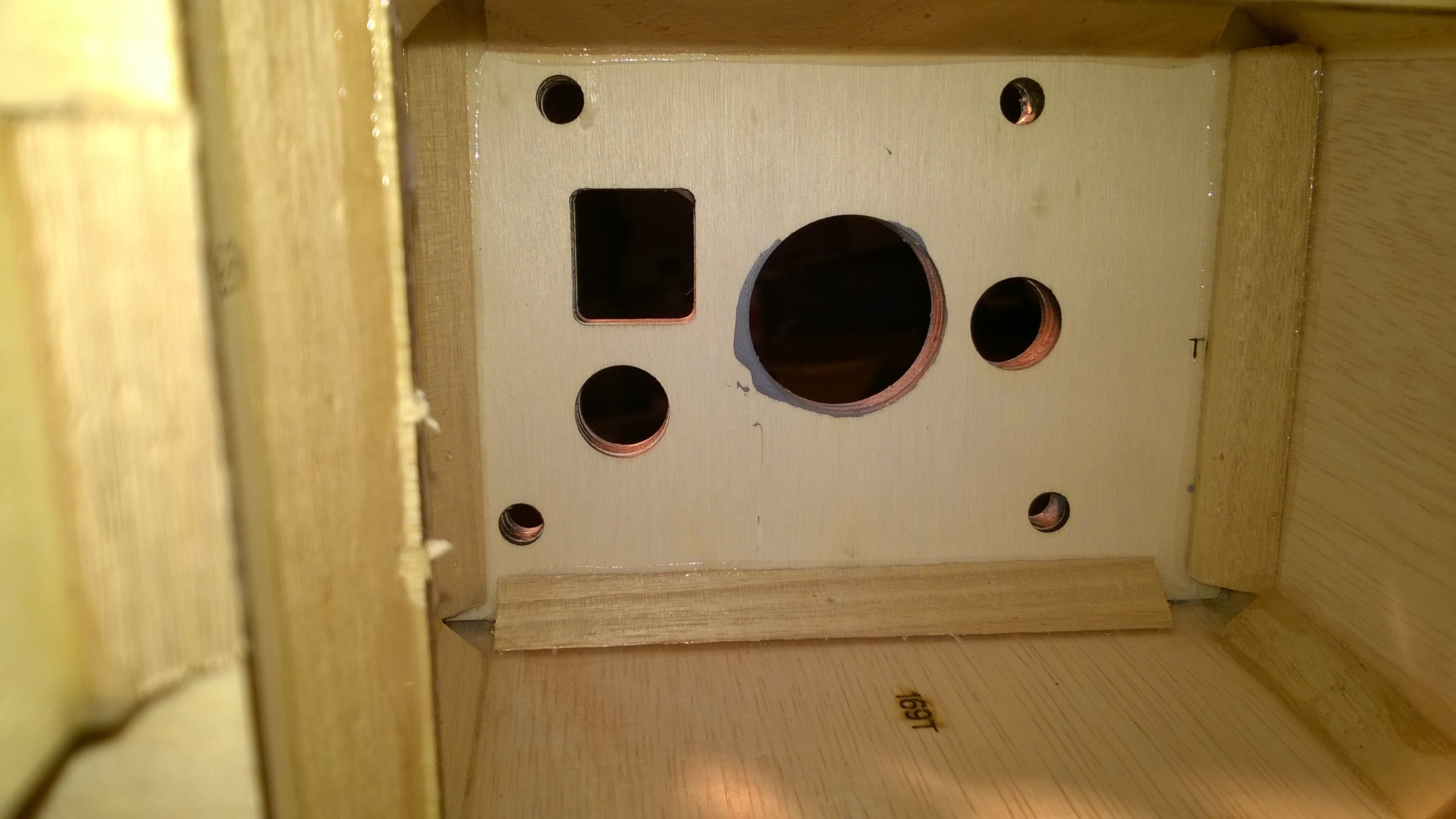

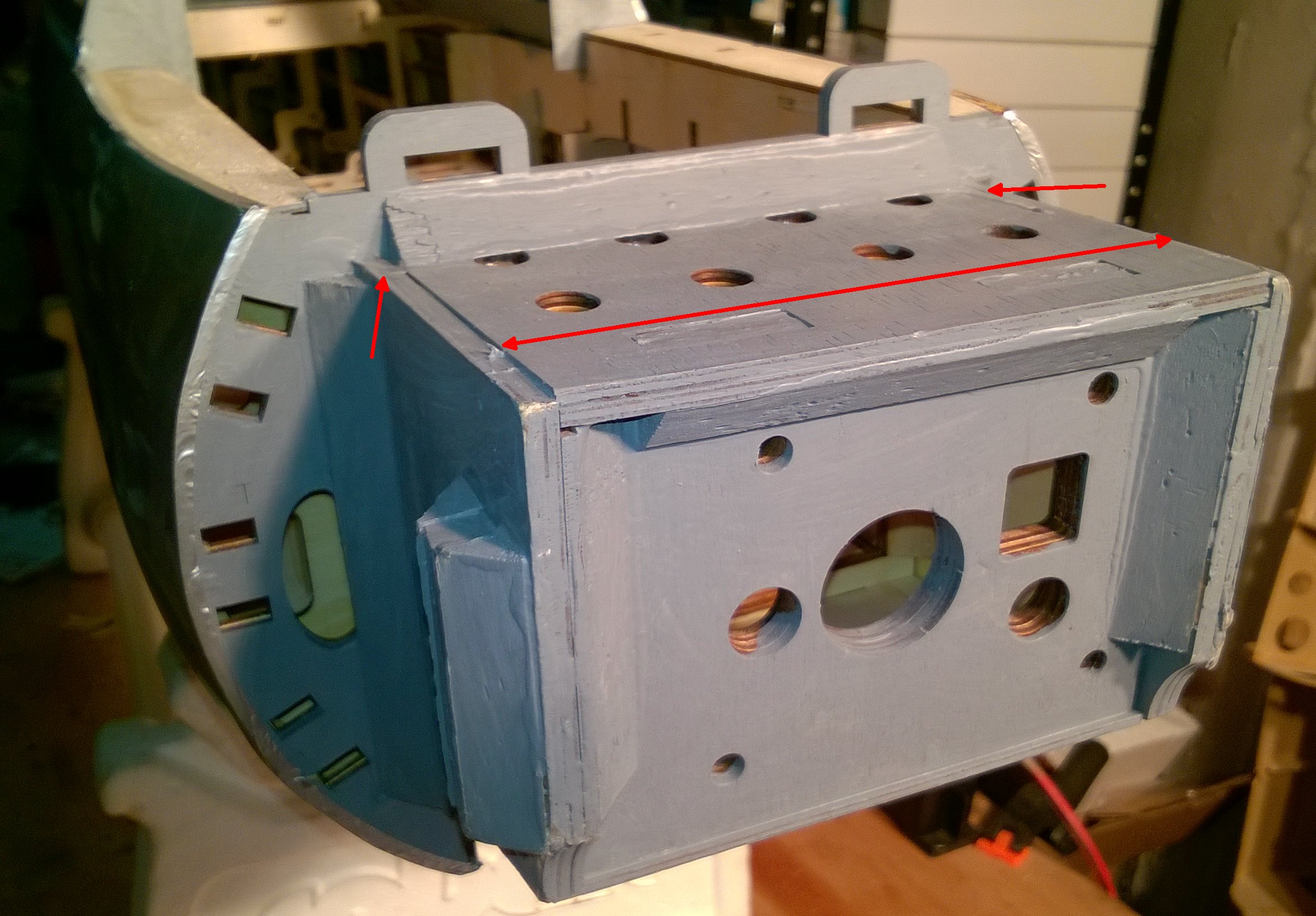

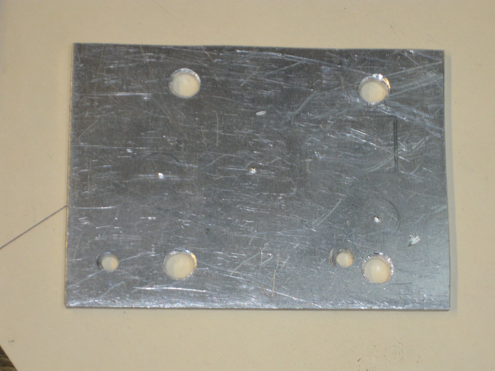

Firewall pre-drilled bolt holes were filled with dowels. New mounting points for the G-62 were drawn and drilled. A 1/8" aluminum backing plate was constructed for the back side of the firewall to spread the load of the through bolts (all will be thoroughly epoxied and braced on the inside, also). Engine was bolted up to the firewall and the cowling slid into place. TADA! Engine fits inside cowling, may need a bump for the spark plug cap. Specs for a custom Bisson wraparound muffler have been sent for a quote, the mod would raise the assembly to almost level for inside cowl clearance.
ID:	2214627   Click image for larger version
ID:	2214628   Click image for larger version
ID:	2214629   Click image for larger version
ID:	2214630   Click image for larger version
Name:	motor mount backing plate.JPG

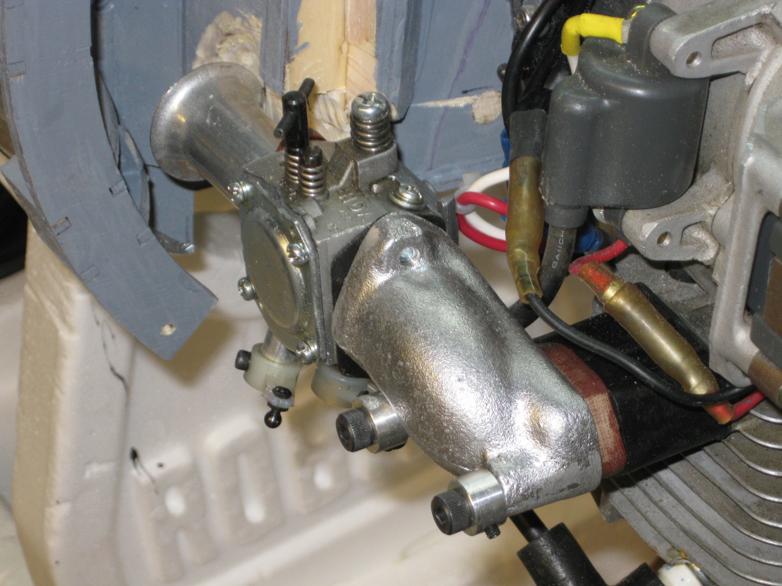

WileE,
Will the carb clear the cowl? If not, have you considered one of the 90 degree manifolds from Tony Clarke?

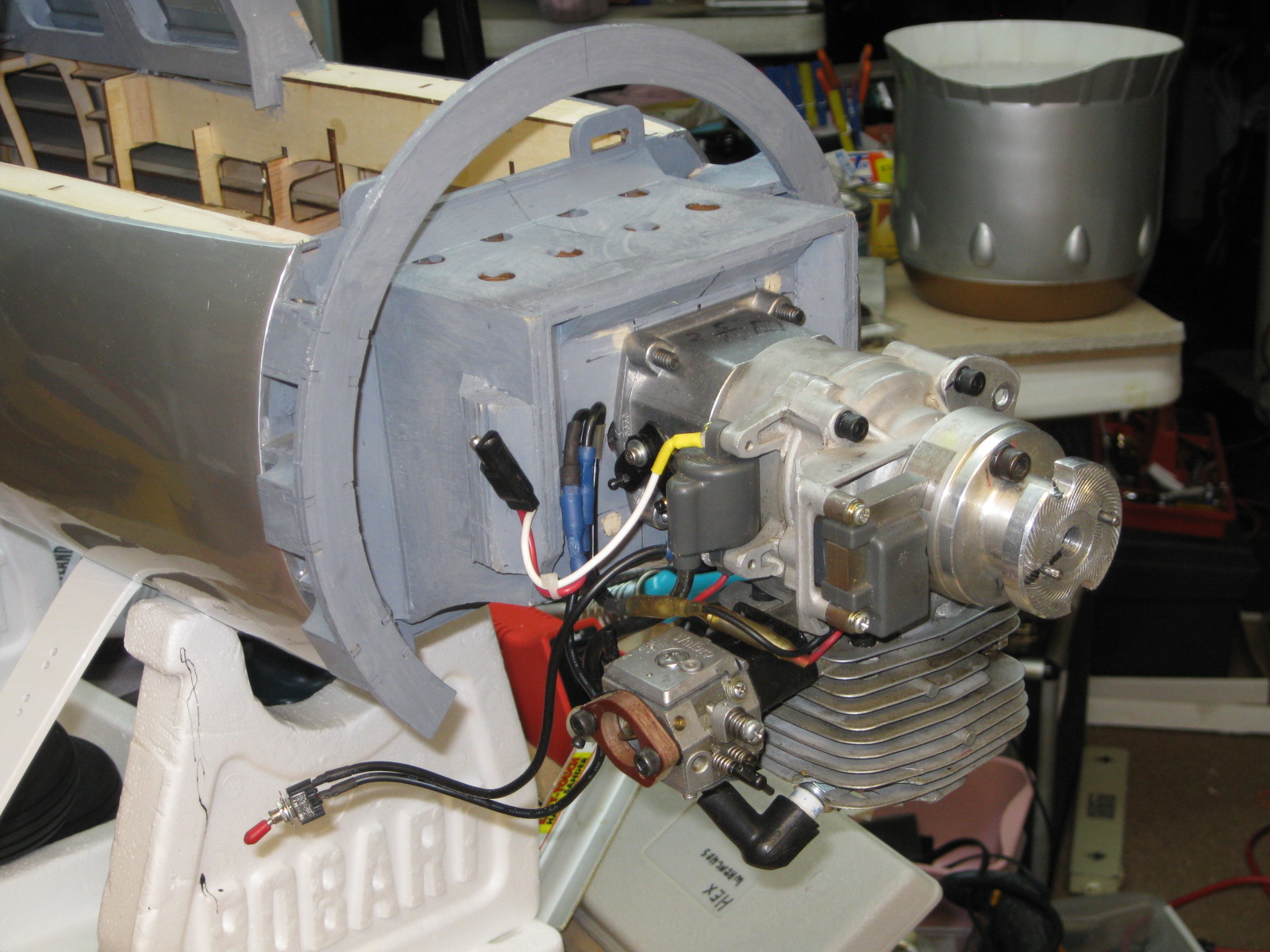

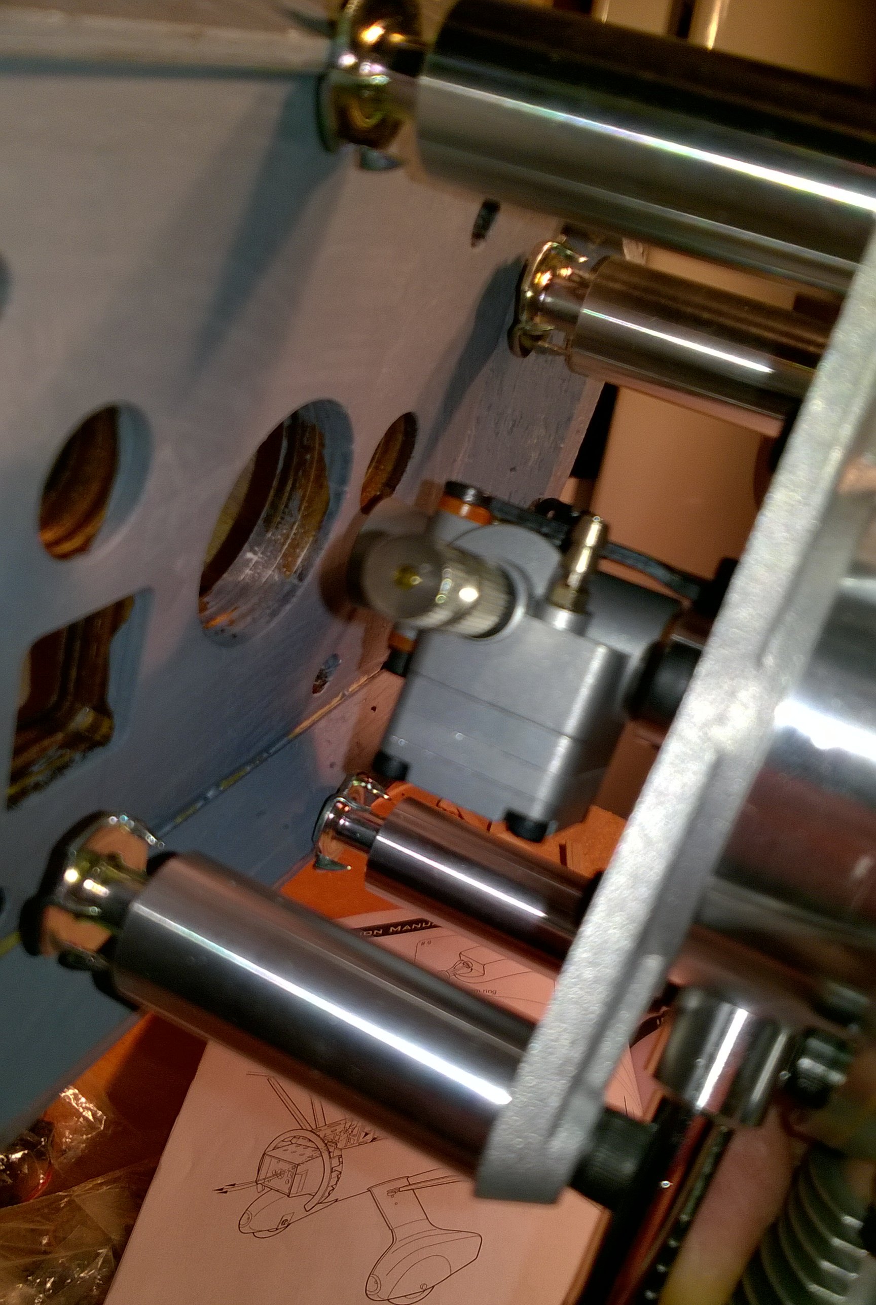

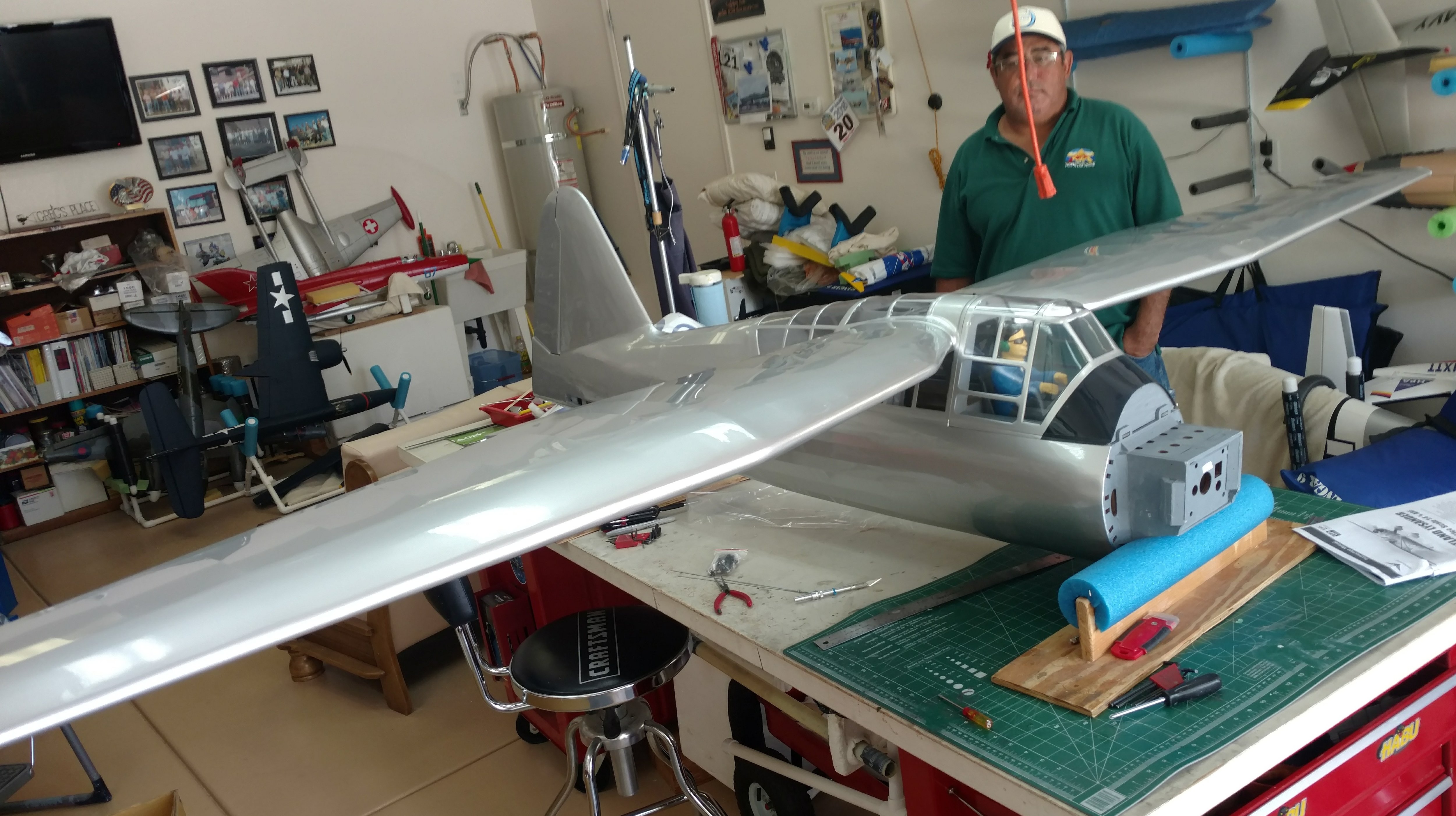

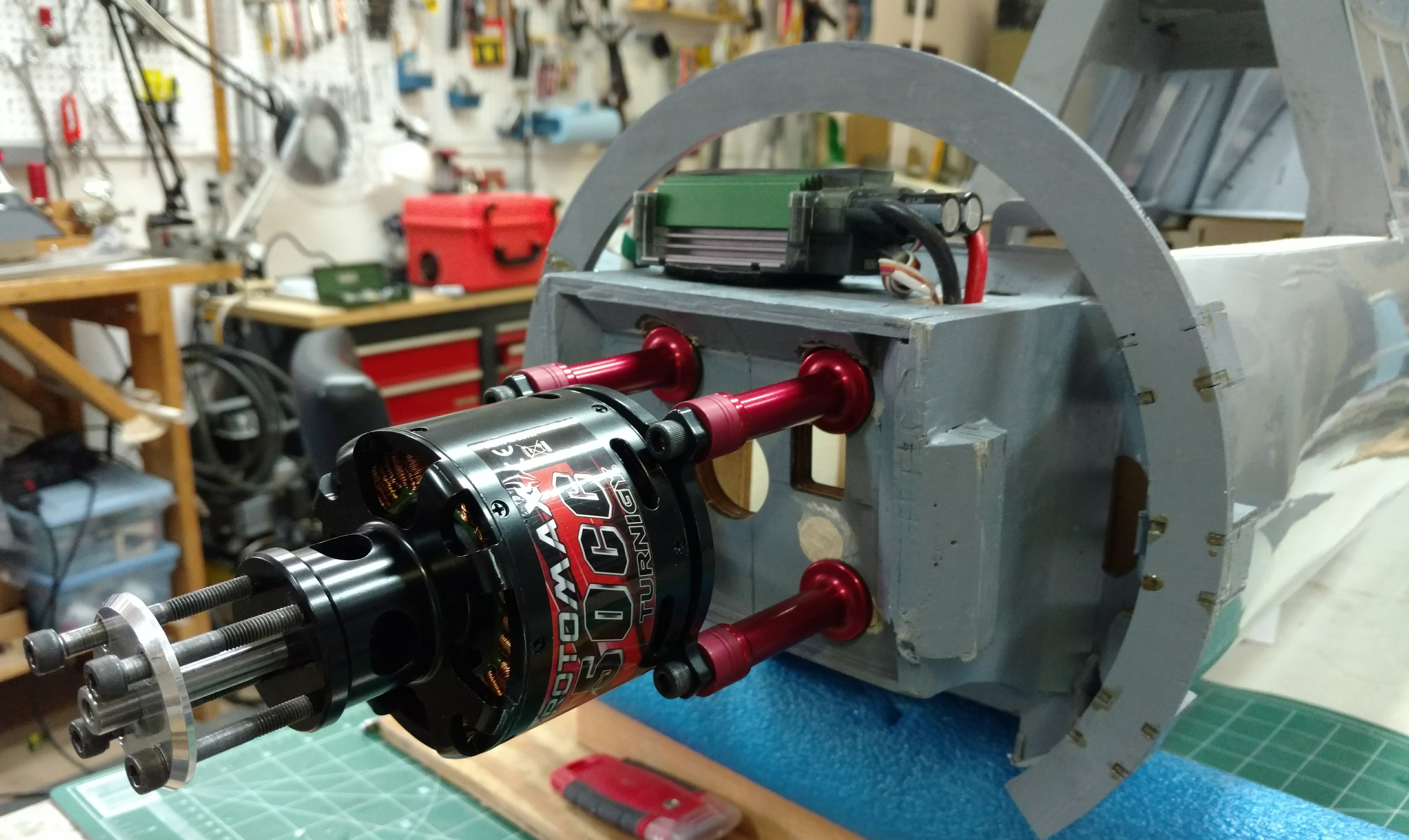

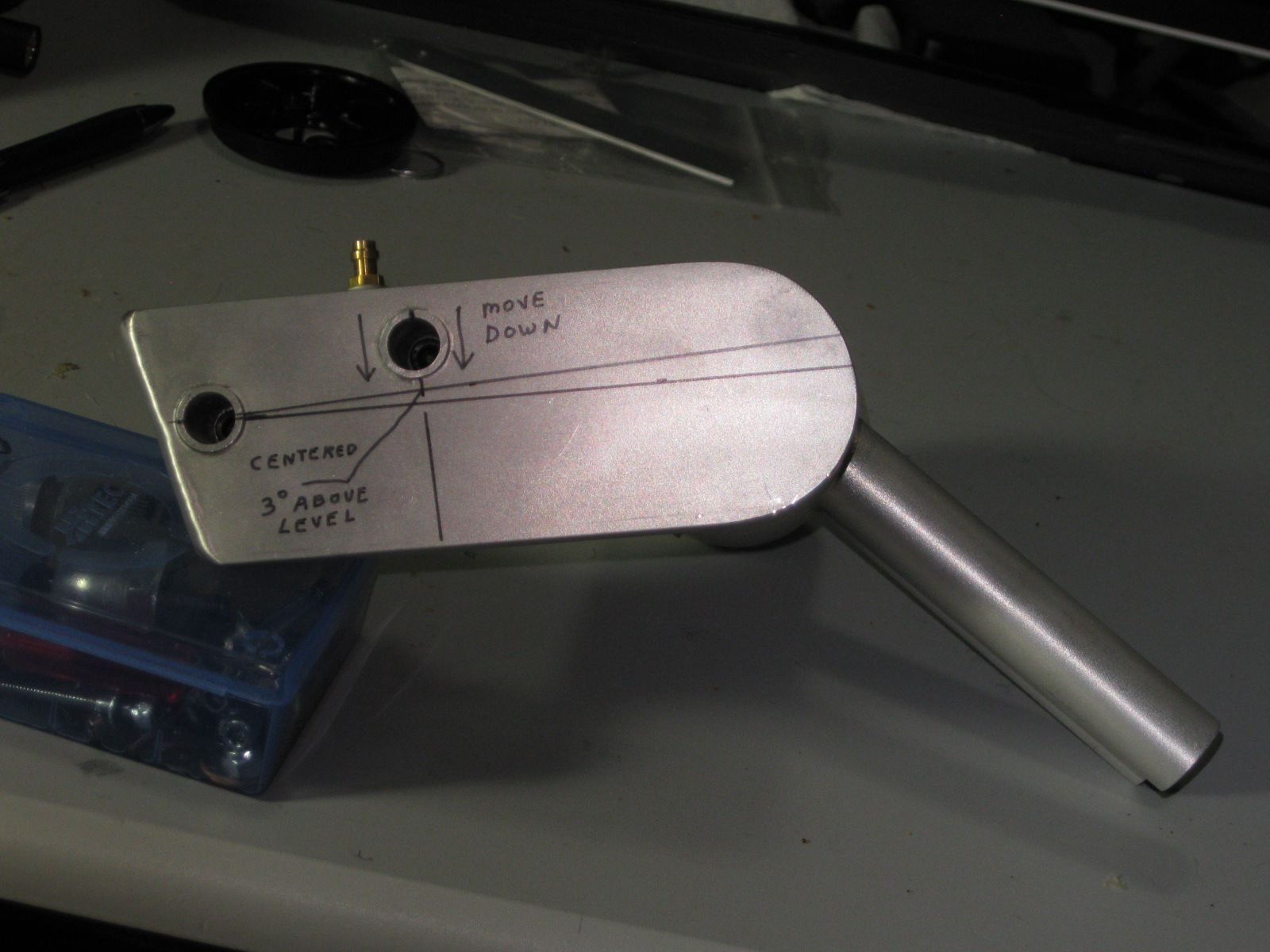

Got the motor mounted today. I also had to fill holes and re drill. My cowl mounting ring was broken also but like you said, it's no problem. Cowl not mounted yet as the dummy radial is curing. I also don't care for the hard foam wheels bit I have a pair of Du Bro 5" that I think will work fine. I am doing the Canadian Forces plane also and graphics are ordered. Also ordered landing lights and new spinner for 3 blade prop.
ID:	2214712   Click image for larger version

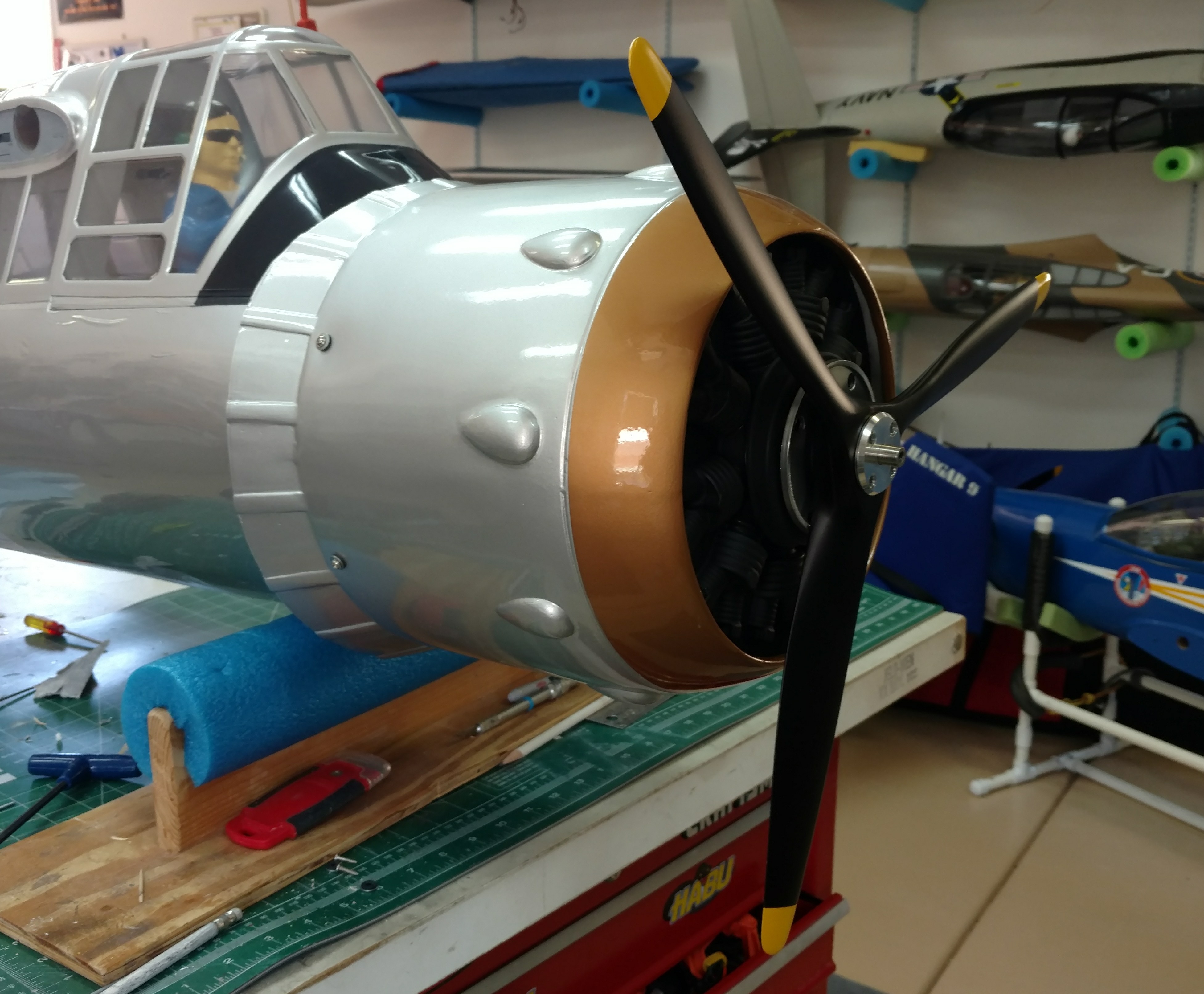

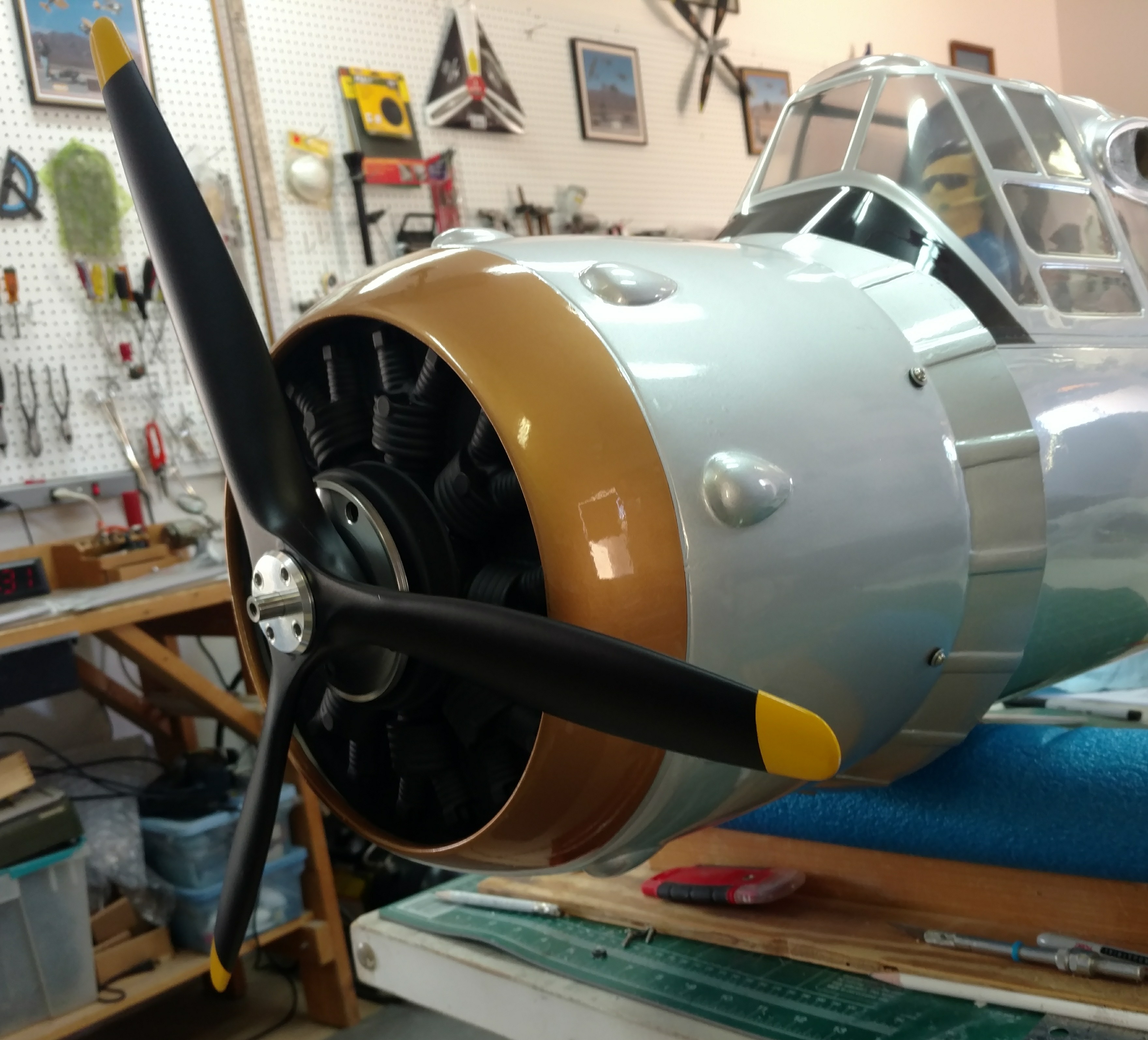

Whew! Cowl mounted! BIG job done.
ID:	2214844   Click image for larger version

G-62 engine fitment:
Using the Toni Clark cast aluminum 90 degree bend carb adapter: https://www.aeroscale.shop/collectio...um-intake-bend
and 7 mm thermal block : https://www.aeroscale.shop/collectio.../thermal-block as a spacer along with the regular carb block,
and an 18 mm intake tube:https://www.aeroscale.shop/collectio...nt=40161414791 from Vogelsang Aeroscale, plus some fine work with a Dremel tool, the carb lays nicely along the motor box. A choke rod will come out of the cowl ring and be hidden by the cowl flaps. An ignition kill switch will also be hidden in the cowl flap opening.
ID:	2215217   Click image for larger version

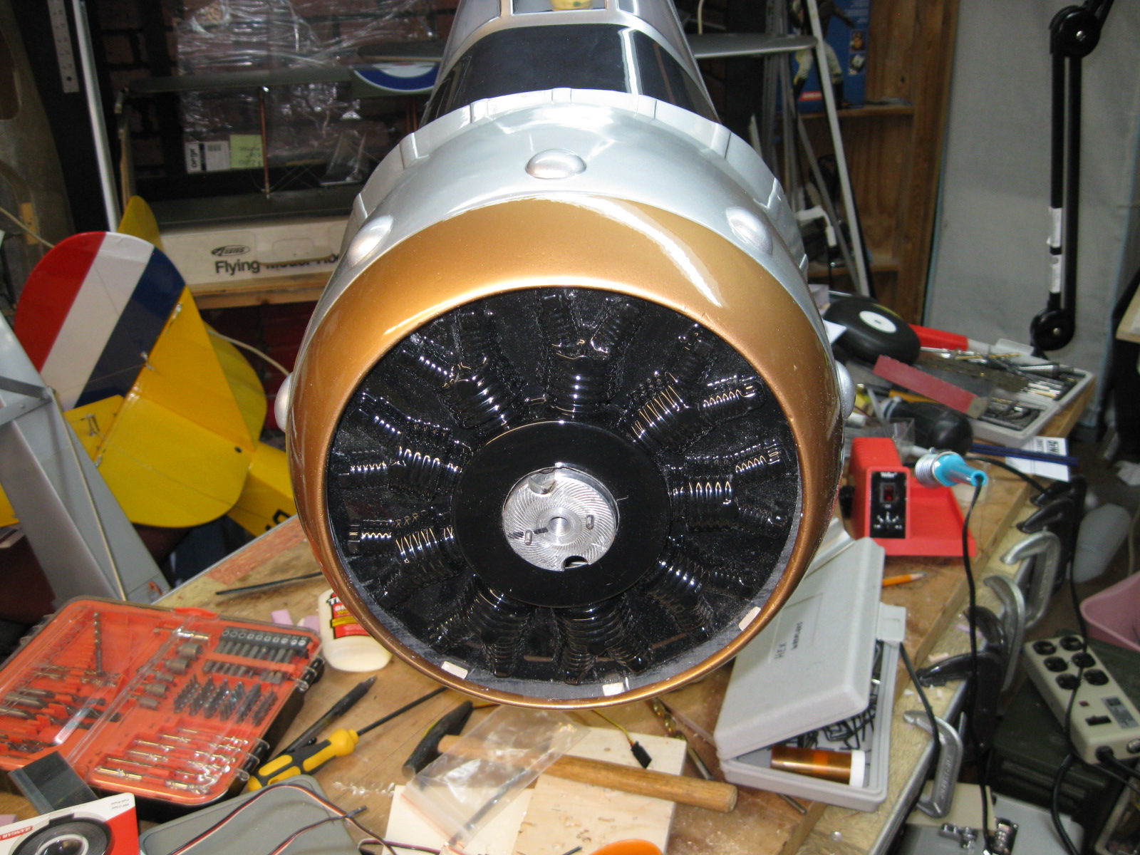

From: Novi, MI
So I have a much more complicated engine mount story, confounded by my inability to "just put it together" without alterations...
I am using the Saito FG-60R3 radial, and the mount spacing is such that the holes in the firewall will be very close to the edge at the top, even if I were to mount it upright and square (which I don't plan to, as you will see). I just bolted the standoffs to the mount plate to eyeball the position on the firewall, and you can see it's probably tight (note that the fuse is inverted in this photo)...
Name:	Engine Mount 1.jpg
To further complicate matters, I stubbornly wish to add what I consider the most glaringly obvious omission on the model, and that's the external exhaust extension on the outside of the cowl:
Name:	FS Cowl Exhaust.jpg
I could just make it cosmetic, but where'd be the fun in that... So I need to route the actual engine exhaust out through the cowl bottom side, so it can exit in the scale position. However (again), I have an exhaust ring that outputs on the bottom, which means I'd have to route it sideways, then back, etc. Which I could do, but where's... well you know.
So it occurred to me that I could rotate the engine 1 scale cylinder (as in 1/9 of the circle or 40*) have have the exhaust in the exact right spot. Problem is, that makes the mount spacing even worse...
Name:	Engine Mount 2.jpg
You can see if I am to mount it in this manner, I will need a new larger firewall to mount it to. One more wrinkle is that the instructions call for the firewall-to-thrustwasher distance to be 170mm, and I measure stock mount on the engine to the thrust washer as about 180mm already. So just doing something like cutting of the front edges of the motor box and slapping a larger firewall on it won't work unless I significantly shorten the standoffs, which will probably result in other interference problems.
To make things even worse, this motor mount is put together like a Chinese puzzle. The firewall has tabs that stick through the sides and top of the motorbox, and the sides are actually two extended plies that continue through the front former and the next two formers inside the fuse (being joined by a third ply in the process). See the single-headed arrows in the pictures below. Thus, disassembling this mess is out of the question, and some cutting must be done.
Name:	Engine Mount 3.jpg
ID:	2215451Click image for larger version
Name:	Engine Mount Inside 2.jpg
I am thinking of just cutting the whole front off the box, right behind the current firewall, along the double headed arrows above, and in the photo below. Then I think some 3/4 ply might be just the right size, and glued and pinned it might be strong enough. What do you all think?
Name:	Engine Mount 4.jpg
Name:	Engine Mount Inside 1.jpg
Hi Rick,
Yes, it would have been nice if the firewall had been just a bit bigger, although in my case, any wider would have been a problem. Any new firewall should be at least layers of 5-ply aircraft birch, 2 layers of 3/8" ply if you want to go 3/4". Regular 3/4 ply would tend to be soft and allow the blind nuts to draw into it, unless you bolt from inside like I did, then a backing plate would work. I made the backing plate because there was no room for wide washers.
I have all the correct length bolts for the engine intake side, so the carb and adapters are all attached. Have confirmed the order for a custom Bisson Muffler, so that is in the production queue.
ID:	2215749   Click image for larger version
Old 05-17-2017 | 11:47 AM
My Feedback: (56)
Posts: 167
From: Lavaca, AR

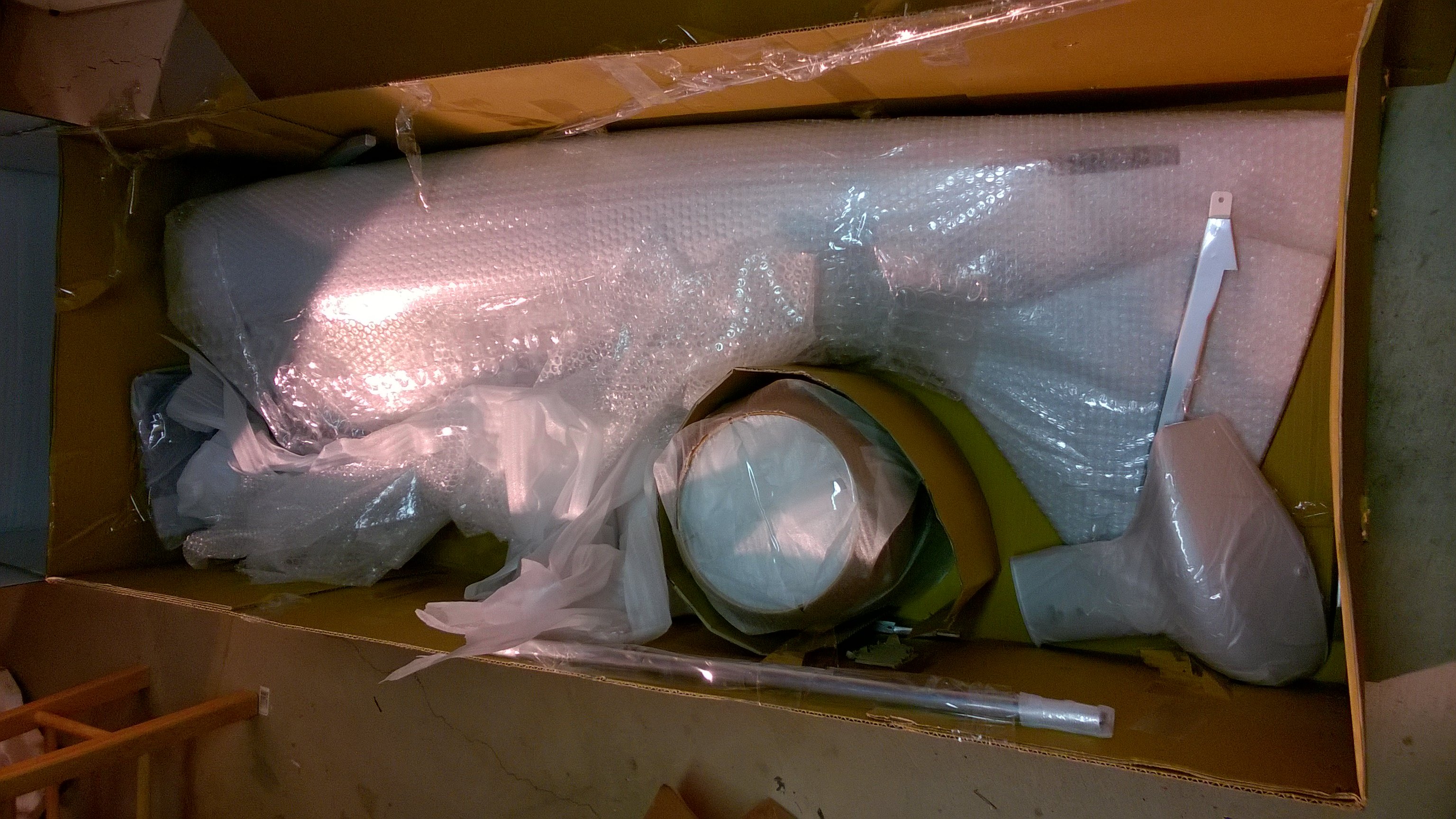

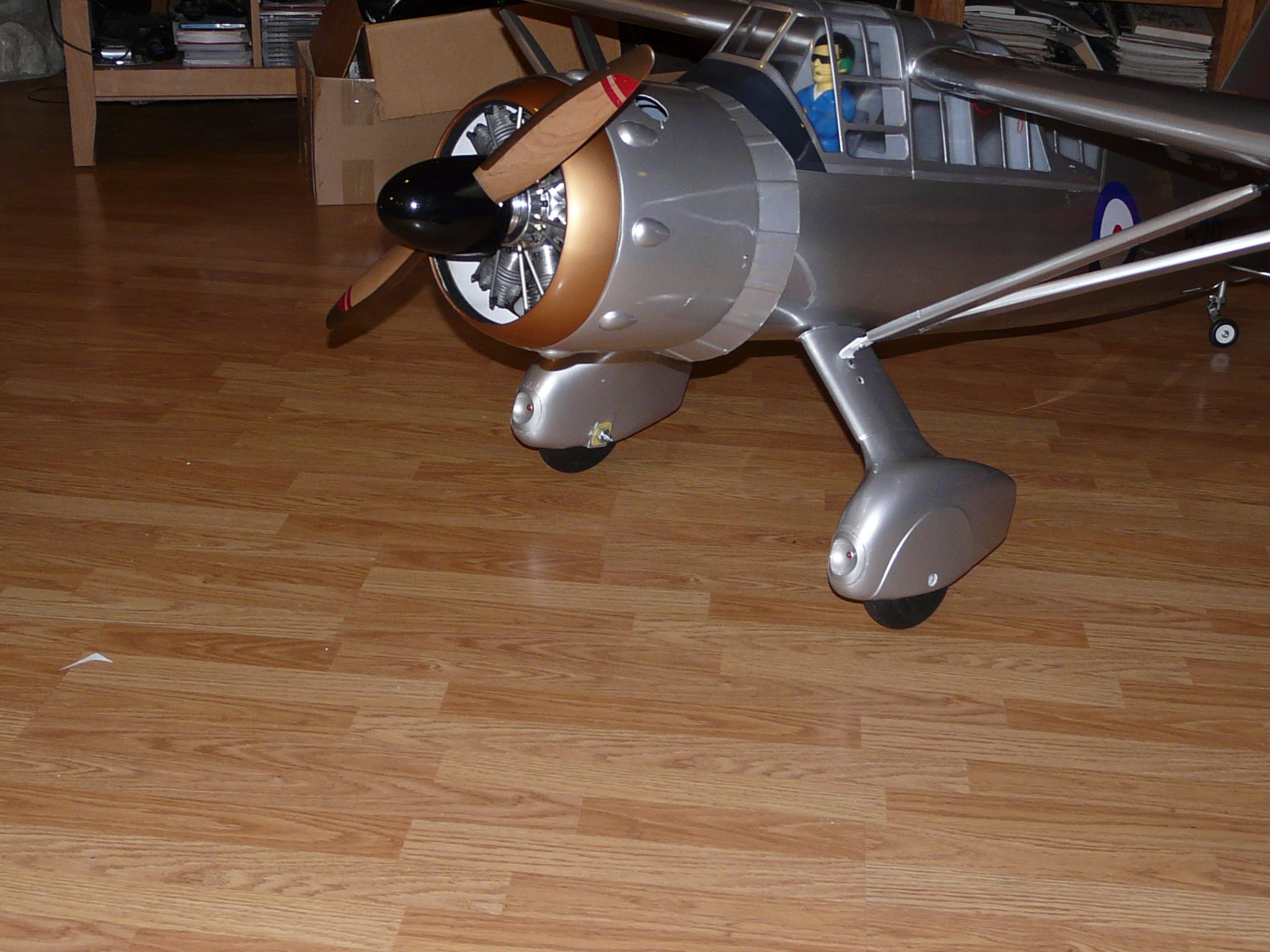

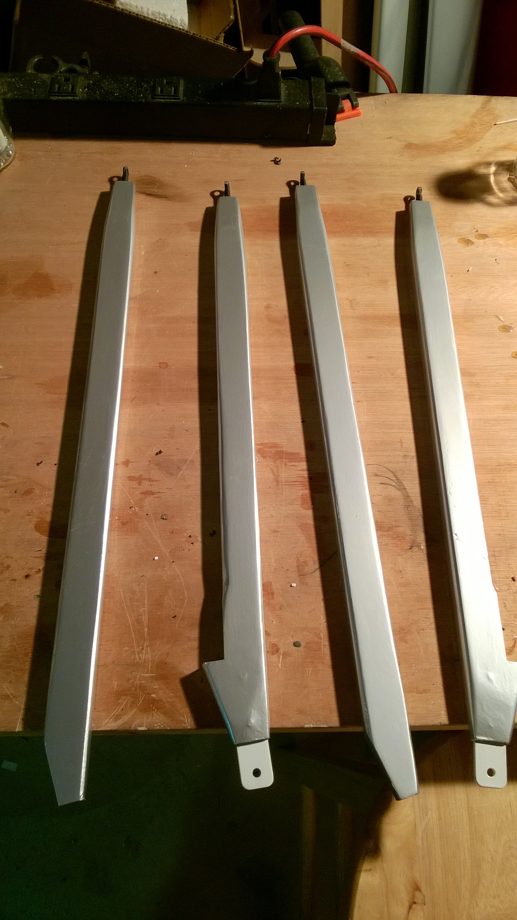

Default Big Beautiful Airplane Arrives
I received my Lysander on May 12 I believe. It comes in one giant box which was indicated to be 97 lbs. but I believe that is the way to charge for the oversize package as it certainly didn't weigh that much. The packaging was very well thought out and protective and I had no damage from shipping. I was like a kid in a candy store unwrapping the huge model aircraft encased in the box and went right away to working on it. There is on area that you really need to pay attention to and that is where to wing tubes slide into the pockets and the same whee the stab plugs in. Any covering that intrudes into these pockets or any glue smudges or irregularities need to be cut down as the fit is very tight where the structure plugs in. I would suggest that you take a piece of steel wool or schotchbrite and polish the aluminum tubes as they are a very close fit.
I had purchased an EVO 777 radial engine about a year ago and have been looking for an airframe for this engine and ordered the Westland Lysander hoping the radial engine would fit and I couldn't be happier with the fit, the look and the ease of installation. I made a mounting plate of 1/4" aluminum and cut down some of the standoffs to mount the engine to the firewall and it is a perfect fit. I am going to include some pictures of it sitting in my living room and will try to send some better detail pictures later. I have been building models for 67 years and this is the best yet.

Old 05-17-2017 | 01:57 PM
RickVB's Avatar
My Feedback: (24)
Joined: Aug 2002
Posts: 884
From: Novi, MI
In a "duh" moment, it occurred to me that it would be much easier to accomplish the same thing (mounting the engine rotated by 40*) if I just made a new back mount plate for the engine with the screw holes moved 40*... duh. So I'm going to figure that out tonight. Hopefully I have the right thickness of aluminum stock to cut it from (no mill here...).
