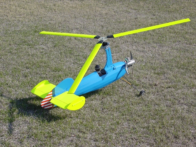

Joel,
Looks good. Looks like a Baby Kellett. Cute. Lets see some action shots. I started on an Electric convrsion last night.. Not a Gyrace thiught..
You going to make it to Muncie this year,, I plan on a west trip this Spring and sumer.
Jim
Jim
Posts: 126
From: Darby,
MT

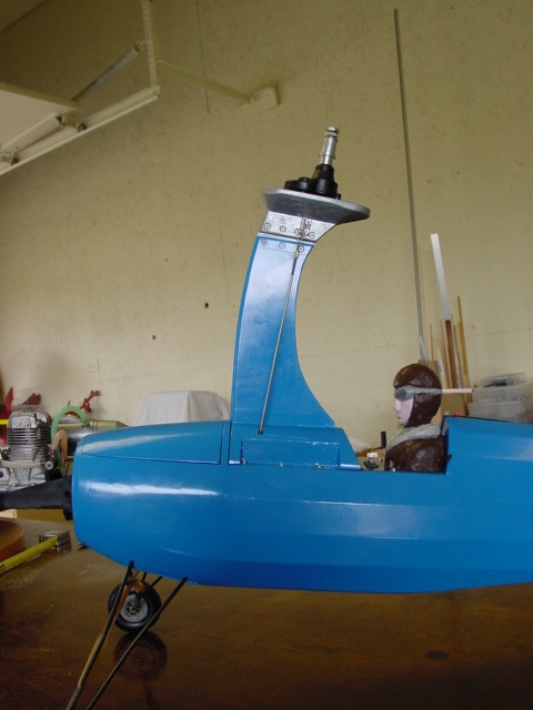

Hello Jim,
Yes It does resemble the Kellett, But it's what I would call the Gyrace II. A very much modified Gyrace. I'll post some flight photos as soon as I can get my wife to take some. If you're coming out west let me Know when, maybe we can get together here in Montana. Jim lives about 6 hours away in Spokane. We've got 10 acres, bring your trailer and stay with us for a while. Maybe we could get together with Jim and have a Western fly-in behind my barn/workshop/developement center.
I am defenitely planning a trip to Muncie in September with our Trailer.
Joel

Hello Colin,
Looks like you are on your way to building your Gyrace II. Here are a few things that may help you in your efforts. The lateral tilt has a .032" P/P hinge and a HS 645MG servo. The rotor blades are constructed from
1/4 X 3/4 spruce on the leading edge with a 1/4 X 1 1/4 Balsa trailing edge bonded to it. The root end is reinforced with 1/32 Plywood for 2" top and bottom. The rotor rotates on a Master Airscrew Reduction gearbox meant for electric airplanes, available from Tower Hobbies. I've posted four photos that may give you better insight into how my changes to the Gyrace appear up close. Good luck!
Joel
Joel

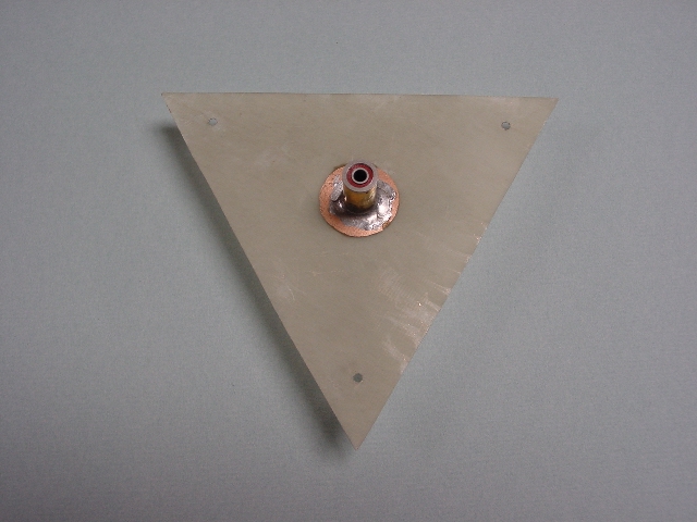

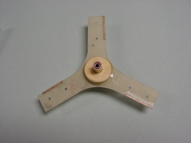

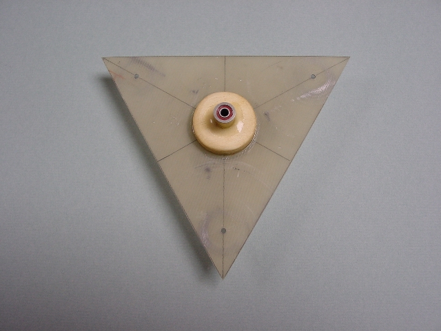

The Gyro Shtick original plan does calls for a .020” fiberglass from Aerospace Composite Products. I achieve very good autorotation, but again, very difficult to control. Is it possible that the fiberglass is too thin?

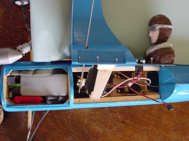

I have a second question Joel. Why did you not make your new Gyrace II single rotor a full DC? I have started construction on the ECDC gyro was actually thinking about making it like yours with only servo lateral tilt control and elevator for pitch. This would make it less complicated.
Thanks.
Thanks.
Posts: 126
From: Darby,
MT
Hello again Wahid,
Since I haven't had much success with fiberglass hub plates on smaller gyros I'd have to say, I realy don't know if .020" is too thin.
The reason I did not build the Gyrace II with full direct control of the rotor head is simple, there wasn't enough room in the fuselage for all the servos. The Gyrace II was made from an origional Gyrace that at one time had a stub wing and two rotors. I suppose it could be recongigured into full Direct control but there really isn't any need, it flies very good without the cost in dollars and weight to add the pitch control I'm already getting from the elevator.
Joined: Jul 2003
Posts: 271
From: Groningen, NETHERLANDS
The guy who built the suitcase minnies with us has the same gyro. Awesome looks! I really love it. The fuse looks a little like a fast racing plane
Joined: Apr 2003
Posts: 142
From: Christchurch, NEW ZEALAND
To Iwadmin - I use polypropylene (code 5 plastic) sheet which I find on ice cream containers at the supermarket. Look for the 5 within a triangle. I also use polypropylene that I found in a shop selling table place mats. It was clearly marked `polypropylene` and one placemat is enough for several hubs, - and very cheap too! Thickness - only about 20 thousandths of an inch but I have found this OK, (for up to .40 power) and nice and flexible, stiff hinges are not wanted! However I am interested in comments from others on this subject.
Colin Duthie.
ps - Hope to have photos of my Gyrace 2 tomorrow.
Colin Duthie.
I use .030 Lexan on my Kellet.It is stiffer than poly but I like it because it gives more stability to the rotor.It's available in the hobby store in the race car section The mfg is Bolink R/C Cars INC an 8 by 10 sheet was $3 I believe they have different thicknesses also I am using this on the hinged part of the Kellet pylon.Not for rotor blade attachment.
