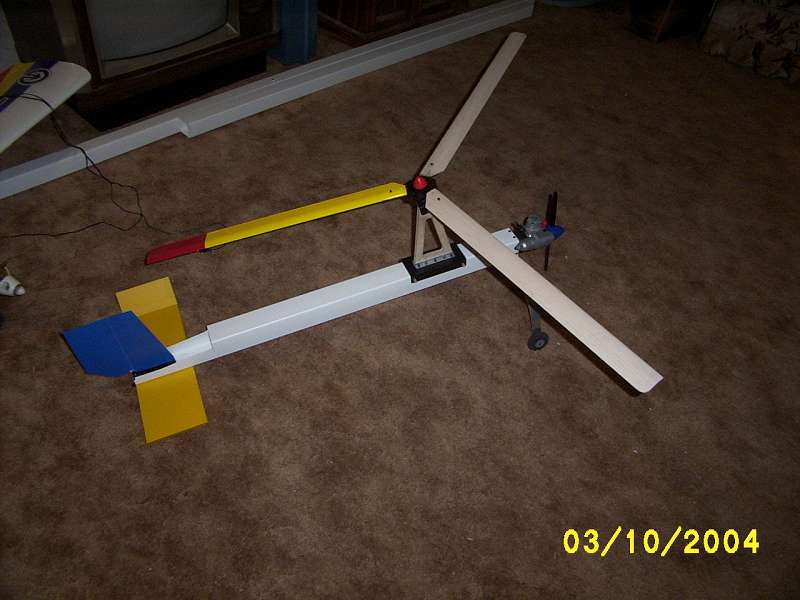

Thats not my gyro in the link but i am trying to built a gyro out of coroplast. I have built 4 sets of blades which are all broken now and have achived only 2 flights in a 3week period. i am frustrated now!
My current plane which is much better than the other attempts is made out of coroplat fence post peices and 3/4 aluminum U channel. The mast is a peice of 1/4 inch music wire. rotor hub is a 2 blade desing made out of 1/4 inch plywood and 1.5x.25 inch lattice blade mounts. Hinges are american gutter pipe which is flexable and durable for about 35 hard impacts with the ground. My blade were set to flap to 45 degrees both ways wiht blade stops. The blades were 2mm coroplat flat bottom airfoil with a5.5 inch chord and a .5 inch tall spar and a 48 inch rotor span.
I also tryed a twin gyro with two 30 inch counter rotatiing rigid rotors.
Now my problems are not consistant at all. The single hinged rotor gyro wanted to roll over into the asending blade for so reason unknow. But i did it it to fly once wich lasted about 2 mins when the plane all of a sudden decided to nose straight up and then lose control from about 100 feet up. my models are rudder elevator type with a small 20 inch flat stab behing the mast fixed with alierons. After this flight i couldnt get it to fly again. it kept rolling over into the acending blade. One time it lifted straight but it nosed straight up and fell back down hard onto the ground. i have a 10 degree mastangle 10 degree downthrust in my saito 91 and about a 15 degree hang angle. The blades spin easily once the ground roll starts but i just cant get consistant results.
The twin rotor version fly once also but the plane ran out of fuel after takeoff and autoed down. it didnt fly again either due to a roll to the left on take off. It always rolled left but so how i managed to kick in enough right rudder to roll it straight on takeoff. It also has 10 degrees of mast tilt and 10 downthrust. The rotors were set about 7 inches above the fuselage. No diheadral in the rotor boom. I tryed one simlar to the one in the link above but it was over weight but lifted rolling over to the left ripping one of the rotor blades off the bottom rotor.
For my desings i used the average spec from www.autogyro.com to figure all of the measurements. I have been building spad fixed wings for about 3 years with great success but this gyro experiment has me really confused because every little adjustment never leads to a consistant result like dealing with a fixed wing.
Anyone have any ideas to why my gyro attempts are failing?

I'm no expert, but it seems the consensus is that two bladed rotors just don't work very well. I'd redo your hub and make it a three bladed rotor.

I am really glad to see that you fellas are giving the autogyro a shot. Gyros are very complex and require a lot of time. Don't get frustated and give up. Walk away if you need to and come back with a new purspective. There is plenty of help here in the gyro forum. It may take a little time for someone to get back to you with some info, just don't give up on your efforts! One thing is for sure, if you get your gyro flying, you will be the envy of the flight field!

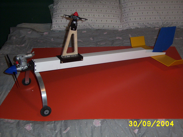

Specs wing scrap 60 inch wing cut down to 42 inches. rotors 2 25 inch 2mm coro rotors attached to the wing with long 1/4 inch steel bolts. fuse coro/ fencepost and alumin u channel. H stab20x11 V stab half that. saito 91 for power.
Flight report= great This gyroplane flew very well with some right trim needed but its a very stable slow flying gyro. it lands almost vertical like a parachute. Finally i have one that flys and flys great. Now my rotor hubs need to be reworked and it will be a better flying machine. Sorry for lack of spec but this was throw together rather quickly. :grin:

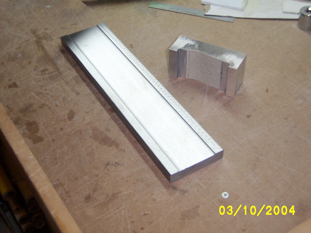

Love those in flight pictures! You have truley created one of the most unusual SPAG's I've seen to date. Sure hope my project goes as well....we'll see shortly. I made a bit more progress this weekend by building a rotor blade sanding fixture (no coro blades yet). I was able to produce 3 blades this moring. Things are looking good.

Balsa blades are too darn aggrevating! I like your design but its way too much work for me. the hub at least. I am trying to keep the S in spad LOL plus i counldnt get the single gyro to fly or none of them without wings. Well i did make one flight with the single gyro but it lost control and crashed. Anyway i made me some ball bearing hubs for my rotors and plan to test this afternoon. The gyro is cool tough and stands still in a stiff breeze!

i got around to weighing my plane and its a wopping 8.8lbs! MAn thats heavy for somthing that flys so light. my scales are right because i checked them. The wing on the plane is 44x13 so its not near big enough to fly it without the rotors.
I also straped the gyro wing onto a standard DPS spad design and it flew with the small tail feather to my amazment. The short 30 inch pvc fuse was too short though as yaw was a problem. it was powered by a TT pro 46. Landed it vertical. weight was 6.6 lbs on it.
Also one of my rotors is not spining as fast as the other during normal foward flight however when i auto down for a landing both spin equally. Why is this?
I tell you what this is darn fun!
