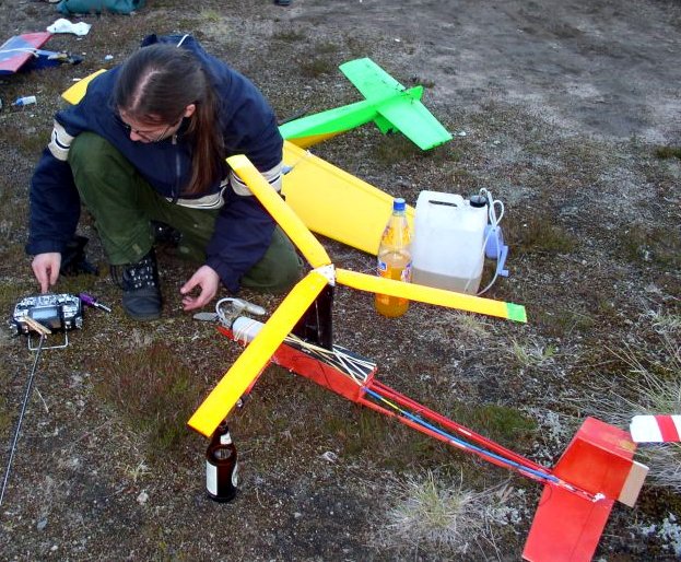

Isn't it the same material, which is used in fuel cans and candy boxes? I use the plastic, which the fuel cans are made of. Don't worry, the can was empty before cutting the hole It has worked well for my autogyro for tens of flights. I also used the candy box plastic first but it was too hard plastic. It broke off in a hard dead stick landing.

It seems that bilf is going to send you some polypropylene. I still answer to your question. I meant a fuel can like the white one on this picture. It is maybe a bit too stiff for small hubs. I don't know how it works in winter times in -20C. I'll send you a report if the plastic will fail in cold weather.

SO your talking about glow fuel jugs? i Have plenty of them but i tryed using it and it streched bad when i applied light pressue against the badle stop and proved to be too weak. flexable yes but very strechable. My blades also dropped all the way down i had 10 degrees down flex limti and that stuck there until it was spun up. How much down flex limit shoud there be?
