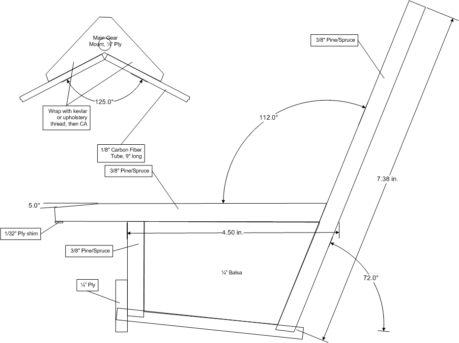

Here's the first drawing for the G3PO.
I will post more details as I get them.
I will try to work up a full parts list as well.
The frame is 3/8" pine, 1/4 balsa, 1/4 glass tube and
some 1/8 carbon tube. I use upholstery thread or
kevlar to wrap the tube to the 1/4 ply landing gear mount.
The Landing gear mount is beveled so the gear is roughly
straight down as shown.
The bottoms of the mast and other front piece are groved by
wrapping 60 grit sandpaper around the glass tube and sanding.
The parts are CA's together heavily, the tube is CA' in the groove.
I glued the wood parts first then groved the hole bottom.
Note that the tailboom angle is downward to provide some
blade clearance.
I'll put up the bits regarding the wire axles, tail wheel, fin mounting
as I get them done. I'll make detailed photos also..

This drawing is to scale.

Ok, so now I have a picture and the higher resolution .jpg on the website.
I downloaded my own drawing to look at it and it seems readable.
Let me know if I need to do something else.....

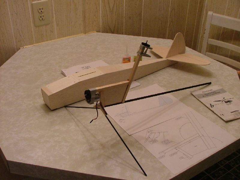

I built another G3PO tonight after dinner and made more streetlight runs.
I built this one from my own plans to make sure everything is ok on the plans.
I have updated the drawings slightly to make the landing gear mount more
robust. Will post new diagrams soon. The new drawings print out on 8.5 x 11 paper
full size so you can use them for templates for the main body, fin, rudder and landing
gear mounting plate.
Jim is sending me an AXI outrunner to try that I will report on ASAP.
Only critical test item left is the aerobalsa 1.5" blades. I have them prepped for
covering and only need install blade reinforcements and drill holes. Perhaps tomorrow
evening.
I have the construction down to 6 wood parts, 3 of which are just pieces of 3/8 square stock.
1 of which is the 1/4 balsa filler, then the LG mount and the fin mount, that and the fiberglass
tube and CF landing gear are the only chassis parts.

Ok, here's the lowdown on G3PO-B.
I built the current one from my own plans that are posted.
The easy thing to do is cut out the 1/4 balsa piece then
shape and glue the 3/8 stock around it.
I made the tailboom 24-1/4" inches to give myself a little more
blade clearance and allow for the part sticking through the LG mount
hole. The landing gear mount is about right but needs
a little more beef below the hole, so I'll correct the drawings soon.
However if you are building one add some thickness below the hole.
I glued the servos on with zap, the ones on the mast are also zip tied.
Tail is built as shown on the diagram.
The ground handling is still excellent, I can drive around in the street at
high speed without tipping, so I wouldn't mess with the overall attitude,track and wheel
locations.
Rudder servo is glued to the body upside at the bottom of the mast.
I used dacron 1/2 control line for pull pull control.
Weight about 13 ounces with the razor and 3 cells.
It needs a touch more downthrust so if you are building, build in say 8-10 degrees
or leave it where you can modify it. It will vary with power available, my razor setup
has lots of thrust.
Aerobalsa 1.5" blades cut to 15", weighted and covered with trim monokote.

Flew G3PO in the daylight with the axi.
It flies very nicely.
A flight note, turns take a healthy dose of
up elevator, with right turns taking more than left.
It has a lot of roll/pitch control so its wise to take it up
high and experiment. I will post video on the website
sometime today of the low speed flying with the
axi powered, aerobalsa blade model.
Note that I added a tail boom brace, this pushrod tube
was more flexy than the other one and needed it.
The symptoms of a flexy tail boom are really bouncy
handling on the ground and it tries to lift off too
early.
I'm going to add this brace to the plans, because it
weighs next to nothing and really helps.
Its a bamboo skewer and a piece of 1/4 balsa.
The pointy end of the skewer is wrapped with thread
and CA'd to the tail boom.
ALSO, the axi motor mount let me move the CG forward
some, It now hangs with the mast straight down + 2 or 3 degrees,
i.e. the CG is slightly ahead of the mast. This made a nice improvement
as now you can just feed power in and it will ROG without any help.
It reduced the pitch power somewhat so I may move it back slightly.
My rule of thumb is now mast straight down or a tiny bit more nose heavy
than straight down.
Here's the axi motor mount I whipped out and a detail picture of the head
showing the shaft length, anti-rotation link, and trim setting of the swashplate from
the side. The side to side swashplate setting is roughly level. This was the trim
position during the morning video.
mickey
