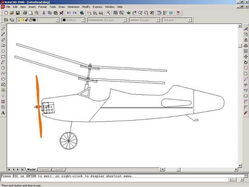

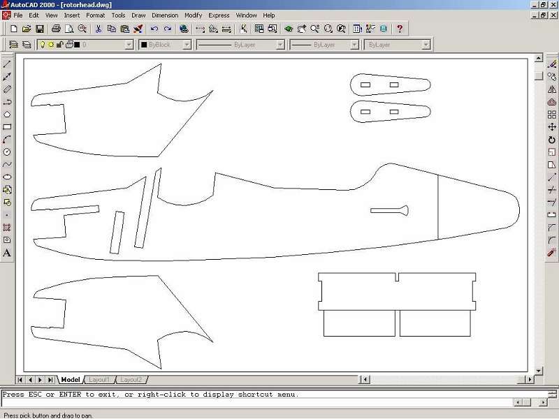

Here is what i'm thinking.
A twin rotor (counter rotating)
12" blades
25" total rotor span
E-flight 370 Brushless motor
GWS gear box 6.6:1
12x6 prop
AUW 13oz or less
If i'm way off base let me know.

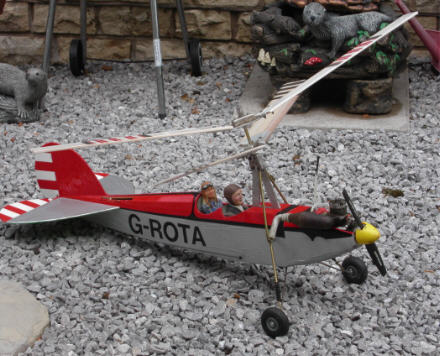

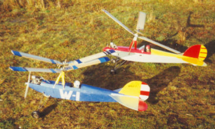

This looks like a model from a plan called "Al's Gyro". It was quite successful so should go well scaled down as per your plan.The "coning angle" of the blades was quite critical.I will e-mail you the magazine article. A photo is attached.Bill
It's doable but you will have to be quite weight consious. Read the RCM info about Al's gyro for ideas. I am sure Gyronuts can help as well since he has similar experience.
Good luck,
Bob G
