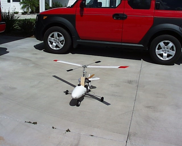

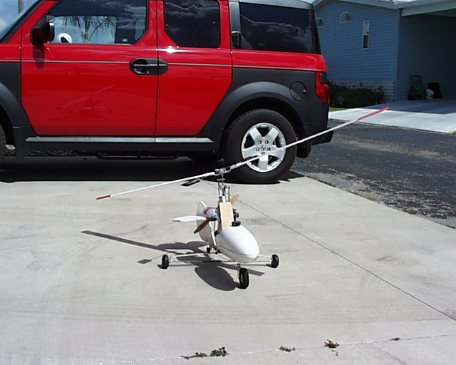

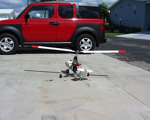

The Wallis actually flies. I had a 10 to 15 mph wind almost down the runway and I made two failed attempts and both times it got up about 5 feet and it would just sort of hover and I couldn't get the nose down. I just didn't seem to have enough power to penetrate the wind. A 60 size 2 stoke is recommended but I'm using a 52 4 stroke. I made a few adjustments and added more weight to the noise and the third try up it went. I have flown a lot of gyros but none like this one. Orientation was a serious problem. I made two successful flights and it's the most awsome gyro that I have ever flown. It actually flies more like a helicopter. Very fast forward speed and the fuselage pretty much stays horizontal as opposed to most gyros that fly nose high. Landing was easy. It would hover right down to the ground just like a heli and the wind certainly help. The pictures are after the flight and I will try and get some video if I can get it into the air again.

I went back to field to try and get some video, and I did, but It's not exactly what I wanted. It was late in the afternoon, flying into the sun and I made it off the ground but the engine sagged so it was a short flight. Almost made it. I tried again but the muffler came off and went through the prop and you know what that does.

Thats really cool! What are you using for the head a swashplate? i saw the flybar but its hard to see the head in the pic. it kinda looks like a teethering head in the pic.

Hi Grant,
The autogyro is a Wallis kit made by Micro-Mold back in the 70's. I got it from Bill Friedlander at the Gyro meet here in Spring Hill. Bill got it from a fellow from England so it's been around for awhile.
The head has a swash plate with a flybar which gives it cyclic control. This is my 2nd pusher and once airborne it flies great. Getting in the air seem to be more luck than anything. I'm using a 52 4 stroke and they recommend a 60 2 stoke so I'm low on power. I suspect more power would improve my chances on takeoff.
