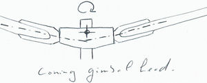

I have a question.
On the Wallis which is a pusher, has a cyclic control head, and a pre-rotor spin up, direction are to set the blade pitch to zero degrees. It was suggested that the blades could be set slightly positive and should improve lift.
I started at 2 degrees positive and went up to 5 degrees positive. I didn't plan on the 5 degrees positive. It was due to a field adjustment after a bad landing and I didn't know it until I returned to the shop and checked the blades with a heli pitch indicator that I had positive 5 degrees.
Anyhow, even a slight positive pitch on the blades really adversely affects control. It will attempt to roll over on the ground during takeoff and anything over about 10% throttle the nose pitches up violently and is almost incapable of making left turns.
With zero pitch on the blades it's very stable but anything even slightly positive it handles terrible.
Any explanation?
Thanks, Phil

Rotor speed is too low. It probably won't maintain autorotation for long at that high of
an angle. Until you have enough RPM for the flybar to be gyroscopically stable and
have enough airflow for the paddles to work, the rotor just goes where it wants to.

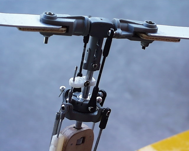

I'm very interested you trying this. I'd be willing to help if
you need it.
I used the GWS dragonfly head, modified to take Aerobalsa blades.
I think the PT is a little bigger and heavier. I'd suggest the TREX 450X head.
It's collective pitch but easy to lock down at a fixed pitch setting.
What's especially nice is the parts are really inexpensive.
I can photo my TREX head if you want a look.
You can use any servo. I'm using the $14 (9 grams) GWS picos.
For the TREX head any of the micros will do, HS55's,
pico's, MX30's, etc.
My TREX running > 2000 RPM is using MPI MX50's ($19 each)
with no problems at all.

Phil,
Here's the parts you need to make a TREX head.
You can get them from www.like90.com (Indianlatic FL).
Flybar Paddle $6.95
Flybar Rod $3.95
Flybar seesaw holder $7.95
Main Blade Holder $9.95
Main rotor housing set $3.85
Main shaft $6.95
Feathering shaft $6.95
swashplate set $10.95
You'll probably want to get some
linkage balls and short ball links too.
You can use their bearings, or find some of you own.
The assembly manual is here :
http://www.align.com.tw/html/en/asse...x450xen_2.html
You don't need the washout unit because you are not
going to do collective pitch.
You will just have to make straight pushrods to replace the washout links
and this will hold the swashplate in the correct vertical position.
mickey

Hi to all,
I'm getting a little bit confused on the coning angle issue.
how do you determine the coning angle of a flapping hinge rotor?
what value would you recommend as the best compromise between stability and manoeuvrability?
The project I'm working on, is a gimbal rotorhead with fixed coning angle (see picture, of course not scale), which I hope will act like dihedral on plane wings, to provide additional rotor stability.
Did anyone experiment this configuration?

Coning angle does NOT act like dihedral.
Coning angle is a negative thing that you try to
minimize. More than 9 degrees is supposed to
create control problems.
Start with your gyro weight, say 3 pounds.
You want about 1.25 ounces/square foot/per blade, so
you need about 13 square feet. This is about a
4 foot diameter ( 2 foot radius).
The blades need to be about 10:1 length to chord
so you need about 2.5 inch blades, 24 inches long.
Divide the total gyro weight by the number of blades, say 3.
Then you need 1 pound of lift per blade.
The blades are 24*2.5/144 = .4 square feet.
The tip speed to make enough lift to fly is
between
v = 50 * sqrt( lift per blade(lb) / area per blade (ft^2))
= 78 feet per second, = 78/radius/2/pi*60 = 372 RPM
v = 71 * sqrt( lift per blade(lb) / area per blade (ft^2))
= 112 feet per second, = 112/radius/2/pi*60 = 535 RPM
The blades should weigh about 3 ounces.
The centrifugal force on 3 ounces is
= ( blade weight(lbs) * O * O * K)/32.2
O = rpm in radians per second = RPM*2*pi/60 = 39 - 56 radians/sec
K = radius of gyration = sqrt(blade length * blade length / 3)
= 1.2 for 2 foot blades.
so the centrifugal force per blade is between
CF = 3/16 * 56 * 56 *1.2 / 32.2 = 22 pounds.
and 3/16 * 39 * 39 * 1.2 / 32.2 = 10 pounds
The lift per blade is 1 pound.
The coning angle is between 1/22 (radians) or about 3 degrees.
and 1/10(radians) or about 6 degrees.
You will get slightly more than this due to blade flexing.
Note that the "apparent" fore and aft coning angle will seem higher due
to blade flap as a result of forward flight.
If you try to force a coning angle other than this you will be creating
extra stresses in the blades. And there are aerodynamic disadvantages
to higher coning angles anyway.
mickey

Hi,
thanks for taking the time to give me a full comprehensive answer.
It seems that I have to overwork the design of my homebuilt head, alas.
What do you think about 0 offset hinge(on a 6 lb DC pusher)?
I know I could take an ARF and avoid most of these questions, but I'm having more fun with designing than with the flight itself, so forgive the bore.
best regards
Thierry

Posts: 511
From: Wimauma, FL
I have the TREX head mounted on the PT Gyro and it was ready to go. However, I have been unable to get the blades to spin up. I can't get the head spinning fast enough to allow the fly-bars to start controlling. The head just wants to till side to side. The Wallis has a pre-rotor that spins the head until the fly-bars take over. I tried using an electrric drill on the Wallis but I still couldn't get the head going fast enough.
Mickey, what's the secret to getting the blades spinning and keep them from flopping side to side?

Joined: Aug 2004
Posts: 469
From: longwood, FL
Lock the blades down so they are very difficult to move.
Then put them perfectly straight.
A little hand flip and it will all straighten out.

Posts: 511
From: Wimauma, FL
Mickey,
Before I got your message I have already modified it. I have removed everything and connected the swashplate directly to pitch arms. It now spins up good and it seems to control. What do you think it will do? I have uploaded a picture.

Phil,
It looks like your up and down elevator is going to give you up and down collective
pitch. Is this your intention? I'd like to hear your thinking if it is.
mickey
