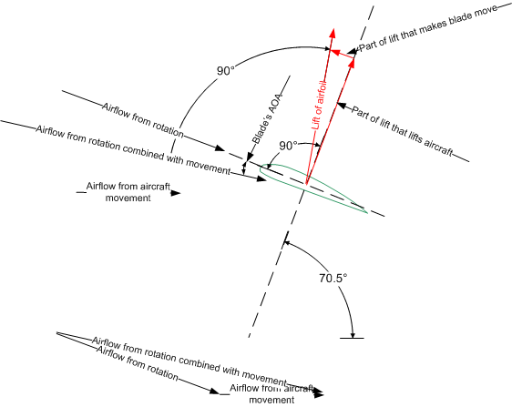

Joined: Aug 2004
Posts: 469
From: longwood, FL
They are both kinda right.
Basics: Angle of attack, the angle that the air flowing into an airfoil
makes with respect to the line where that airfoil would make no lift. (the
line through the airfoil where the airfoil makes no lift is called the
zero lift line (ZLL).) So angle of attack is the angle that the incoming airflow
makes relative to the ZLL.
Measuring angles with respect to the aircraft, the ground, the rotor shaft is
all kind of waste of time. What matters is the angle with the local airflow on
the airfoil.
Here is a diagram for the advancing blade.
The local airflow is the sum of the rotation and movement.
THe blades sees +10 degrees. The lift is roughly 90 degrees from
that, the part of the lift that is tilted forward makes the blade move, overcoming
drag. The other part of lift is what lifts the aircraft.
mickey

Now THAT is a helpful diagram. I saw it clearly.. The lift on the airfoil at first is quite forward causing the blade to move forward. Then as the blade spins faster and faster due to this, the AOA gets closer to blade directiong of travel than plane direction of travel and the lift angle moves closer to mast angle and therefore ceases to continue accelerating the blade, and a balance point is found. The rotor continues to turn.
I was really happy about this until I studied the drawing too long. If that diagram had drag angles included where would they be and why wouldn't they stop the blade. Isn't drag about 90 degrees from lift? Maybe one blade wouldnt move forward by itself without the balancing drag on the other side of the rotor from the other blade?
The wing out the car window thing still has me hung up. I just can't get it.. Here is another drawing showing you whats going on in my mind. Look at the drawing and please tell me what angle you would have to set the AOA of the airfoil so that when the air nozzle is turned on, the blade moves forward, toward the nozzle. I can't imagine there exists such an angle since drag would blow it away from the nozzle in all situations.

Joined: Aug 2004
Posts: 469
From: longwood, FL
It never will. Move the nozzle down and aim it up a few degrees and then it
will move forward. The only thing you have to do to keep the blade turning is
have the total resulting airflow below the plane that is square to the rotor disk.
This is accomplished by tilting the whole thing backwards.
All you are trying to get is some force in any direction but straight downwind,
in your nozzle example if you set the airfoil to 10 degrees, you get lift at 100 degrees.
Now tilt the whole picture 15 degrees down and the airfoil (now at -5 degrees with respect
to the GROUND but at +10 degrees with respect to the WIND) will be producing lift at 85 degrees,
and will thus move forward with respect to the ground.
mickey
P.S. this is exactly why a glider (sailplane) goes forward, not backwards.
