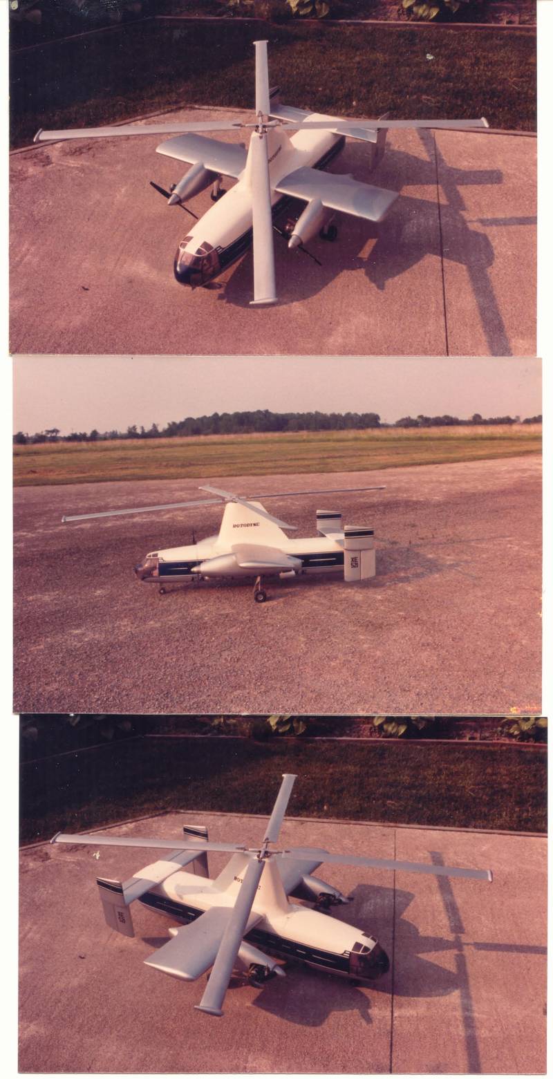

I found this image in the net.
It shows Don Incoll of Healsville Australia with his Fairey Rotodyne autogyro.
Has anyone contact to Don? Does anyone know something about his model?
A Merry Christmas!

A 600 class, is something such as a graupner speed 600, great planes uses them to i think, i believe its comparible to a 540 size almost the same maybe, correct me if im wrong cuz im not sure, I run two BL, high end to power that beast, even small gyros are hard to push with small motors, I have a G3po i dont used right now, needs rebuilt again, cause my bl wouldnt pull it, and it was around 10-12 ounces, and i have around 16 ounces of thrust, to give you an idea, also it comfortablly swings a 10-3.8 prop or a 9-3.8 which i prefer for more RPM and better effiency with similar thrust. Id look into to big himax motor or axi's but then you need to escs(ouch my wallet crys thinking about that king of thing.
Joined: Nov 2005
Posts: 24
From: Aalen, GERMANY
Hi!

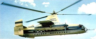

It's true that the original Rotodyne had tip jet engines at the rotor blades. I think it's impossible to realize as a model.
Don Incoll built the Rotodyne as a true autogyro with free rotating rotor. That's what I plan to do. So any ideas or any contact adress to Don?
Stefan
Stefan

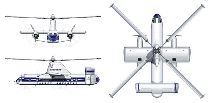

I think the full size Fairey Rotodyne was a true autogyro when in forward flight, the tip thrusters being used for take off & landings only. So it was a part time helicopter that coverted to a true autogyro. In model form therefore as an autogyro it would be fine. Interesting machine thats promising future was cut short.
Hi,
It looks like the Fairey Rotodyne's rotors didn't have a positive angle relative to the fuseledge. I think all of our models have at least 10 degrees for the rotors so any model without the tip thrusters would also require a positive angle. Just a thought.
Phil
Phil
Joined: Apr 2003
Posts: 142
From: Christchurch, NEW ZEALAND
True, there does not appear to be much backward slant, however there is a lot of information on Dogpile or Google, etc, and it states that in forward flight all power went to the forward facing props, none to the rotors. It did however have small wings so some of the load was taken by them. For model purposes it would be necessary to build in the rearward slant of the rotor shaft to give the rotors a positive angle of attack.

Serus ciervapilot and all the autogyro nuts,
there is a model of the rotodyne, excluding Don's, that flew but as a helicopter. The model was built and flown by Jim Morley, an Englishman, now in retirement, who had a company producing model helicopters.
DETAILS TO THE MODEL.
Using his words the model had:
a wingspan of just over 3 feet (>.878 m),
a length just under 4 feet (<1.171 m), this makes the model approx. 1/15 scale
a rotor dia. of 5 feet (1.524 m) and
a weight of 14 lbs (6.36 kilos).
The chassis, mechanics and rotor head originated from the Maverick helicopter (produced by his company).
Engine was an OS 61. (Only one engine was used)
Rotor head was standard Maverick with conventional helicopter functions.
Secondary shafts were connected, under the wings, between a clutch and Maverick tailrotor gearboxes mounted in the engine nacelles.
To overcome the torque the props, both rotating in the same direction, worked in a push - pull mode. The port airscrew, with negative pitch blades, pushed and the starboard airscrew, with positive pitch, pulled.
Each airscrew was constructed from Maverick tailrotor components and had variable pitch blades. A special boss was turned from alu to accept four blades.
One servo (for the airscrews) provided pos./neg. pitch for one airscrew and a reverse function neg./pos. pitch for the other. This simulates the function of a tailrotor.
A second servo provided pos./neg. to both airscrews, this allowed forward flight or taxiing. Each airscrew was a mini rotor head.
A video of this model "A Fairey Rotodyne Story" is available (VHS, no DVD and PAL only) from [link=https://sslrelay.com/s84068217.oneandoneshop.co.uk/sess/utn;jsessionid=1543b56075ad1ba/shopdata/index.shopscript]Traplet Publications[/link] the price is 9.95 BRP (without postage).
I have spoken with Jim Morley with the hope that he still has plans available. At the moment he is searching his hobby room and garage. Should they turn up I'll leave a message on the forum.

Hi one and all,
the Fairey Rotodyne plans have now arrived.
According to all that I have read the British Government ordered the destruction of all plans and documents pertaining to the Rotodyne, but I can assure you that these are not a figment of my imagination.
These are digitized copies of the original Fairey Aviation Company 3D plans (original scale 1:24). They are bitmap files (TIF) and are not suitable for plotters [
] (too much background clutter) even a printout may need a lot of ink but they are useable
Anyone who would like a copy should contact me by P.M. Because of the file size (1 @ 558 kb and 1 @ 782 kb), I can't post them here.
I'm looking for any other information (plans, videos, photos, ads., etc.) relating to the Rotodyne. Any info or tips will be more than gratefuly accepted.
Looking forward to any mail.
Regards, Karl.

Over 25 years ago I built Rotodyne for two .45 glow engines. I think, the diameter of the rotor was approximately 60”. The rotor head did tilt back, but not enough for proper autorotation. The restriction on the tilt angle were these two vertical fins at the tips of stabilizer. At that time I did not know that on the full size plane, they were tilted to almost horizontal position when taking off or landing. I remember running the model up and down the runway at high speeds. The rotor was spinning but not fast enough and the stubby wing was not producing enough lift for the model with relatively high wing loading.

Hi Ladislav,
that was a very nice looking model, pity you couldn't get it into the air. I imagine that it must have been very frustrating after all that hard work. Whatever happened to the model?
Regards. Karl.

Hi Karl.The model was destroyed after it was sitting in my workshop for years. I created plans from plastic kit I purchased. I do not have original plans. I know that whole model was built from the Styrofoam. Sorry for quality of photos but that is all I have.

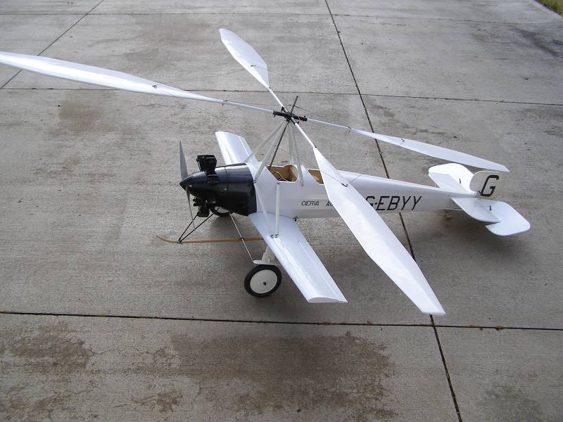

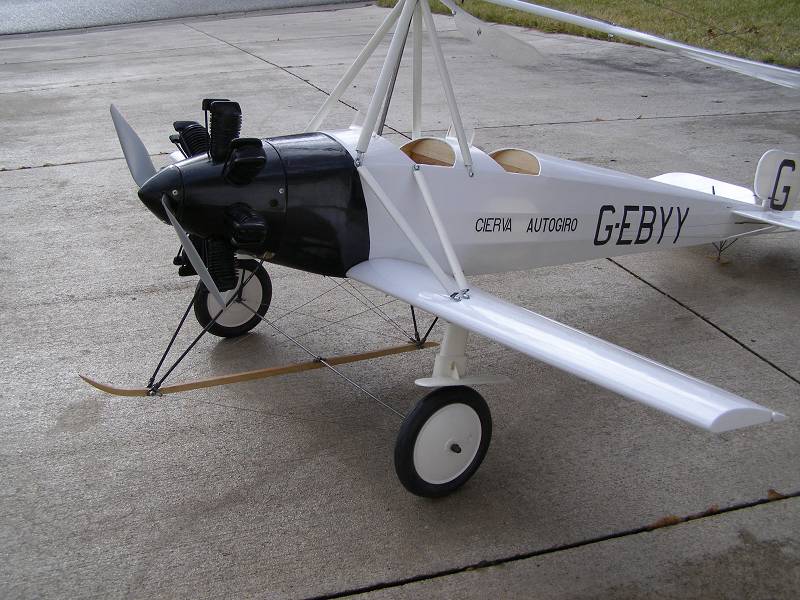

Here is photo of my other Autogyro. Scale model of CIERVA C.8L-II with 76” diameter of the rotor (1:5.5 scale). The model was built from the balsa, plywood, steel and carbon fiber. Flying weight 8.5lbs. Power AXI 4130/16. Will be test flown in the spring 2007. Some tests were done already. The rotor was tested on the windy day to find out if there is issue with blades tracking properly and if there is vibration. There was no problem with that. The rotor generates lot and lot of lift. The rotor mast can tilt 7 degrees left to right with heavy duty servo. The advanced blade can flap upward by me using thick wall carbon fiber tube for main spar. The downward travel is restricted by steel cables. I have seen full size C.8L-II hanging in Paris museum.
Ladislav,
WOW! Congratulations on an absolutely beautiful model... one of the nicest I've seen pics of. Best of luck with your test flights in spring.
Nice work Ladislav,
You have a beautiful model there.
Best of luck with your flight tests.
For what it's worth:
I noticed that you have ailerons on the stub wing. I had ailerons on my Gyrace as well & found them to be not effective.
I disconnected them & covered them with Ultracote & do not use them.
Happy Flying,
Bob G
