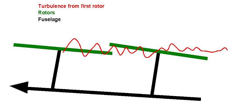

[ul][*] Are the rotors supposed to rotate to same or different direction in tandem configuration? [*]How much there should be height different between the rotors? [*] Are both rotors supposed to move to all directions or is it enough to have the control in either rotor? (Which one?)

The rotors must rotate at different directions to overcome lift dissymmetry.
The hight difference between the two rotors is not critical, as there are no flapping hinges required. The rotor blades are just installed in a rigid manner.
Georges Chaulet (JoJo) achieved to build a flying tandem model. He only used rudder control and fore-aft-tilt of the front rotor. It seems to have been adequate.

The reason I asked the height difference is the turbulence from the first rotor to the second one. This turbulence has a negative effect on the sesond rotors lift with high angles of attack. I tried to explain the problem in the picture attached. This is the same reason, why in Rutans Quickies rear wing is much higher than the first one.
Rutan's Quickie
I am trying to imagine the lift situation with two counter rotating rigid heads. For me it would be almost the same to make rigid or flapping heads as I have a access to CNC-machine.
I still haven's started building my other twin rotor autogyro. I might build this one instead of the original idea. The blades (6* 33cm) are already made.
