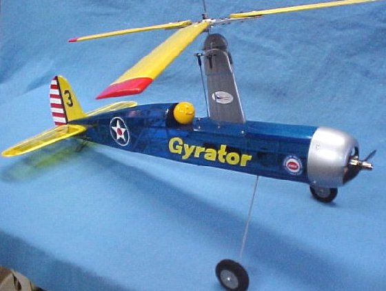

Well, my Gyrator test flight was yesterday. I guess you could say it was sorta successful. It was overweight (20 oz.) which makes everything else worse. It has a 30" dia. delta hinged 3 blade rotor head, (706 sq. in) with a 4 oz./sq. ft. loading, 5 channels and is powered by a throttled Cox TD .049.
Considering the 2 - 5 mph. wind, the rotor spun up pretty well during my run up to hand launch. Their was no tendency to roll or yaw to either direction upon hand launch, so I was happy with that. There just wasn't enough power/lift to gain more than 25 - 30 ft. altitude going upwind and it sagged to 5 - 8 ft. going downwind.
I took it home in 1 piece and immediately began carving weight off the rotor hub and rotor pylon. I ordered some more aileron stock today to build a new, lighter set of blades and will finish them in dope instead of film covering....that should reduce the weight and make it even more stable. I ordered some carbon fiber rod to make lighter pushrods, will change the .35 oz. throttle & rudder servos to .19 oz ones and am considering changing the 230 mah NiMh battery to a 120 mah. Hopefully, these mods, along with a different prop will make it flyable.
Here's a pic:

After further consideration, I've decided to change the rudder, elevator and throttle servos from the .35 oz. to the .19 oz. ones plus reduce the battery size to a 120 mah NiMh. I have a 4 channel homebuilt "Pizza Box Flyer" type plane that uses all 4 servos constantly during hover. I just have to monitor the voltage and field charge after 1 or 2 flights. Every tenth of an ounce I can find will be slashed! No need to lug around more battery than I need to get a successful flight.
The other thing I was thinking about was removing the ply neg. incidence shims from under the rotor blades. Early tests with the delta hinged rotor head and my shop box fan proved that it would go into autorotation without them. Maybe removing them will give a little more lift??

If I had a gyro that looked that good, I would leave it on the mantle.
Be careful when reducing the weight of the blades as you will loose stability if you get too light. I can't tell which airfoil you are using on your blades, but the SG6042 profile will provide much better lift. In tests that I have conducted, a set of 55" diameter SG6042 profile blades out performed a set of 74" diameter clark Y blades. The 55" blades turned much faster and created a much more stable gyro. Also the SG6042 blades will spin up without any shims.
Best of luck and keep it looking nice.
