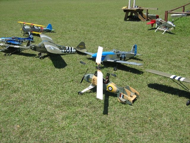

Here's a pic from a recent WarBird Fly In in Ft Worth. Had it there for static display only but had a LOT of people asking if it was going to fly. Hope it comes through. Uploaded but don't see any attachment message. Tried twice, let's see if we get 2 of the same pic or nothing.
Woopie, the blades are pretty wide and undercambered, covered in a white glossy adhezive backed material. Would appreciate any info you could send. Have some copter guys in the club that want to take a look at it but not sure if they need specs first.

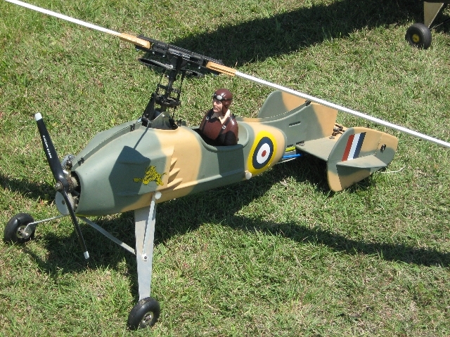

OK, 2 pics. Here is another angle showing the blades better and some of my other WarBirds in the background (blue P-51 and L-4 on the right). Looks like a fat blade, likely the original. Also have a boxed spare pair and covering. Doc[img][/img]

She looks to be in great shape. Has this Wopper been flown??? Have your helicopter friends check the Whopper after you recieve the instructions. Send me a PM with your address.
Sorry to hear you only have the original under cambered blades. The Clark-Y will be almost impossible to come by. The under chamered work, but need full power almost all the time. Not as easy overall as the Clark-Y.

This thread has been quiet for a while. Our club had a Warbird Fly-In this Saturday. Took the Whopper and had a couple of heli guys check it out. Told them about all the caveats and we decided to have one of them fly it.
Good news, it flew twice. Bad news, not very well and not very far.
First crash loosened up one fo the tail feathers. Second flight took off tail feathers and bent the rudder connecting rod and broke it's attachment. Put a hole in the fuse.

The damage looks more like hard landings rather than roll-over take-offs. Did she fly at all? Was it a hot humid day?
One thing: I know the Whopper flys using the original blades, but it's work. If you get her back together I would consider making up a set of AeroBalsa rotor blades.

Your description of second flight is indication of just not enough head speed and a too-soon application of up cyclic & elevator that didn't help the head speed. If she did break ground, an immediate application of left rudder would have leveled the Whopper and more than likely the head speed would have increased enough to allow a climb-out. Without addiquate headspeed, cyclic roll just isn't there for a rapid leveling.
Did ya find the broken out fuse pieces? Fuse is made from PVC and can be best glued with PVC "water thin" solvent. PVC clear pipe cement can be used, but sparingly as it's slower to evaporate and will soften the rigid pvc till it does evaporate.
To reinforce a fuse crack, I'll lay a piece of 3oz. fiberglass behind the crack and apply PVC solvent and let dry. CA can be used but is brittle.
Check the pitch change rods and the swashplate plastic inner ring for damage.
