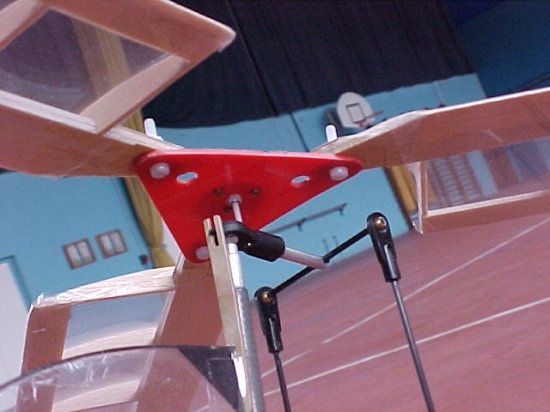

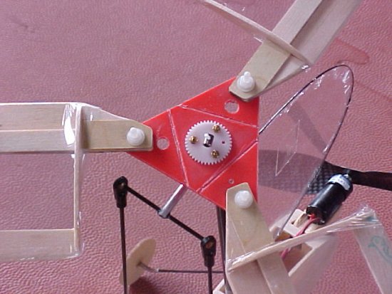

Here's a couple of pix of an indoor D.C. gyro I found somewhere on the web...I think it was done in France. I kept them because of the blade construction and the clever D.C. control linkage. Hope it helps you "get the juices going."
ps: Make your blade airfoil as close as possible to the SG6042. It autorotates easier and creates more lift than a Clark Y, IMO.

Thanks for the pics, Dickeybird - they helped a lot on giving ideas onthe control system

Now the pylon... Pretty straightforward as you see in the pic, quite more complex to explain...
- The pylon is mainly a CF tube. At a certain height, it has a plywood piece (it's like the base of the pylon) glue perendicullar to it; this is what fits into the fuselage, and could be secured either with a couple of bolts, some strong magnets, etc.
- There are also some side reiforcements to avoid the CF tube to tilt sideways.
- The CF tube has a slot under the plywood base. This slot fits in the pllywood profile, and should carry most stresses onto it.
- Servos are screw to a small balsa piece, which is glue to the CF tube.
I'm not much convinced with this kind of structure. It looks light because it's mostly a reinforced profile, but for some reason I don't fully enjoy it.
