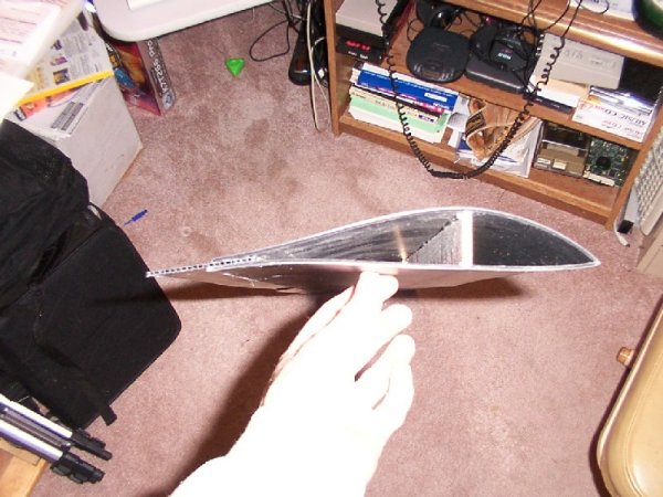

Those "Ugly" SPAD Correx planes can be made in an evening. Some I've seen look better than many balsa things I've seen covered in film.
You can make an aerofoil blade (wing) in tens of minutes. The correx is folded in half over a wooden yard stick ~ SPAR. I don't think they would require any addtional weight as the material is heavier than Balsa. Normally the Planes end up lighter as they don't require any framework (ribs, logerons etc).

I've also been thinking of making Blades from Correx. I have a GIANT Huff & Puff with a 21cc McCulloch Petrol Engine still in need of it's blades. The project keeps getting put back further down the list.
I hope you try some Correx blades, be interested in how they work!
