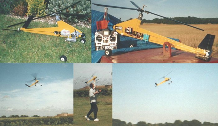

Thought you might like a look at my own design 'Whirling Dervish'
The idea was to build something easy to fly and stupidly simple to build. I have tried it in various arrangements with different types of hubs.
The V-Tail did work ok but gave lateral stability problems in strong winds. This was replaced with the conventional fin and tailplane which works fine in all conditions.
I tried a 3 blade conventional straight hinged hub and a delta hub with 15 degrees of delta. Both seemed just as good but the delta hub gave a faster spin up which made ground launches a lot easier in low wind conditions. I did try a two blade hub but initial spin up was more difficult and the lift was definitely not as good as the three blader. I will try the two blade hub again after a few alterations as it is easier to build than the three.
Power is from a TT GP.10 with an 8x4 prop. Flies around nice on half power and a 2 oz tank lasts for ages.
I hope to make a plan for it after I have tried out a few more alterations . Right now it uses DC roll and has an elevator for pitch, it also has a rudder. I might try it fully DC just to see how it goes. Also I am going to try and build some of Hal De Bolts quick and dirty blades for it as that would make rotor construction easier for the beginner.
I know it is simple and unexiting to look at but the idea is to try and get a those starch wing enthusiasts to have a go at gyro flying.
Anyway, hope you like the pictures

Hi Sean, it looks great!
I like your simple, straight forward design. What is the rotor dia. and the final weight? What did you make your fuselage from? (Looks to be a profile?)

Hi Dickeybird
Thanks for your generous comments.
Rotor diameter is 32" and the all up weight is 22 oz. This gives a disc loading of just under 4.
Profile fuselage uses 5mm balsa sandwiched between thin plywood. Engine and fuselage mounts are 5mm sq hardwood set into balsa prior to glueing on the hardwood sides. The rear fuselage is open construction with 5mm sq spruce top and bottom with balsa strip infill. Pylon is similar.
I have flown all DC on some of my other designs but by fixing the rake it makes setting up easy for the beginner. Also the hang angle is easy to find as you just hold the mast and check the rear of the mast hangs vertical.
Elevator pitch does work very well as you say, to be honest I could do with making the elevator a little larger as at low power settings the pitch response is slightly limited though not a serious problem.

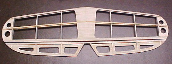

Attached is a better image showing the fuselage construction and an image of the delta hub. You will notice the hub is a virtual carbon copy of Jim Baxters design. Its simple and it works really well so why change it ?

Ahhh, simple & light construction! I usually seem to do OK in the lightweight aspect, but the simple part....nope! Too many sticks and little tiny parts.
I was worried about low speed elevator response during the design phase of my 'gyro so I used a thick, airfoiled stab to give more lift when needed than a slab surface. I used an Eppler E168 airfoil (12.44% symmetrical) and it works GREAT! Here's a pic:
