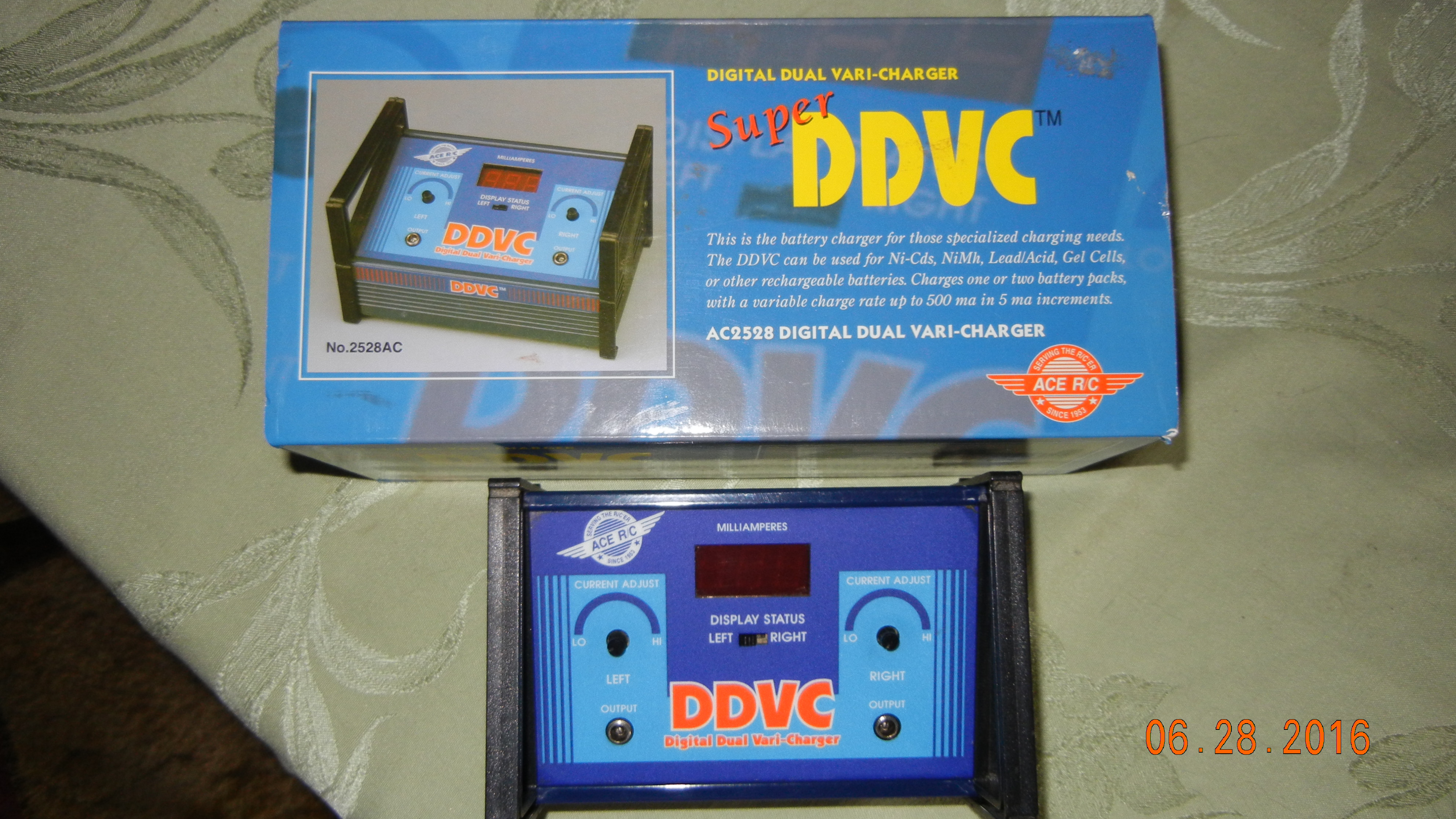

Does anyone know where I can get my DDVC repaired ? Any Info would be seriously appreciated !

[ATTACH]2170065[/IMG]Sorry I wasn't more clear on the DDVC. It is a charger that ace came out with many years ago and they work great on batts up to 5000mha.

I am an R/C tech with experience with Ace products, and may be able to resuscitate your DDVC. I have an schematic for it, as well as for most Ace items.
However, there is no guarantee. The DDVC is based on a micro-processor, the heart of all computerized equipment. Due to the age, I doubt if the one used is still available. Even if a new one is located, they have to be programmed for a specific use and that info is not available. It is possible that Ace purchased them in batches, and had them programmed by another company.
The same applies to the digital display. If it is dead, an exact replacement is probably not available.
Of course I can't say anything definite without testing it. If you want to gamble the postage, fine, though maybe you will run into someone closer - I am in CA!

On 1 DDVC the digital display works but when you dial in the milliamps to set the charge rate the display stays at 0 on both sides. On the 2nd DDVC the left charge rate starts at 15 milliamps instead of zero but increases as you change the rate of charge. If this is something you think you can fix I would be happy to send them both to you.

Wayne, it sounds like your DDVCs have different problems, but without some basic tests it is impossible to pinpoint them. If the microprocessors are gone, consider them totally gone. The displays seem to be OK. All the other components are standard and currently available. Sometimes, with two items having different problems, it is possible to switch parts and come up with one working and one donor.
Probably worth sending - check the USPS One-Rate boxes on-line.
