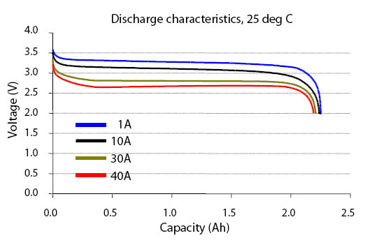

Be careful with those LiFes. They have a severe drop off characteristic and because of their flat discharge characteristic you can not determine where you are on its discharge from measuring its voltage. You will have to know the capacity you need and the capacity of the battery as you fly. Not many people know this who are using them. Use the NiMHs. Dan.

Dan, you are correct about not knowing when to recharge. I monitor my flights and batteries and charge them often. I probably charge too often.

Rich, you know what you're doing. Not many guys at my field do. Here's a good procedure to try to help you along. Balance charge your LiFe receiver pack or packs. Fly for an hour. Balance charge your receiver pack and write down the mah you consumed. Let's say it's 1000mah. That means that you drained your batteries at a constant rate of 1000ma for one hour. Of course there were peaks and minimums but the average was 1000ma. If you fly for one hour a day, double that for a safety factor of two. Your battery should have a minimum capacity of 2000mah. Does it? Dan.
