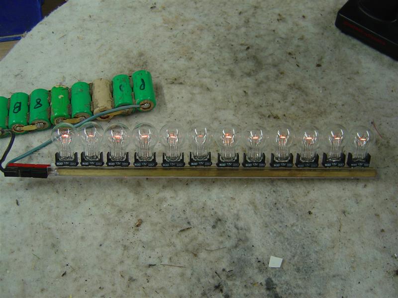

Here's a pic of my string of bulbs I put together with wire leads to plug into batteries. There's no low voltage cut-off and when the bulbs first start to dim (same as truck starting to slow) it should be unplugged. Dischargeing isn't recommended or nessecary because it can hurt the battery.

i have two 1500 nicd dtx batts would it still need to come off at first sight of dim? thanks

Yes, if you watch it you'll notice a very gradual dim throught the whole discharge and then at end it will "dump" as soon as you notice the "dump" is time to pull it off.
