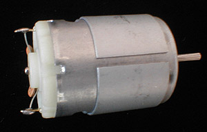

Jetts,
I really appreciate the time you are taking to answer all my ?'s
When I used to race electric cars, the motors were rated by turns. Motors of different turns could also pull a different amount of amps, depending on timing, and brush setup.
Are electric plane motors similar? I guess I'm scared of getting a "hot" motor that will toast my little esc!
I would like to find a nice bearing motor for my plane, that would be a little more efficient. The plane seems to have plenty of power for me right now, but the motor tends to get hot as ramavan has stated.
On your suggestion, I'm going to add some vents in the fuse, and (using very thin aluminum) bend a small heatsink that will fit the motor can.
I'm attaching a pic of the motor, is this anything like the graupner motor you spoke of? Do plane motors come in different winds?
Thanks again for the help!
Wayne

I'm not aware of different windings, and timings on plane motors, other than the fact that some are made for pushe, or geabox, usually with an R in the designation.
Heat sink is a good idea for any of them, and as far as I know the graupner motors are typically 380 Mabuchi motors with a metal endbell, bearing (plain and ball) they change the name to speed 400. I'm not an expert on electric motors, but if you get a graupner, speed 400, you will see a little improvement over what you have now. They also have the same screw pattern for mounting in a gearbox.
Tower or whoever you order from should give you a little more tech advice as far as that goes.

I doubt if the prop shaft will be an issue. It's pretty easy to adapt a prop anyhow. Most in this motor size are the same.
A GOOD speed 400 (Graupner) is less money. 8-9.99.
Yes, oil the pivot point on the folder, and ANY KIND of heat removal system will help the longevity of the motor.

ramovan, you can check the motors out here:
http://www.hobby-lobby.com/speed280.htm
I have been reading a bit, and from what I understand the standard speed 400 motor that Jetts recommended is probably the best one.
The 480 sized long, black can motor is supposedly a good choice, but it may require larger battery packs than we are running.
Same for the rocket 400, its listed as "7.2v" whereas our motors are probably 6v (giving more power on the 8.4v we are using).
There is also a speed 400 Race with Ball Bearings, but again its 7.2v.
I probably will drill some small 1/8" holes in flat sides of the nose. I think if I stay away from the corners, I won't loose much rigidity. I'm probably going to put a couple of 1/4"holes in the bottom rear of the fuse, and epoxy some small pieces of lightweight carbon arrows (6 grains per inch) with the arrow shaft pointing slightly down. I'm hoping to get a "venturi" effect, like in a carb to pull the air through the plane.
