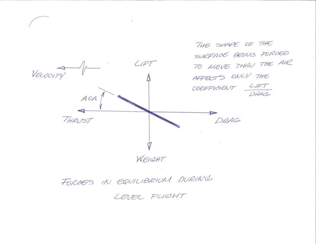

Just go watch a jet airliner on final approach. The angle of the fuselage will be high, yet the airplane is on a descending path towards the runway, due to the high AOA (angle of attack) of the wing required for the relative slow speed. The elevator of the machine may appear to be inline with the stab, but that is because the stab, in most machines is a slab, and trims to an AOA that holds the wing in the high AOA. No big secret.
There again starts another great conversation. There is no such thing as "Stall Speed" a concept often used which does not exist.
Think about that one for a while. [sm=confused.gif]
L (lift) equals the Coeficient of lift (angle-of-attack) times 1/2 (air-mass density times Velocity squared times wing area). Hasn't failed yet in subsonic/transsonic convergent airflow.

ORIGINAL: Hossfly
WRONG! The wing will fly at an angle-of-attack that it is forced into by the stab., if the pilot places the elevator in a position to do so. If the weight and airspeed are producing the proper lift for straight flight then lift equals gravity. A dragging tail will always be applying force against the wing to make it move somewhwere else.

This amazing website shows some animations that will explain these things better than I can:
http://www.geistware.com/rcmodeling/...mics/index.htm
The horizontal thrust force keeps the wing going thru the air.
The downthust adds to the weight that the wing has to sustain in the air while it subtracts from the horizontal force.
The airfoil shape of the wing transforms that movement into a force pointing up or lift.
Everything else (including the engine that generates the thrust) hangs from the wing or falls to the ground.
Have you ever seen a wing detaching from a model airplane in flight?
It cannot keep flying, it flips and rotates in the way down. Why?
Because a wing alone is non-stable.
The wing needs something far away from it that keeps it in a more or less horizontal position, so it can do its staff: transforming thrust into lift.
That something far way that keeps the wing in the position it needs to be is the stabilizer, which can be aft (tail), forward (canard) or built-in as reflex for a flying wing.
We change the lift (up or down) of that stabilizer at will (elevator up or down inputs).
Then, we induce a rotation in pitch around the CG.
The nose of the fuse points up or down and the AOA increase or decreases.
When the AOA increases, under our command, the wing transforms that thrust into more lift, at the expense of reducing the velocity of flight, and the plane goes up in a loop.
The opposite happens when we feed down elevator, the plane loops down and accelerates.
We can hear that engine changing rpm’s in both cases, because the wing is asking for more (when going up) or less (when going down) thrust and torque.

ORIGINAL: Lnewqban
Downthrust is a trick to eliminate or reduce nose up reactions each time the thrust force increases via throttle control.
The idea is to make the thrust line get close or coincide with the location of the CG and the center of drag in the airplane.
This pitch sensitivity to thrust changes is good for trainers and bad for aerobatics.

Hi, SeamusG
Any new amazing project of yours with Ultracote to share with us?
The center of drag is where the center of lift is (lift cannot exist without associated drag).
For practical thrust line determination, the CG can be used, since the horizontal distance between the CG and C of L is small (the pitch stability marging).
The wing's C of L moves along the airfoil with changes in AOA.
The closest we can get is by considering the total C of L of the wing, fuse and tail, which is named neutral point (NP).
Vertically, it should be very close to the line that joints both 1/4 chord points of wing and stab (the geometrical center of the lateral projection of the fuse has some effect on it).
Horizontally, it can be calculated here:
http://www.geistware.com/rcmodeling/cg_super_calc.htm
ORIGINAL: SeamusG
How do you determine the center of drag?
